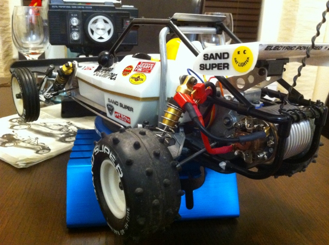

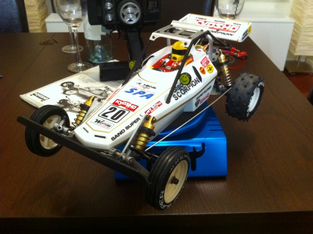

I am actually a bit about doing it period style.... the Turbo Scorpion did have a blast with the 240SB and the and Supers at Mitchell Park here in Adelaide about 5 or 6 weeks ago. It did put out a good show of speed, but there was unreliable control, probably because I was in such a rush to get it cooking on a track (for the first time since about 1990) that I neglected to solder the noise capacitors to the motor.
The car went up on blocks after that. The noise capacitors have been soldered now, the Sand Supers and original rims have been retired to shelf duties (replaced by 12" hex adaptors at the rear, Raider rims and vintage Proline rubber) and the chassis rails replaced by http://www.pargustore.com items because of the tree in the centre of the track and a silly moment! It's going to be back on the road in the next few days... hence me thinking about gear ratios etc.
I think I might work out the transmission ration of the Optima and Scorpion and use the chart from the Optima manual to work out which of the two 'kit' pinions to use in the TS with the same motors... and then look for an old CRP slotted motor plate to give me a bit more choice later.
It would still be great to get definitive knowledge of optimum gear ranges for the Le Mans motors though.
Here's the TS by the way:
