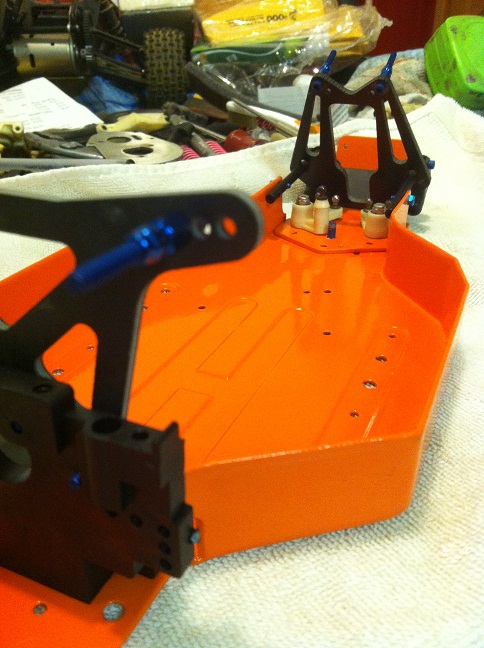

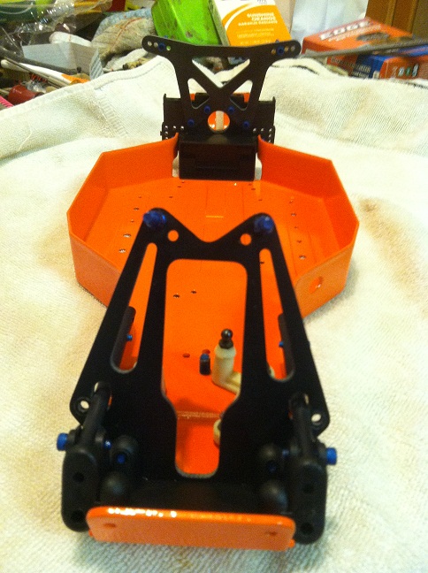

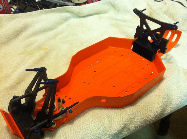

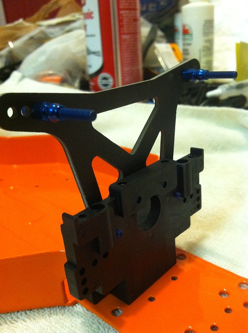

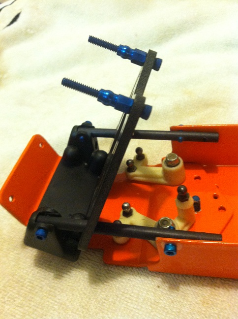

Well guys after weeks of collecting and waiting for parts
i have enough parts to officially start my Orange Racer
ya there is some parts that i still have to hunt down
the MIP change box is work in progress
but i will make it work
once again this will be no shelf queen
its going to be a runner
so here we go
enjoy farmer
ya i know the shock screws are long
ill cut them later
so here we go
enjoy farmer
ill cut them later
Re: FARMERS Official ORANGE RACER Build Thread
i am really liking the way that this build is going. Is the chaissis powdercoated or painted?
Keep going and post progress!
Who makes the aluminum(?) upper shock pivots that you have on the front and rear tower?
- Posts: 16816
- Has thanked: 36 times
- Been thanked: 1318 times
- Posts: 553
- Joined: Mon Mar 19, 2012 9:06 pm
- Location: Bakersfield, CA
Ya its paint
multiple primer coats sand coat sand coat repeat to fill im blemishes
same with paint, but no wet sand till the last coat
than about 3 coats of auto clear
thx farmer
I couldn't figure figure for the life of me how to get the shock away from the tower without using multiple washers or bore washers. and as it turns out - all along while I was searching for "shock mount", "shock pivot", "shock anything!".scr8p wrote:associated
Shock STANDOFF!
thank you scr8p!
& farmer for posting detailed pics!
jb
