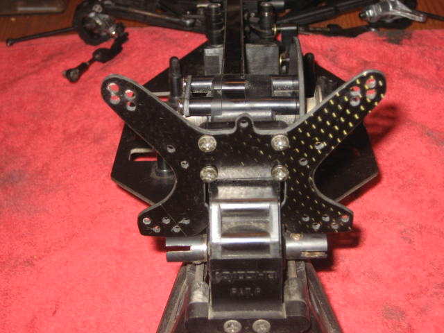

Started today to build up my old lazer zx car.
Some parts where made today and here is some pics of it.
Even the wing stay will be in carbon.
If any parts intrest you send me an pm so I can tell you the price if the part.
Jerzi

Sorry for noob question, but how are you cutting the parts? Dremel, cnc? Do you just trace og parts.

GotXjaG wrote:Sorry for noob question, but how are you cutting the parts? Dremel, cnc? Do you just trace og parts.
Dremel with diffrent tools.

Fibre lyte do all and more already, including all upgrades that make this car much better. Youll find the servo mount plate awkward to fit so when i did mine i used B4 servo posts and used a small nut to hold the scew in place so it stayed seated in the chassis, otherwise you wont be able to fit it.
Ive already done a cf front and very rear pivot block, did the other two but its a pain drilling holes through the grain and not easy getting it correct first time. Mind you if you do those two (fibrelyte sell them minus holes for chassis connecting) let me know as im doing a totally cf car, rear gearbox has been done already.
Still im intreaged in the cf wing mount, show me that please.
