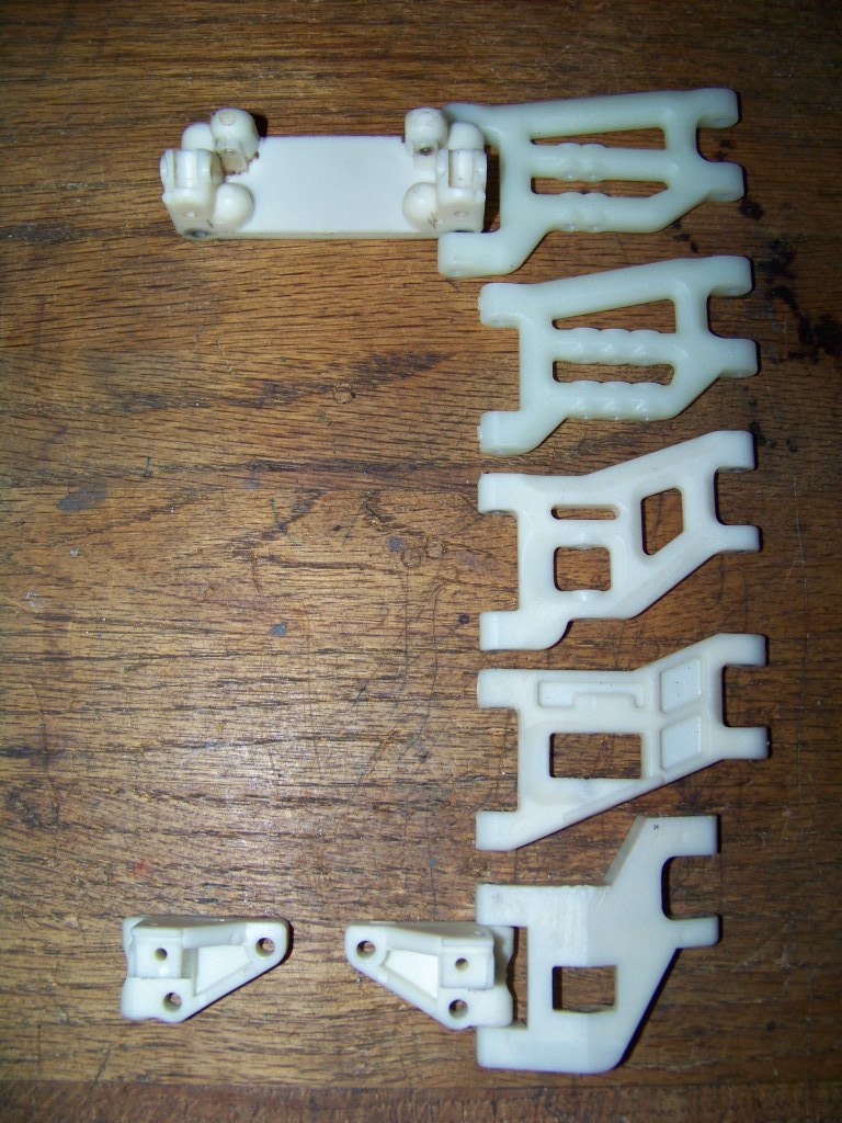

One easy way to tell is that RPM Team Arms have 3 shock mount holes, while RPM Worlds Arms only have 2....even though they're longer.
RPM Team Arms are the same size as stock AE wide arms.

Picture worth 1000 words...
Bottom to top,
AE "short" Arm
AE (CE/Worlds Car) arm
Andy's Wide Arm
RPM "Team Car"
(all the above are generally used with std nose plate)
RPM "Worlds" arm (generally used with a 10T nose)
Jeepz or Dynotech Arms (not shown, but modern production of the RPM "Worlds" arm)
Jeepz SCR8P Special Edition (not shown..only rumored to exist at this point
(edited). Even use a combination of two different ones if you plan on only turning left
Bottom to top,
AE "short" Arm
Andy's Wide Arm
RPM "Team Car"

Sort of, Al.....the dynotech/bigjeepz/rpm worlds arms are wider at the front bulkhead, so they aren't exactly interchangeable.
But that is an AWESOME picture. We should put 'em in the '25 yr' or 'old is new' tech thread for convenience, especially since this is an often asked question.

Also RPM and Dynotech arms are the same length, but bigjeepz arms are longer to correct for the B4 wheel offset without the need of GT axles or B4 caster blocks.

Right on. Forgot about that (actually critical) little detail. I had them all laying around so I though I might as well take a pic to clear it all up for some folks.jwscab wrote:Sort of, Al.....the dynotech/bigjeepz/rpm worlds arms are wider at the front bulkhead, so they aren't exactly interchangeable....

you can also add the rpm "truck" arms to the list. they're longer than the team arms, but shorter than the worlds arms, and mount directly to the "buggy" arm mounts.
then there's the andy's pro race arms that are the same length as the worlds/dynotech arms, but mount to "buggy" arm mounts or the narrow andy's bulkhead.

Y'ernat Al wrote:Picture worth 1000 words...
Bottom to top,
AE "short" Arm
Andy's Wide Arm
RPM "Team Car"
Jeepz SCR8P Special Edition (not shown..only rumored to exist at this point)
(edited). Even use a combination of two different ones if you plan on only turning left.
OK, now I know what I'm running. lol
