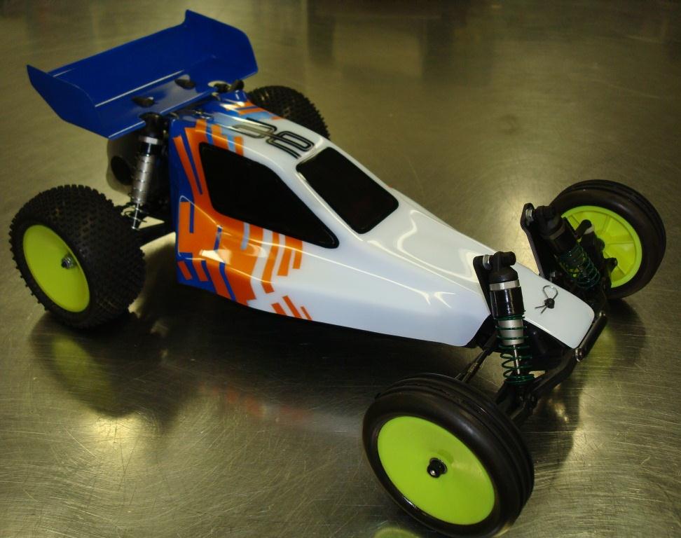

"Old is new" RC10 buggy.
A&L Interceptor body.
Currently for sale on Fleabay.
http://www.ebay.com/itm/140813755328?ssPageName=STRK:MESELX:IT&_trksid=p3984.m1555.l2649

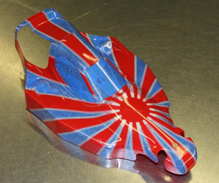

Re: BGRC paint shop...
Hi Brandon,Brandon G wrote:James' Team car.
What color is red/maroon looking color on this body?
Thanks,
Quik
Quik's For Sale thread: http://www.rc10talk.com/viewtopic.php?f=6&t=27849
Wanted: http://www.rc10talk.com/viewtopic.php?f=56&t=27525
Feedback: http://www.rc10talk.com/viewtopic.php?f=50&t=26636
- Brandon G
- Posts: 2106
- Location: Nashville, TN
- Been thanked: 3 times
It was shadowed first with black faskolor with airbrush. Shot 4 light coats Pactra Candy Red and backed it with Pactra Indy Silver, both rattle can.
