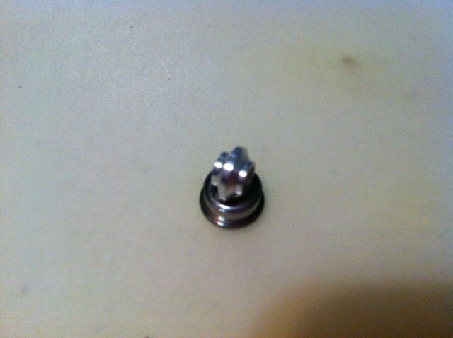

What is the benefit of using this BRP bearing crush sleeve? How does it effect the performance of a pan car?

The crush sleeve is used to prevent getting preload on the bearings by allowing the race to be the only part of the bearing coming into contact with the nut or whatever the tightening method is. This allows the ball bearings to rotate freely without any preload as I mentioned before which means less friction.
Also prervents sideload during cornering which would cause more pressure and friction on the ball bearings, the bearing turns freely even while cornering.
