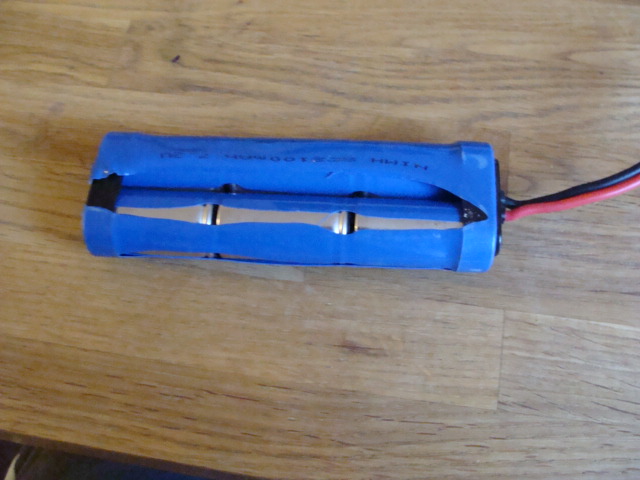

Side note look what my Novak Ionic peak charger just did to a 2100nimh in just under 20 min set at 4amps
so hot i almost burned myself .... think its still good???
well luckily it was not new
Tom
Re: Charging newer batteries
Ok my stupid self had it on 7 cell
didn't have my reading glasses on, and the charger goes to 8 cells wasn't paying attention plus old mind set of just 6 or 7 cell.
On a positive note the other 2100 used pack that i charged on the millennium pro charger shows 1300 mAh and that ran pretty good with a vintage trinity Monster stock motor, i was cold by the time it was loosing power.
