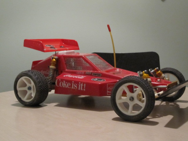

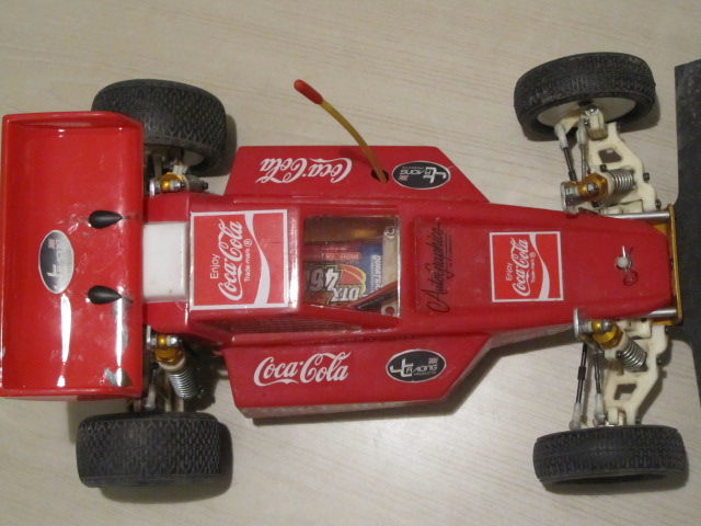

I have a Cadillac circa 1984 that I used to race back in the day while my dad raced an Optima Mid.
We raced for a few years and collected some trophies and had a lot of fun.
It was well used as can be seen in the pics.
I finally got it running again and now it's time to decide what to do with it.

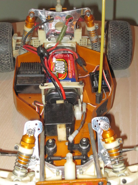

To get it running again here is what i did.
Complete dis-assembly and cleaning (maybe not as clean as it should be)
Rebuilt shocks
Rebuilt tranny
New aluminum shock towers
New speedgems ruby motor (19t I think?)
new 4600 mah NIMH batteries
JC Racing wheels with JConcepts bar codes
2.4ghz transmitter/receiver

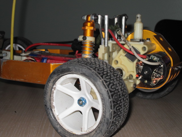

I really can't gauge how competitive this setup would be today. I am considering going to a brushless setup but I am very confused as to what I need to do to get there. For every post that says I can use the 6 gear tranny there is another one that says no. I am also having a hard time figuring out what speed motor to get...9T, 10T, 13T...3000kv, 3900kv, 4300kv and on and on.

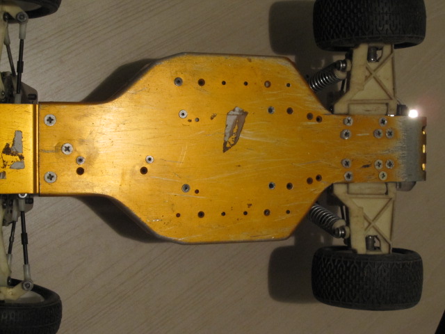

Given the condition of the car I don't mind making modifications, although I'm not into machining parts to get them to work. They must be bolt on and at the very worst simply drilling holes in the chassis.
