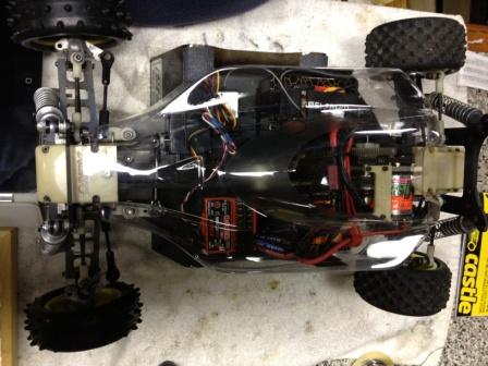

Any idea mow many 870c's were imported to the states with the all Japanese instruction manual (good thing they took lots of pics
)? I bought mine from the owner of a hobby shop in Ohio in 1989 and believe he got it from his Associated sales rep at the time.
Recently I have been running it with a lipo/brushless set-up and having a blast but trying to decide if restoring it is the way to go from here since I have recently acquired a yz10 that will be a runner. I hate to put such a capable steed to pasture, but I may find as much satisfaction running a yz10 without the fear factor of destroying a really rare bird...you thoughts are welcome.

Re: 870c vs yz10
here are some pics of the alloy shock collars, the shock internals were different between 870c and yz10 and so was the way the shocks were mounted, rubber as opposed to nylon. Out drives were also different 870c having brass tube which kept the bearings in the bulkheads, yz10 did not. Got a mean hangover and that's all I can remember chaps

[quote="GJW"]here are some pics of the alloy shock collars, the shock internals were different between 870c and yz10 and so was the way the shocks were mounted, rubber as opposed to nylon. Out drives were also different 870c having brass tube which kept the bearings in the bulkheads, yz10 did not. Got a mean hangover and that's all I can remember chaps
That's perfect, thanks. Alloy collars stay on the resto....I noticed som of my rubber hock mounts are shot, those will be impossible to find I imagine

Re: 870c vs yz10
that's ok glad i could help a little. the only place i've seen the alloy collars is in the gold rear long body shocks nip, so keep an eye out for gold shocks with a yokomo header card. as for the rubber bushings there must be a very close match out there, take a picture and put it hereOldSkoolRC wrote:GJW wrote:here are some pics of the alloy shock collars, the shock internals were different between 870c and yz10 and so was the way the shocks were mounted, rubber as opposed to nylon. Out drives were also different 870c having brass tube which kept the bearings in the bulkheads, yz10 did not. Got a mean hangover and that's all I can remember chaps
