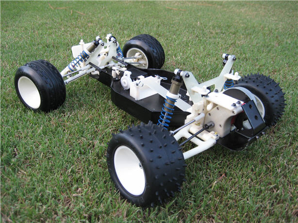

Here's my old truck all cleaned up in its final as-raced configuration. It has the B tub with both offset and inline battery box holes. Oh, there were some chassis differences, too. Right, Reggie? :wink:

Yup :lol: Early B stamp/Black A stamp chassis on the left, Later B stamp on the right-(Kinwald screws set into the battery holes for a better example)
