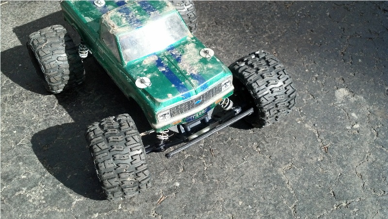

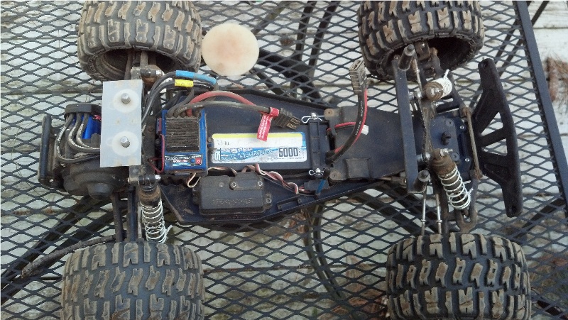

It’s been a little while since I posted, but I have been busy with the truck.
I dyed it black. I think it looks a lot better.
The truck:
.RPM gearbox
.RPM Electric Rustler rear A arms
.RPM Electric Rustler front A arms (drilled for nitro Rustler/SRT caster blocks)
.RPM front bumper
.VXL rear camber links
.XL5-spec front camber and toe turnbuckles
.Slash 4x4 rear driveshafts
.Traxxas 1.5 degree aluminum hub carriers
.Nitro Rustler front spindles (25 degree casters)
.SRT Fiberglass front shock tower
.STRC hinge pins
.Sealed stock differential, filled with red grease
.Avid rubber sealed bearings throughout (including the steering bellcrank)
.Traxxas aluminum wheel hexes in the rear (I got these when I was a noob)
.Velineon system
.Flysky FS-gt3b radio
.2075 servo
I’ve been working on getting the understeer dialed out. I moved the front shocks to the inner hole, huge difference. I put 30wt shock fluid in the front and 40 in the rear. I previously had 45 all around. This didn’t do much for understeer, but it did improve bump control (which was already very good.) I added a lot of toe out and widened the front track slightly by putting a spacer on before the wheel. I decreased the negative camber in the rear and added more to the front.
I also did some slight modding to the rear shock tower to improve clearance between the camber link screws and the driveshafts.
I have noticed a strange noise from the drivetrain, it sounds slightly gritty. The noise is only noticeable when I turn the wheels. The truck sounds fine being driven. I made sure to clean all the gears and apply plenty of grease when I last assembled the transmission. So far, there’s no binding whatsoever and the noise really isn’t that bad, so I’m going to leave well enough alone.
I think the next step to eliminating understeer is new tires, and maybe some weight on the front (or off the back?)
At this point, though, the understeer is mostly dialed out. The biggest problem with the truck is that it feels clunky and cumbersome. It feels large. When I drive it around the track, I feel like I’m manhandling it, forcing it to do things it would really rather not. It plows when I expect oversteer, it spins out when I’m trying to make it turn in.
I’m still trying to find a way to mount the ESC on the side of the chassis.
