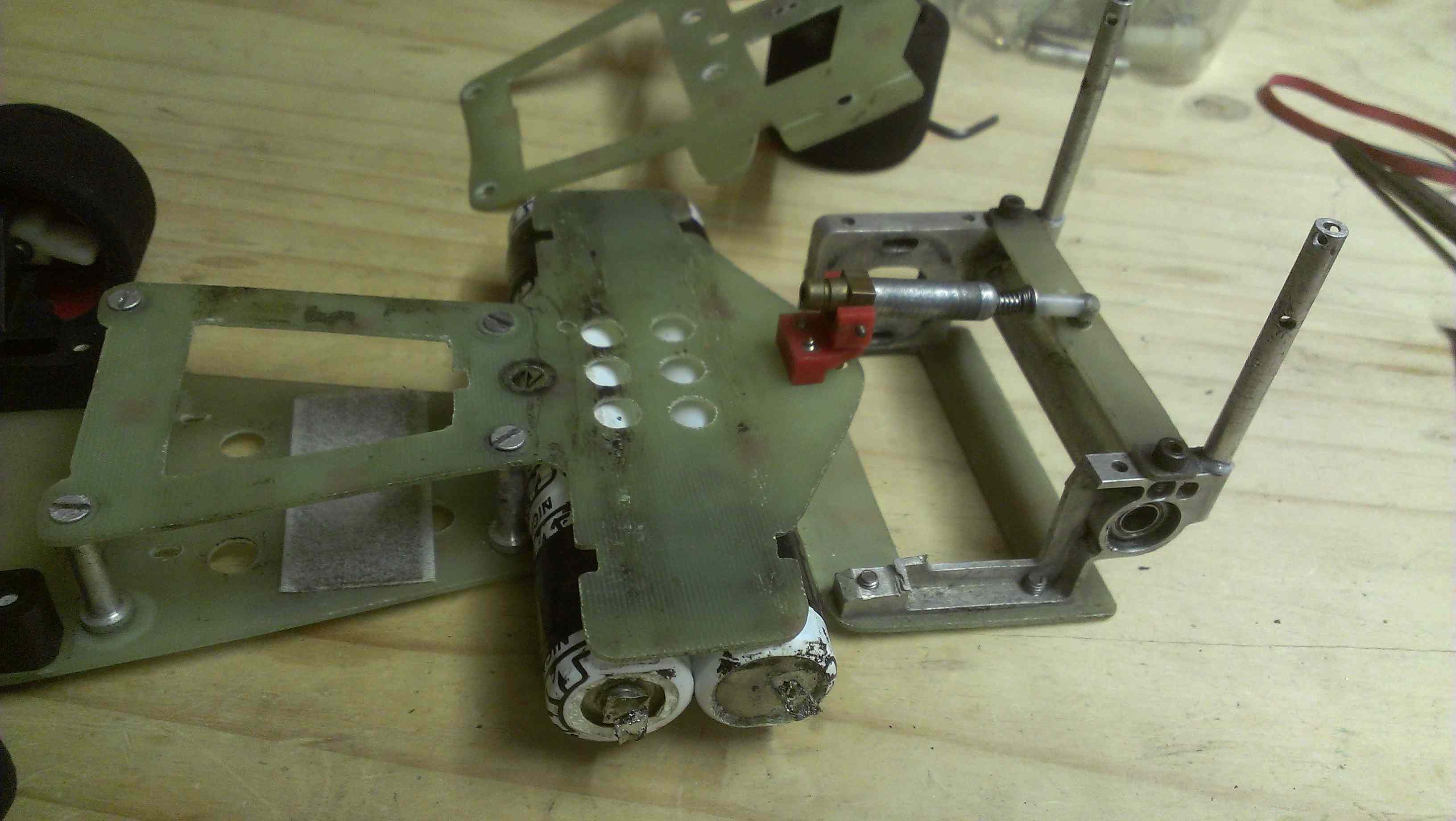

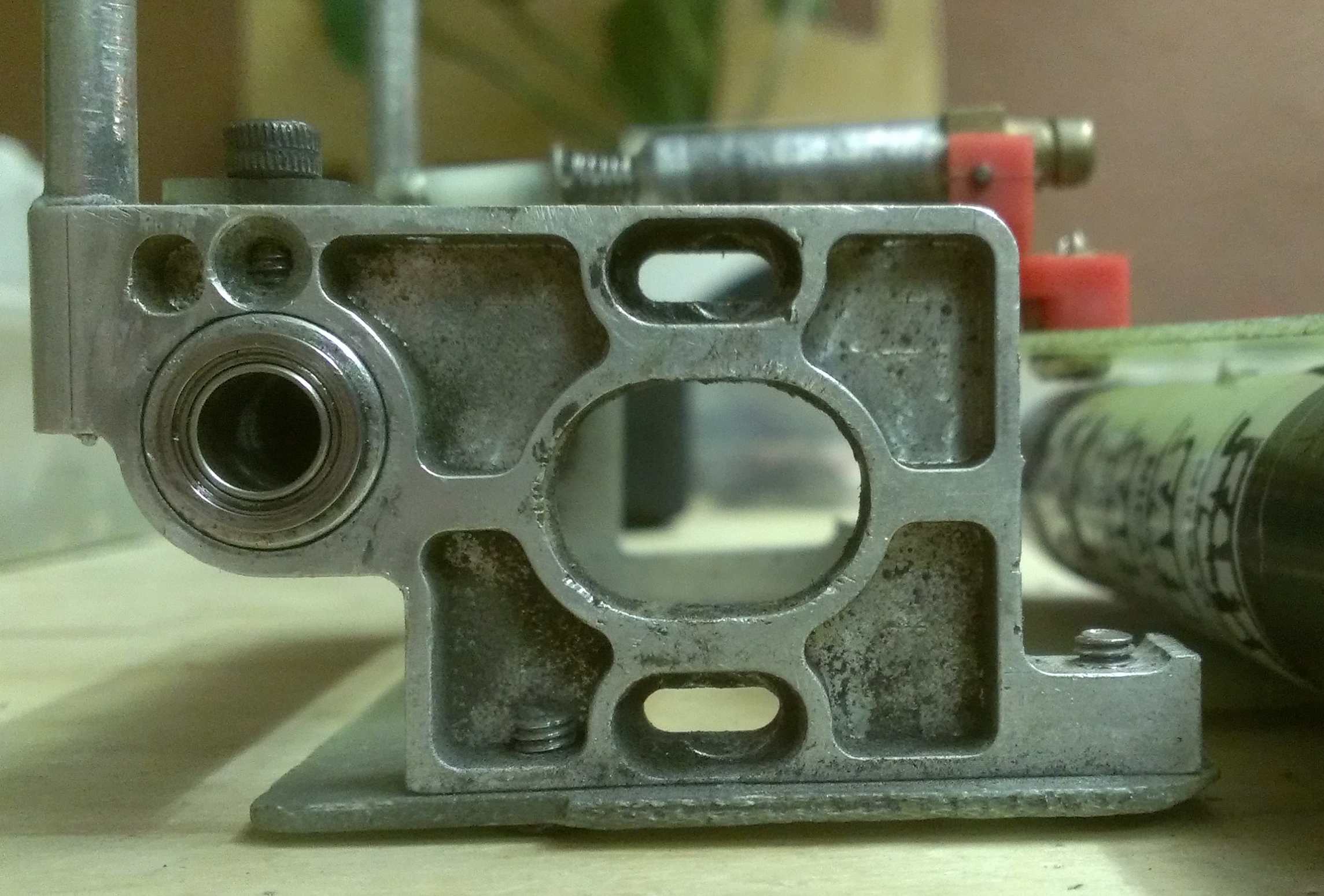

Thought Terry SC would like to see this close up....
Anyone any thoughts on what this would have been based on..?

That definately has a whiff of home built about it, it's almost as if someone was trying to base it on the Demon MF1, in fact it looks like the rear shock and red plastic mount are from a Demon MF1.
Paul.

Rear shock and mount are from the Demon car for sure.

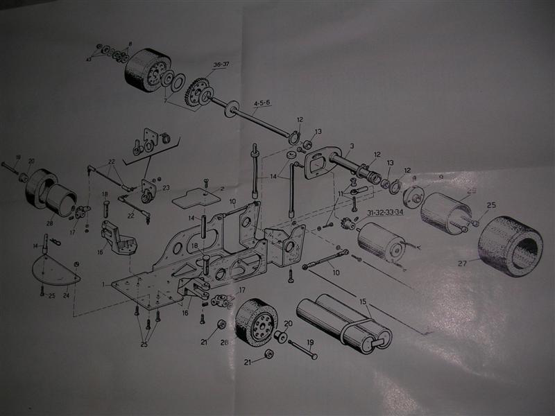

This is the axle tube I had in mind: part nr 3 in the drawing.
The car in the drawing is a Gemini SLX by the company S.G. .

Not really, this is what a lot of people think but it´s not 100% true. The original Gemini SLX is a British car, later this design was sold to SG. Both versions are not exactly the same, several small differences. The curious thing is, the drawing was also sold with the SG kit but showing actually the original car. More informations here http://classicrc.wordpress.com/1-12/gemini/gemini-slx/

If I understood the text on the german rc-museum site correctly; Greeno was the SG team driver in the UK

True and not, also that museum has the SG car, not the real Gemini car. In the beginning Greeno was a PB driver, later he did sign with SG. That´s also when he sold the SLX design and all production stuff to SG. There are two versions of the SLX, the original version of Greeno himself and the newer version then sold by SG. The SG version has a lot of small changes, if you are not used to these cars both will look very similar but in reality very few parts are 100% the same. Currently you will find the SG version at my website, later there will be also the original version with closeups so you can see the differences.

Those rear blocks definitely look like a production item, the better view helps. Material used would point to one of the Japanese manufacturers, but the blocks match nothing I know of. The axle tube is an addition though, there is a countersink screw hole above for a cross tube brace and the axle tube has been added to adapt it to fit standard axle bearings rather than the larger original bearings.
Rear shock and mount is from a Demon MF-1. Top deck mounts are Schumacher C-car posts. Front end being in black is likely to be the Schumacher version of Associated arms, they were machined on the bottom for more caster then dyed black.
