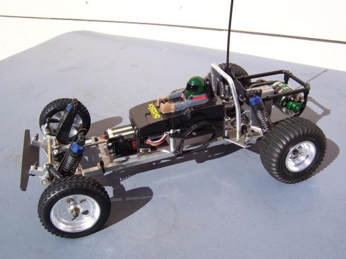

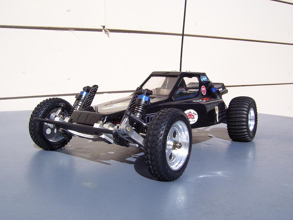

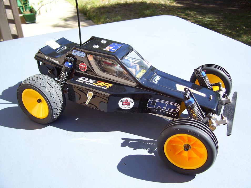

I've just finished rebuilding my Tomahawk over the last year and a half. Major features are machined chassis rails and front axle clamps, Kyosho mini Inferno shocks front and rear, CRP wide front axle and counter gear, Thorp diff and handmade shock towers and radio plate. The wheels are Pargu's. It also has hex rear wheel adaptors for modern wheels. This ones a runner. Enjoy the photos and feel free to ask any questions, Chris.

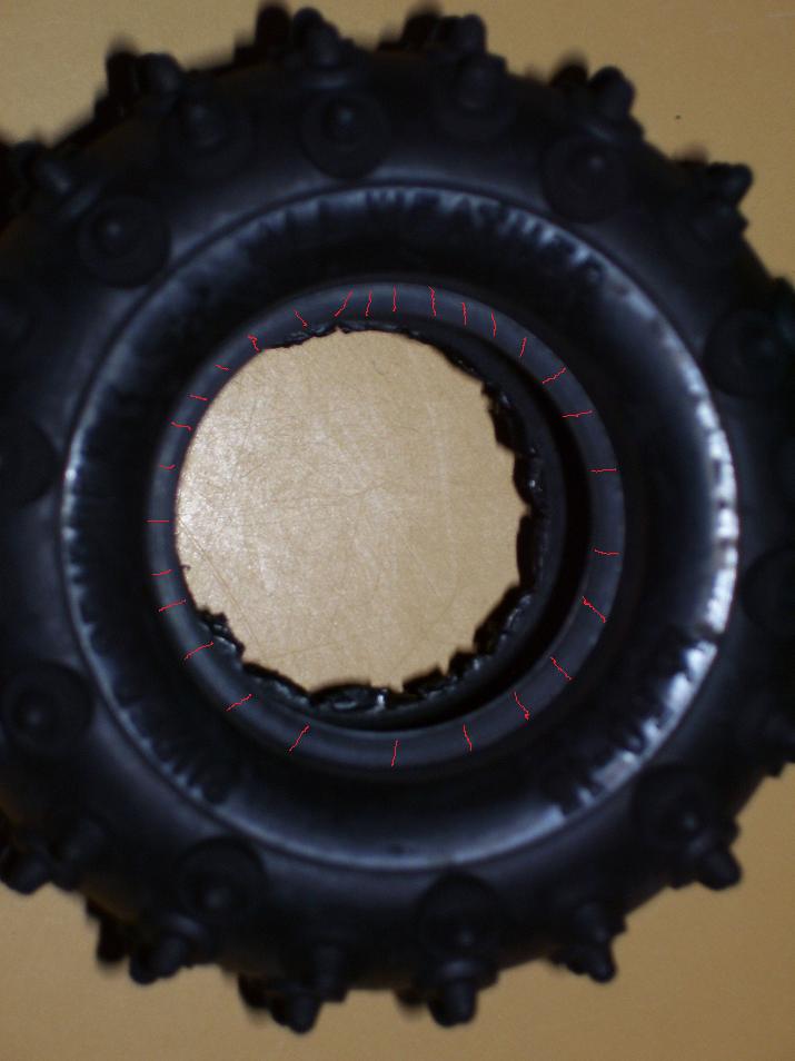

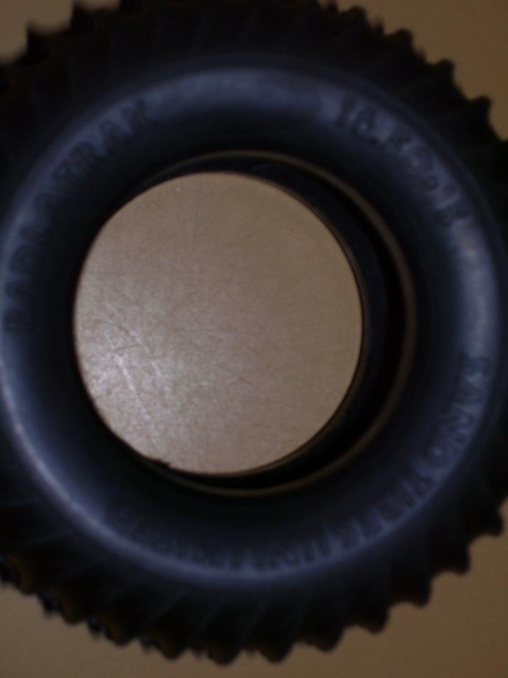

Thanks fellas. These are my favourite Kyosho buggies. I first saw an ad for the Tomahawk in 1985 and knew I had to have one. Ron, Tamiya Padlatraks and Super Grippers are 1.5 inch inner diameter just like the Kyosho rear tyres. The Tamiya tyres have an inner ring of rubber which has to be removed from both sides of each tyre to use them though. Check out the photos to see what I mean. The red shaded area in the first photo is what needs to be cut off on both sides. The second photo shows the end result. I used a good pair of scissors to cut the excess rubber off. I also used Tamiya ball diff grease on each sidewall to help get the two wheel halves together. The Tamiya tyres are a bit harder to get on, but they do fit. Chris.
