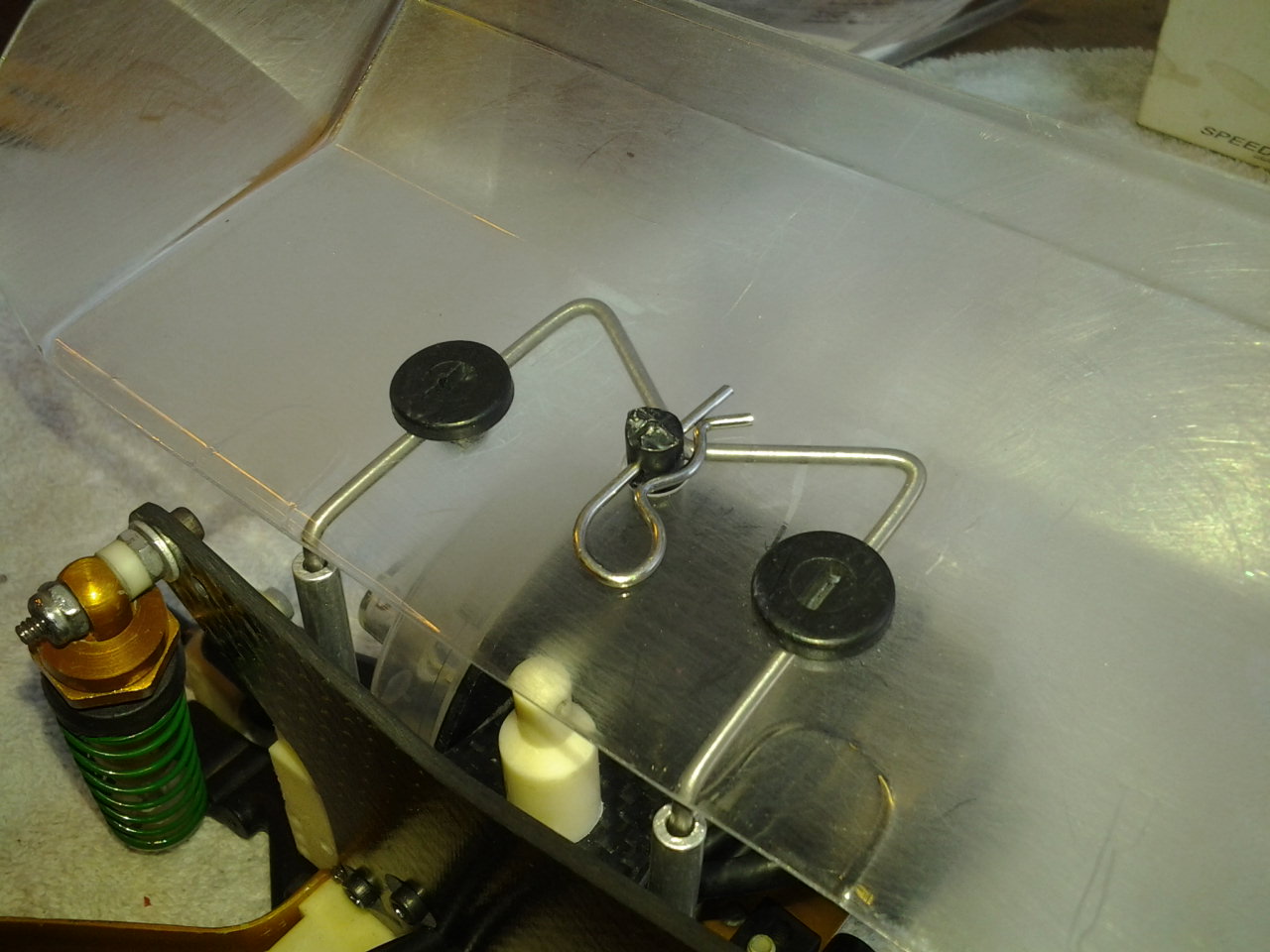

I put an front bodypist from an tamiya tc car to the rear brace and it go through the wing and then close it whit an bodyclip.
Now it wont come loose the wing.
Jerzi
Jerzi

After all these years that we have had problem with loosen wings but not any more.
Jerzi

Re: very simple very good modification
i use to put a couple of small bends in the wire that fits the tubes and it would fit snug .. i think ive only lost 1 wing while racing .. boy did it suck
Neat Idea!
I've had that same problem over the years. bending the wire didn't help. I finally ended up getting some kyosho rear wing mount and it mounts B4-style. I left the body mount and simply cut the back of the body off and left it there, heavy duty velcro for the body.
I did the wing wire bend, helps a bit but honestly I went for the el cheapo solution and just use some clear tape on the top when I go out driving. I do have some B4 wing mounts and a rear shock tower from RC Carbon Works but too lazy to do all that work
But your idea is a very clean and elegant solution!
