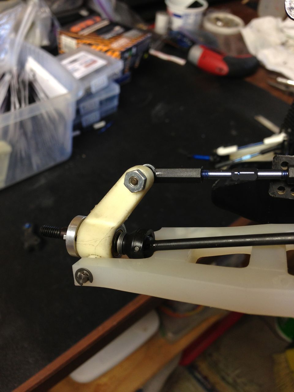

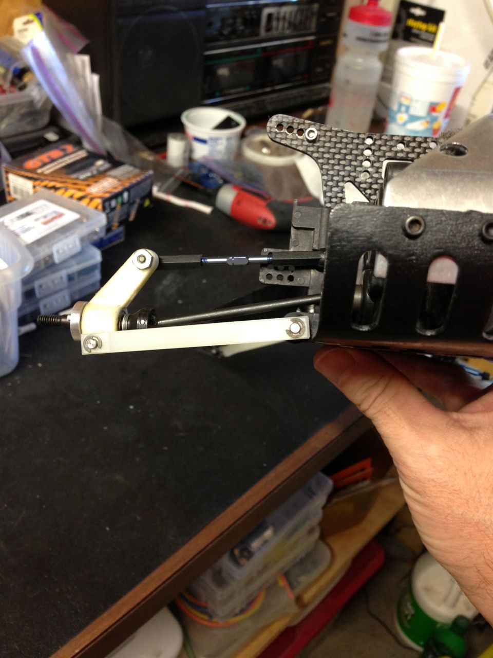

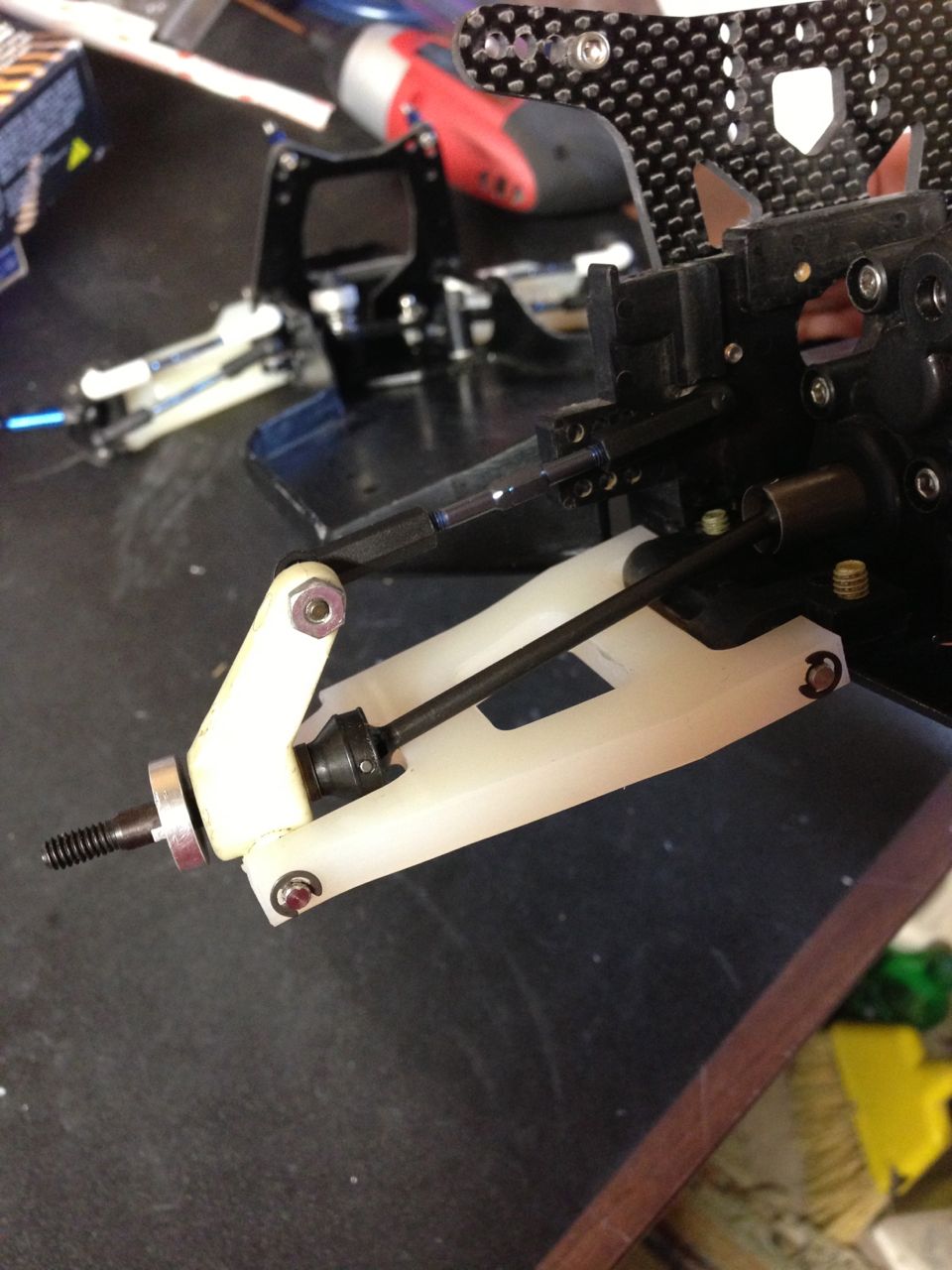

Finally was able to take some time and take a few photos. Please take a look and let me know your thoughts about what I might be missing here.
This is all of the droop that I get. The CVD bone is resting on the rear arm. And there are a lot of spacers in the CVD behind the axle and hub. Something just is not working here.
Thanks for the feedback thus far.

rpm 70272, losi 2038, or custom works 3241. those are your options.
