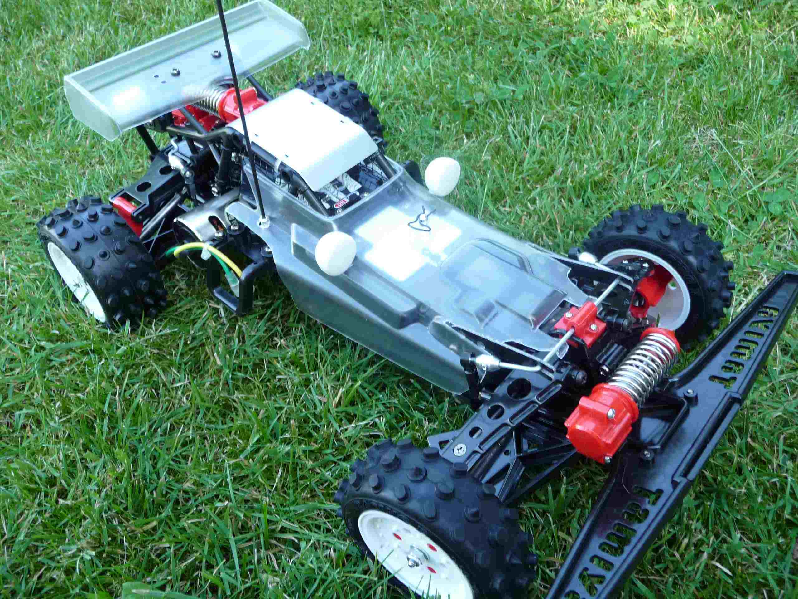

slotcarrod
Posts: 4415
Been thanked: 45 times
Re: Hot Shot Tips ?
Post by slotcarrod »
Been a while and I just uploaded old pics from my phone! Got this done finally a few months ago while sitting at my sons race! Good time to work on stuff between races!
MY work center in the trailer!
All done and posing with my sons race bike!
