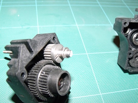

Time for an update on the build. Having received the four out-drive bearings, the gearbox can be finished.... :D
Standard LRM gearbox w/ A-3120 slipper shaft.
Losi Jr.2 Update 004.JPG (120.81 KiB) Viewed 1992 times

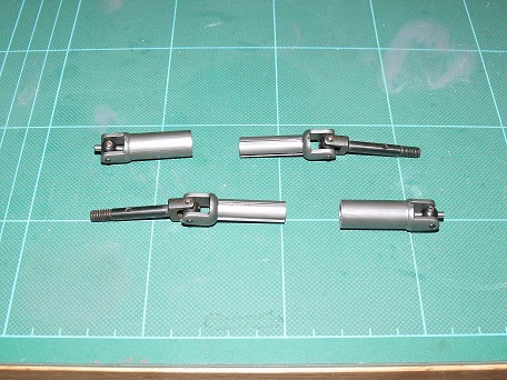

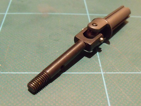

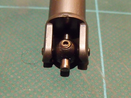

I decided to use the XXX rebuildable Universal Bearing Cross, part # A-3027 because I hate pliers..... :x ....and besides, they're much easier to work with.
Slider drive shafts.
Losi Jr.2 Update 029.JPG (114.91 KiB) Viewed 1990 times
Up close...
Losi Jr.2 Update 031.JPG (102.15 KiB) Viewed 1990 times
Up close...
Up close...
Later all black axles.
Losi Jr.2 Update 034.JPG (94.92 KiB) Viewed 1990 times

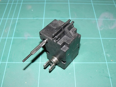

Fitting the female halves of the slider shaft to the out-drives.
Fitting the female half to the out-drive.
Losi Jr.2 Update 035.JPG (104.03 KiB) Viewed 1990 times

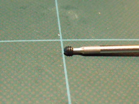

Using a little thread-lock on the set-screw......remember, a little goes a long way!
Thread-lock the set-screw.
Losi Jr.2 Update 036.JPG (98.39 KiB) Viewed 1990 times

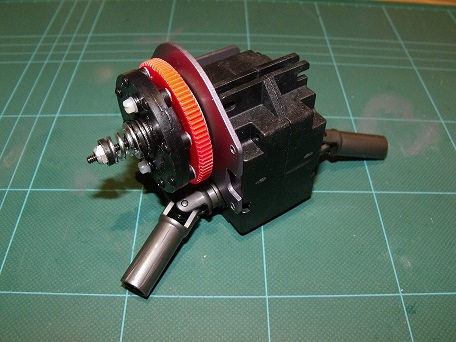

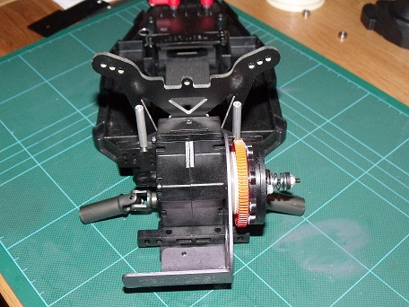

One LRM gearbox ready for installation.
All done.
Losi Jr.2 Update 040.JPG (103.24 KiB) Viewed 1990 times
All done.
All done.
In it goes!
Losi Jr.2 Update 043.JPG (117.26 KiB) Viewed 1990 times
In it goes!

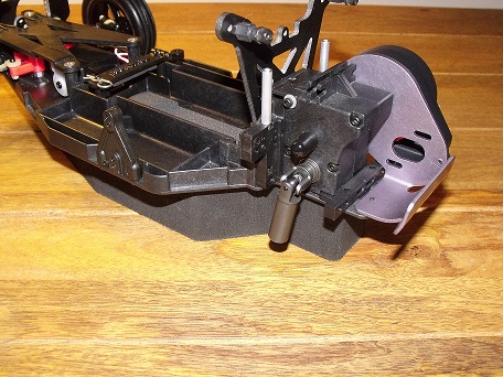

Sorry, almost forgot.....regarding the steering arms, yes the ones that I have, have a recess to accommodate a flange - hence my reason for using them. If you're interested, here's a link to the bearings that I used:
http://www.ebay.co.uk/itm/3-16x5-16-x1-8F-Metal-Shield-Flange-Ball-Bearings-/321093474995?pt=Radio_Control_Parts_Accessories&hash=item4ac2a99ab3
LosiXXkid
Posts: 757
Re: NIB Losi Jr. 2 (New build)
Post by LosiXXkid »

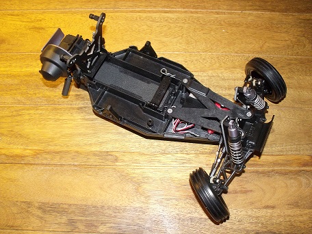

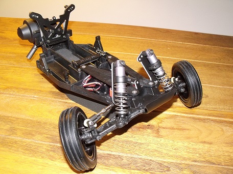

Well, it's time for an update.
Here's where the project sits right now. Front shocks have been installed (dry at this point) as have the front tie-rods and camber links using some Lunsford Titanium turn-buckles and RPM short ball cups. RPM HD side bulkheads have been fitted in the hope that I can get to finish off the 5-Link rear suspension and finally the hard-to-find RPM Hydra-Drive gear cover has also been installed.
I'm also on the lookout for the RPM chassis brace as this has a much nicer look to it (IMO).
Progress so far...
Losi Jr.2 Update 001c.jpg (124.91 KiB) Viewed 1888 times
Progress so far...
Progress so far...
Front shocks installed (dry at this point) with RPM Losi top shock mounts courtesy of eBay.
Losi Jr.2 Update 002c.jpg (121.57 KiB) Viewed 1888 times

The rear H-arms have been assembled but at this point I'm still not quite sure which way to go. I would love to go 5-Link but the absence of part # A-5010 puts me off as I don't want to have the Jr. sat around unfinished waiting for the lower rear shock mounts to appear.....I guess I can but live in hope! :mrgreen:

H-Arms ready to go...
Losi Jr.2 Update 013c.jpg (116.62 KiB) Viewed 1888 times

Axle close up showing the use of XX part # A-9941...
Losi Jr.2 Update 015c.jpg (121.98 KiB) Viewed 1888 times
