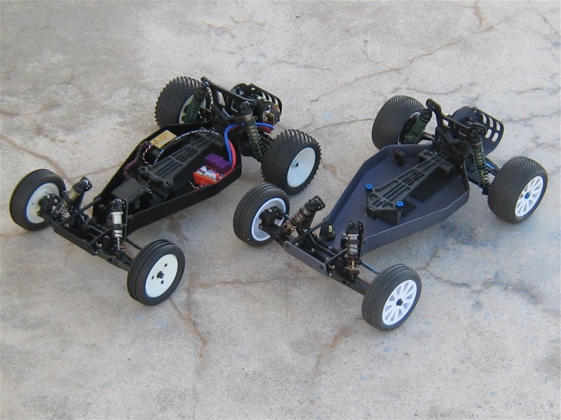

Did you make the shock towers?

Copied the rear and made the front. I just used a stock tower as a template and narrowed it up

That thing is awsome i guess im gonna have to pick up another t2 to do one if these out of! Did you shorten the wheelbase of yours like scr8p did? I didnt realise the pan was longer... I know there is a longer mount hole if truck form but i figured the standard holes were regular rc10 length...

I didn't shorten mine but I should have. It was sold before I ever ran it

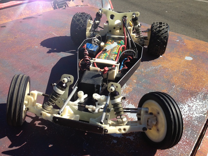

They all look good, I have one up on the planning block myself somewhat different insired then those. It is basically going to end up a white nylon team car with t2 pan, this is the mock up pic of it before I sent out the tub to be reano'd. There is much left to get before it's done though.

Did you redrill the pan to use the older style stealth? Or you come up with a diffrent style trans brace? My biggest thing i was thinking would be cool is the use of a more modern 2.6 ratio transmissions that the t2 had to offer
