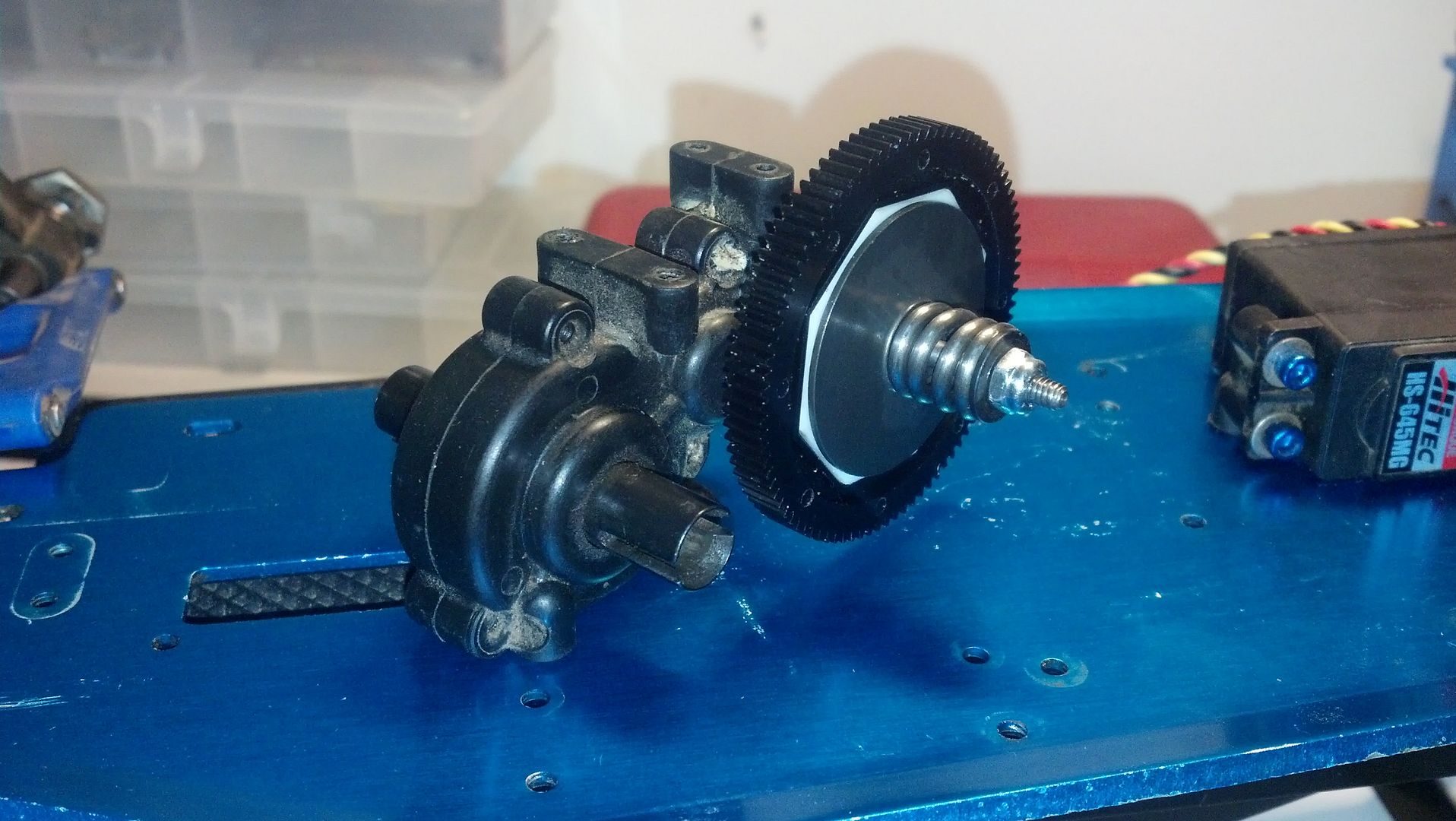

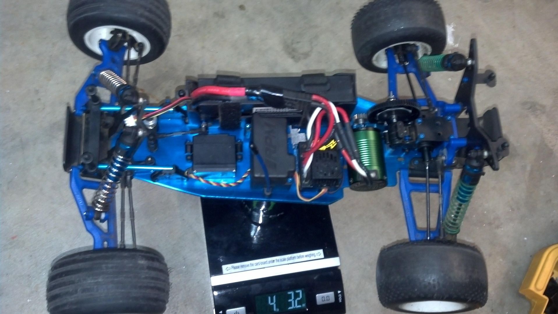

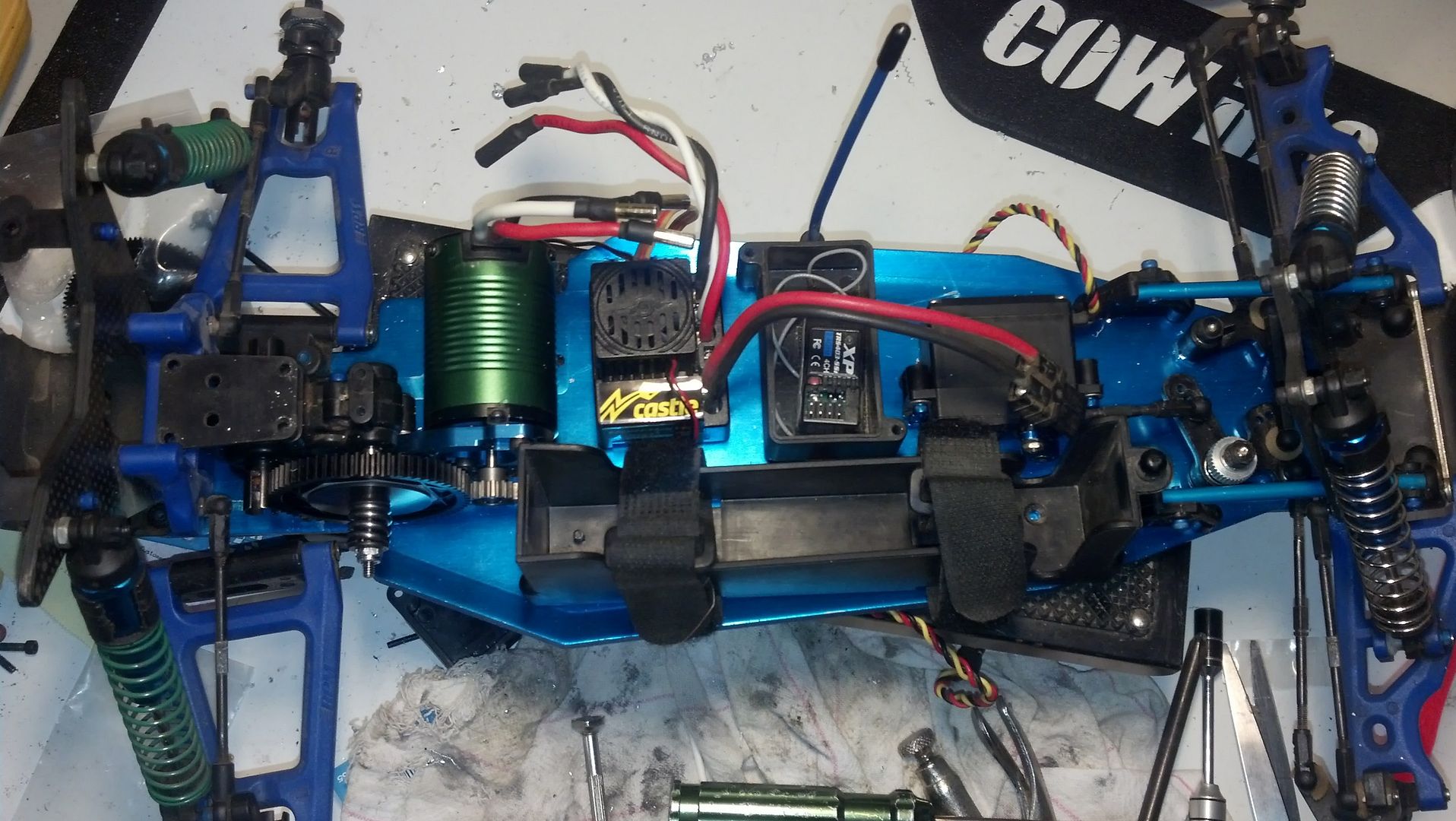

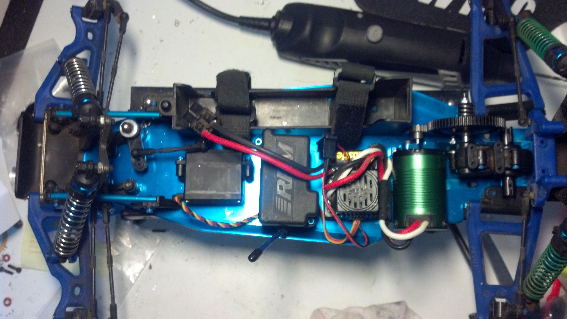

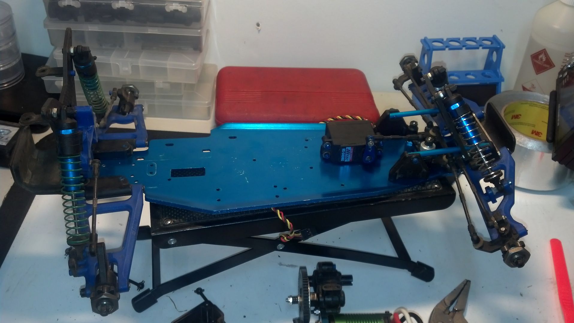

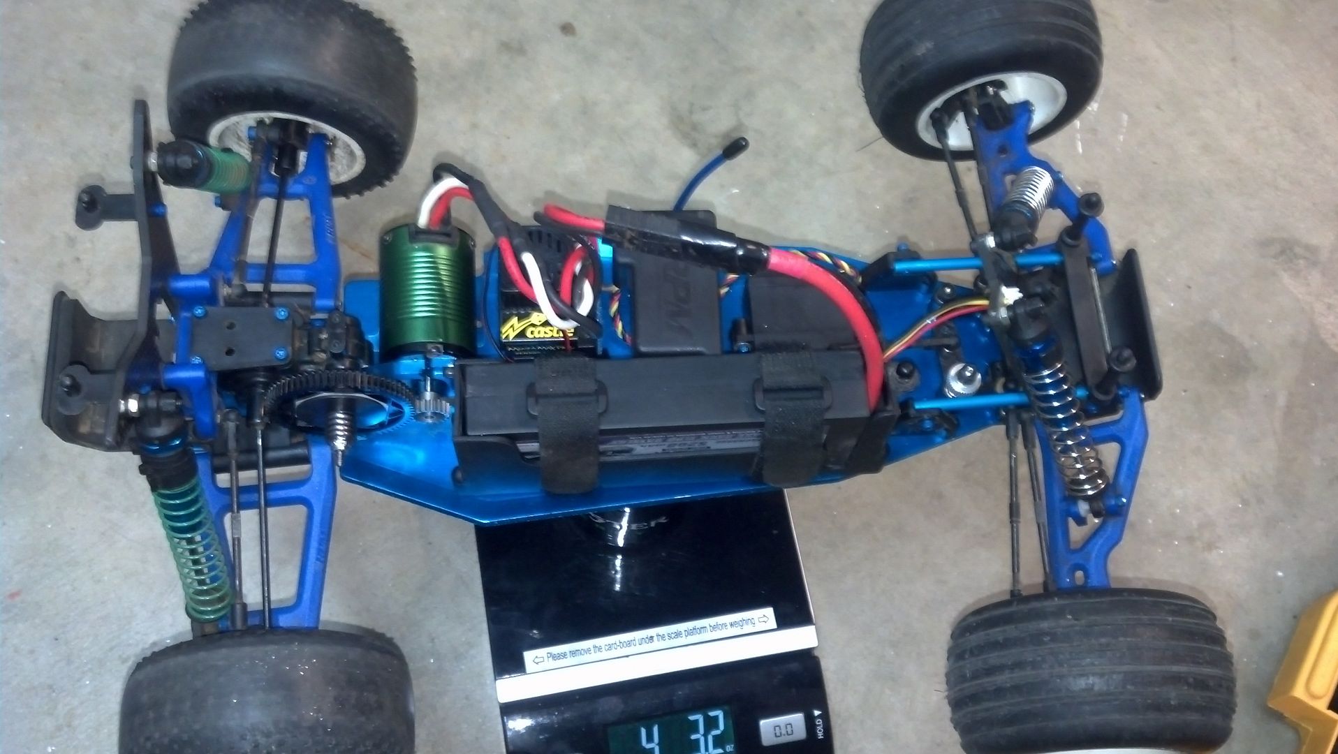

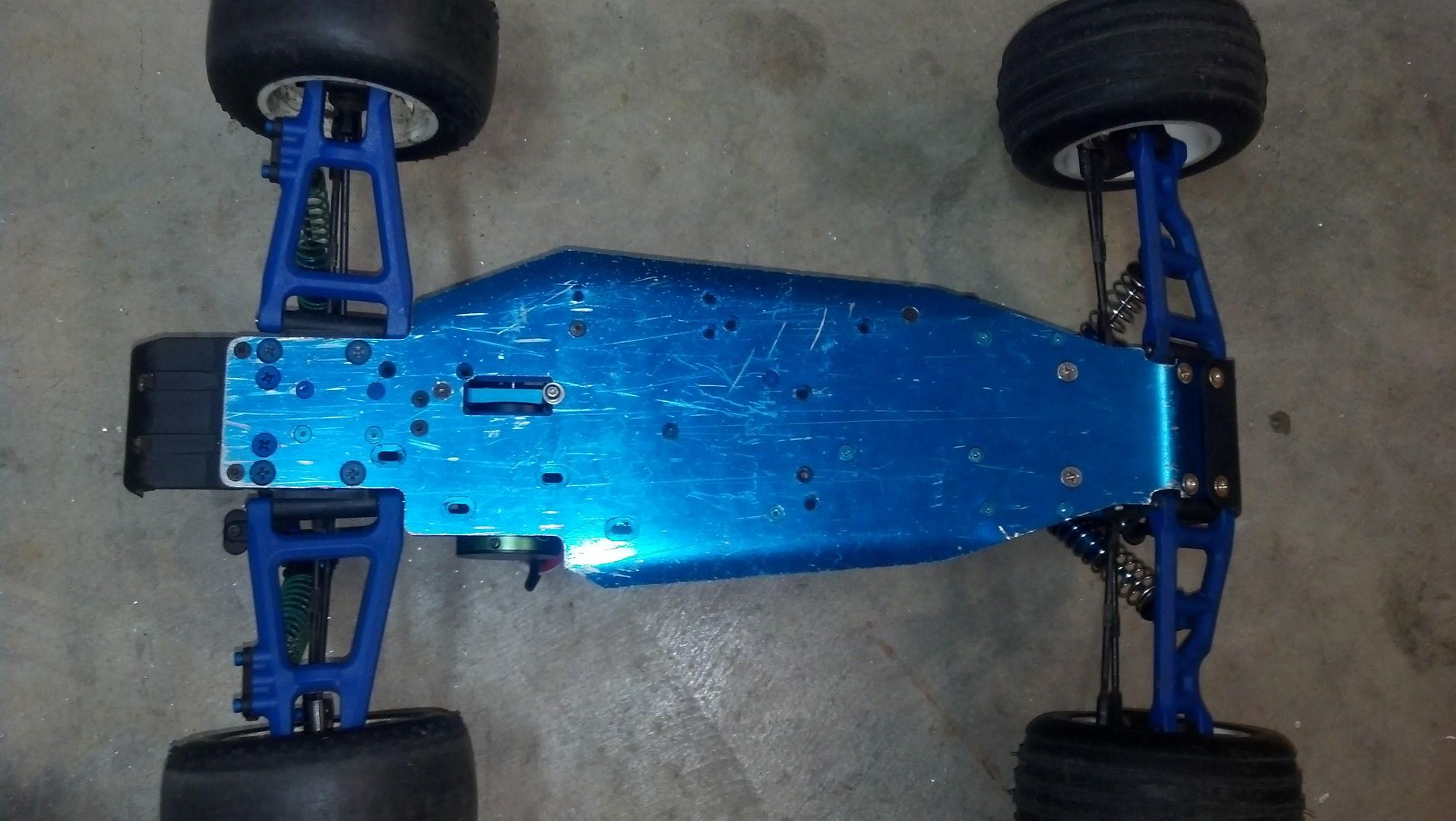

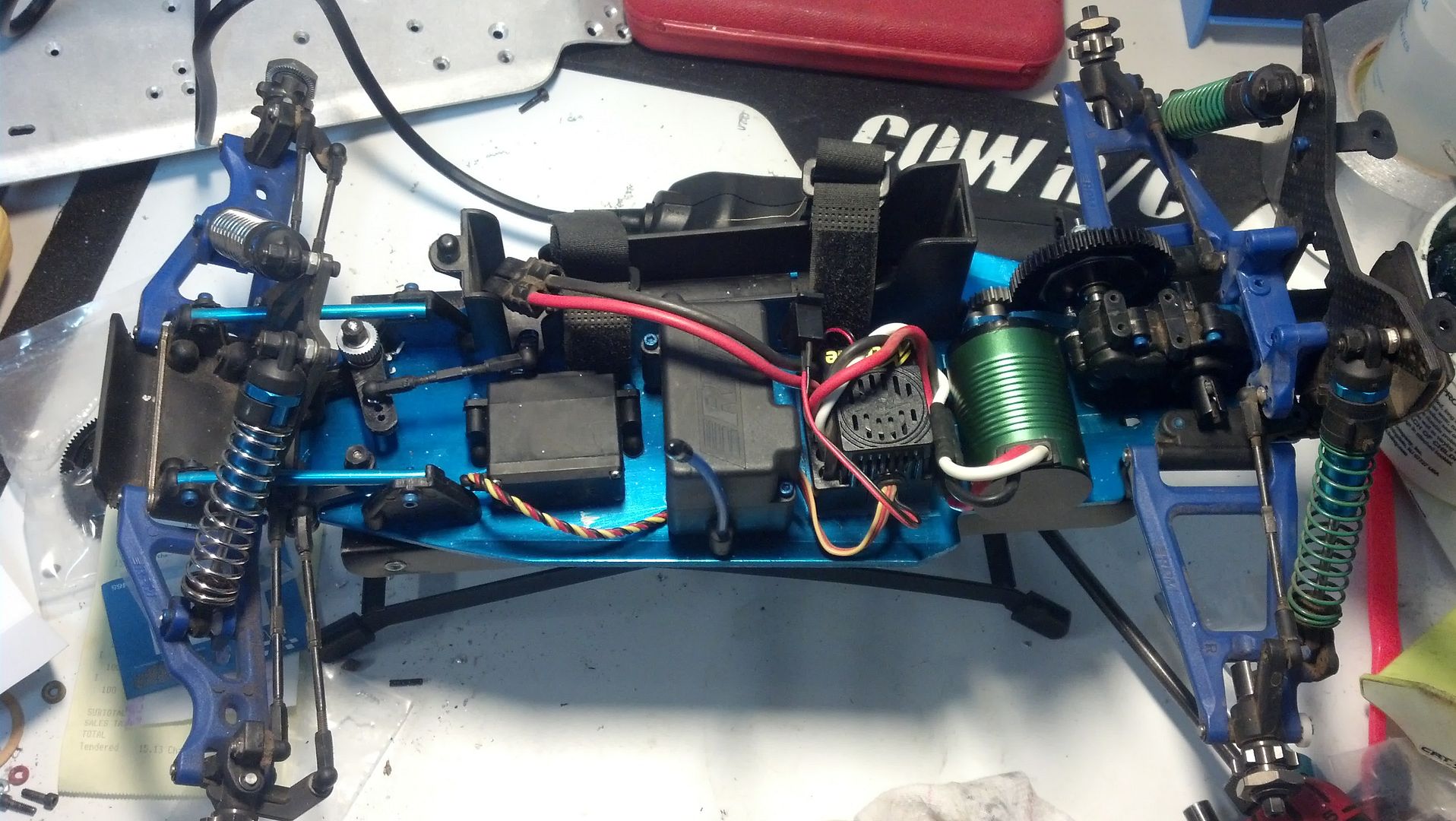

First off, i've been lurking for a long time. I posted a while back but i've but the rc10s (and 12!) on the back burner. Well now its winter and i find myself tinkering in the garage again. So i had a Rc10gt Converted over to a sc10gt with the forum member robert page's chassis, I was all done minus the body. Never finished it, got a sc8 and a Rc8b turned 1/10th Sc. I found myself really wanting a T4 on the cheap, but i couldnt justify buying another rc10 when i have quite a few in the roster alreadly. So i converted my Rc10Gt into a Rc10Gt-E!

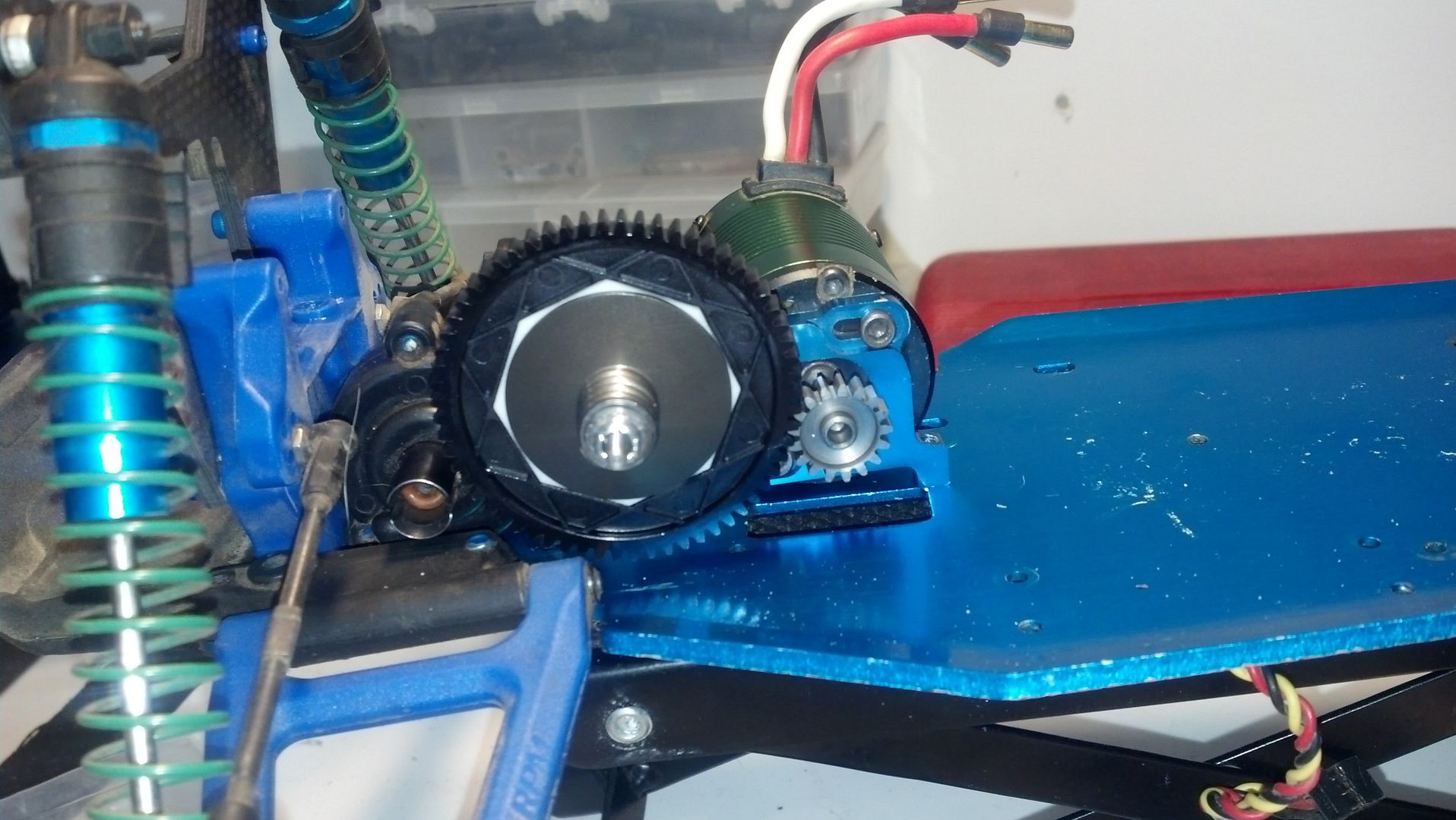

But now i need some help. I tore down, cleaned and relubed the ball diff just because i was there. I upgraded to the T4/b4 topshaft, I didnt like the 48p gears from the sc10 slipper i had so i bought a Sc10 4x4 32p slipper and used that. I test drove it tonight and i kept hearing the slipper squeal with a slight jab of the throttle or anything above 1/2 throttle. I tried fully tightening it, backing it off half a turn and so fourth. But still it would slip. Im pretty sure it is the slipper because i can hold the rear wheels and it squeals just the same.
Is there a break in procedure for the brand new slipper setup? Right now im geared 17/62, Castle mamba max pro, Castle 1410 3800kv, 2s lipo if that helps at all. I beleive im only geared for about 36mph. As you can see just slapped on some bald tires that came with it just for testing, Does that have anything to do with it?
(also if anyone is wondering those are Aka 17mm hexes for the Sc10, Fit like a glove!)
And now the pictures!

Double check the diff too. Make sure its not just the diff slipping.
^^^^^This
That is the most likely issue.

Thanks for the info. I readjusted the ball diff and it seemed to help. So I'll go back into that again tonight.

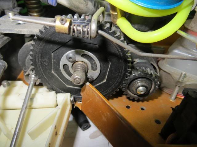

Yeah, there are definitely advantages and disadvantages to either. Nitro isn't quite as "turn it on and go", but if you don't have your batteries prepped, nitro is much more at-the-ready. All I need are AA batteries for receiver packs and TX. Glow stick holds a charge forever, fuel is always ready.
I have 13 nitro vehicles; some are finicky, others are simply pull-n-go. That HPI .18 is of the latter category. The occasional 1/8 or 1/4 turn on the HSN for drastic weather or altitude change, but otherwise the dang thing just runs and runs. Same for my blue tub FT runner with LRP Z.18S
(older pic; has since received HG alloy shock collars, FT turnbuckles, RPM ball cups and A-arms)
