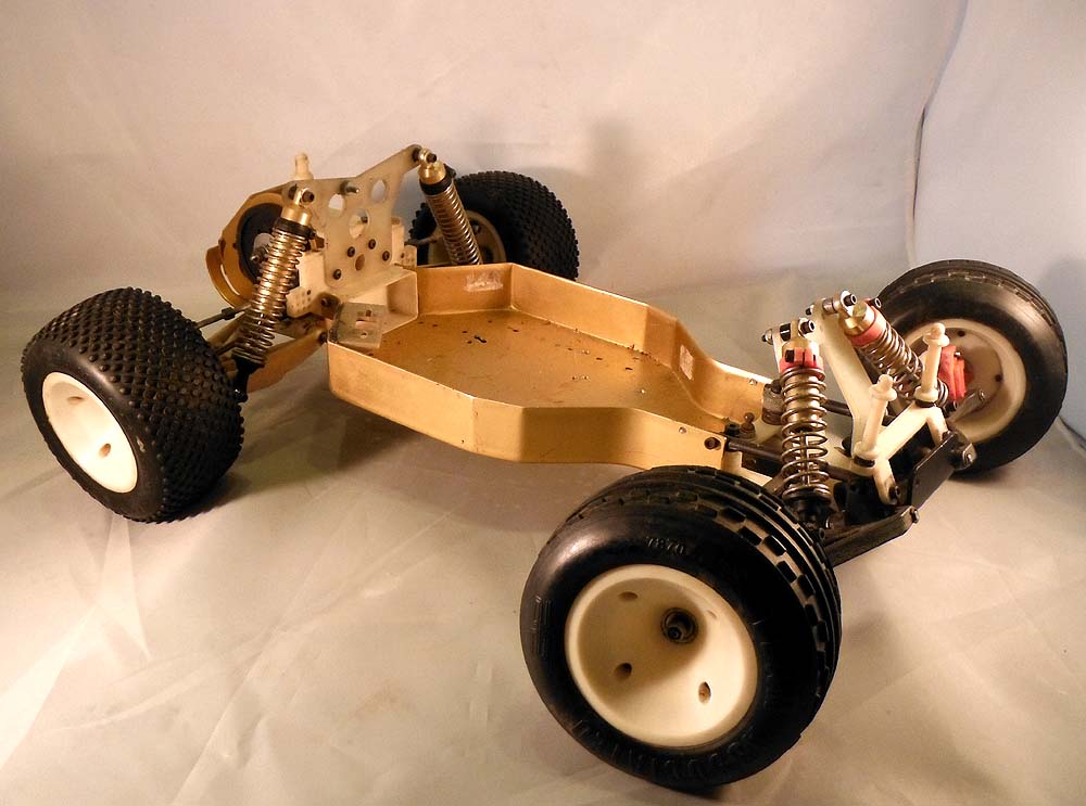

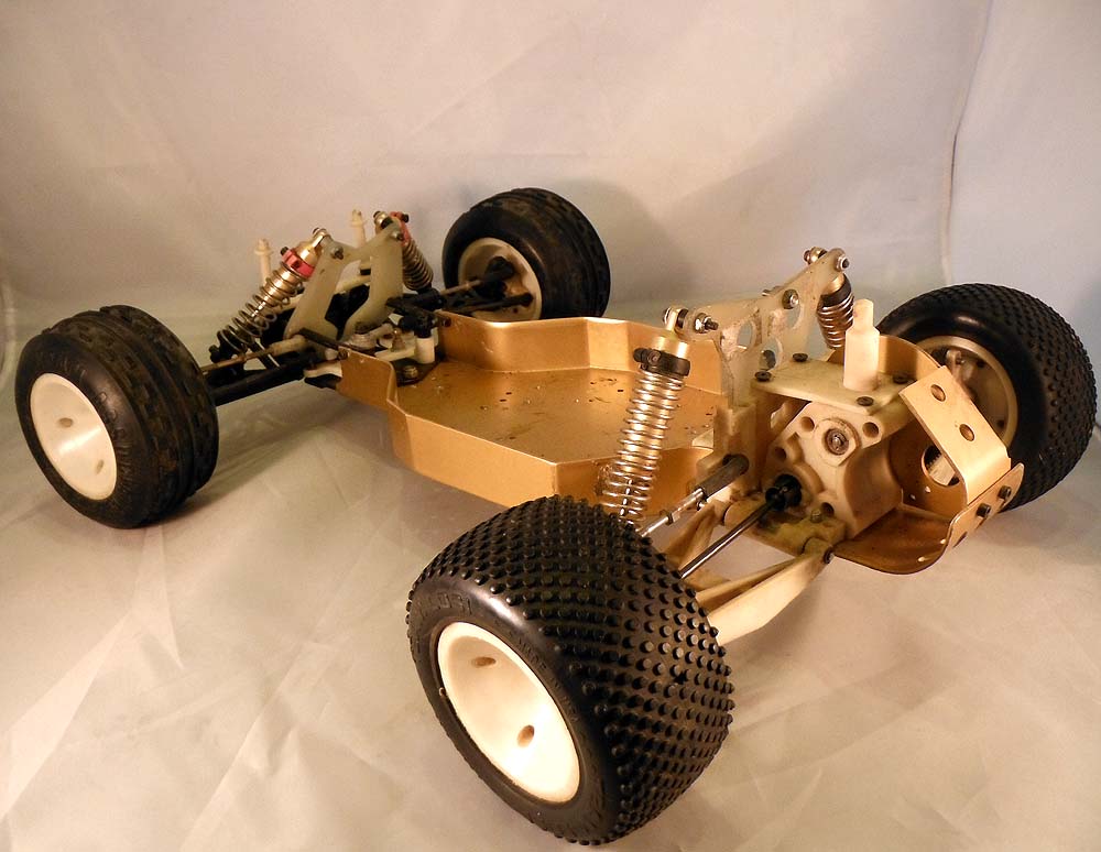

I picked this up in a trade. Its got the gold tub and a 6 gear tranny. Was the 10T ever produced with a gold tub or is this a buggy with a conversion kit? Any help is appreciated.

RC10T never came with a 6 gear or gold tub. A previous owner added the 10T front suspension parts themselves. There wasn't a kit for it.
Also looks like you got Kyosho Gold shocks in the rear and Kyosho or Duratrax shocks up front. (front spring cups look flat on the bottom).
Re: Gold Tub RC10T
Also has buggy rear shock tower on it.

Re: Gold Tub RC10T
Single hole rear tower and early rear bulkhead at that.
Might've been an edinger/early caddy car. Looks like the tub has a couple of extra holes though...were stealth trans holes added to it?

Re: Gold Tub RC10T
Thanks guys, I thought the shocks were also a bit off. Its nice to know what I have from the experts.
