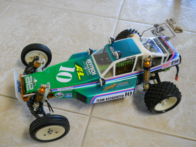

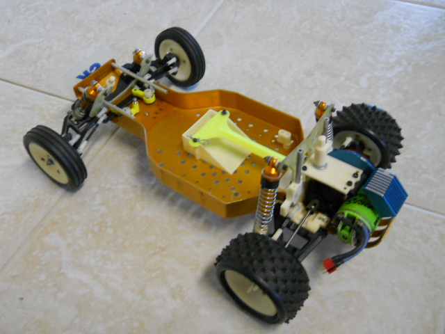

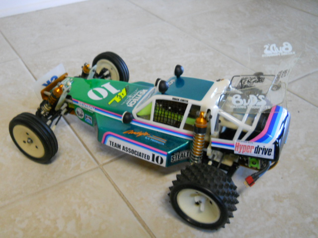

well the chassis i had from a ebay parts lot buy which was swiss cheese. so i took some extra parts i had and built this. s&k battery holder, s&k frt bumper, a&l steering, andys arms, andys frt bulkhead, hyperdrive belt drive, buds wing, revtech motor and lite sink heat sink. the cherry on top is ultrahive's painted rc10 body which is perfect!!!

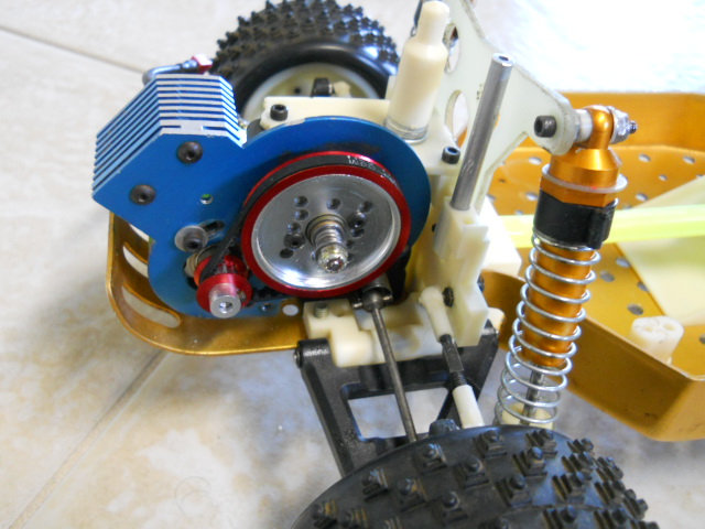

Pretty neat collection of parts, but since you left it undefined I now get to ask the question....are you sure it's not going to run backwards? :wink:

Connected by a belt, the motor pinion and spur spin in the same direction instead of opposite directions like with gears. The wheels spin in the same direction as the spur so they're going to end up spinning backwards unless you flip the top shaft in the stealth to put the spur on the other side of the car, or reverse the rotation of the motor.

o i gotcha! since she's a shelfer dont have to worry bout changing the rotion of the motor :wink: or u could just hit the nor switch on the remote to rev :lol:

You're the one who snagged that body! Very neat car.
I miss brushed motors in that hazy, everything seemed better when I was a kid, kind of way.
