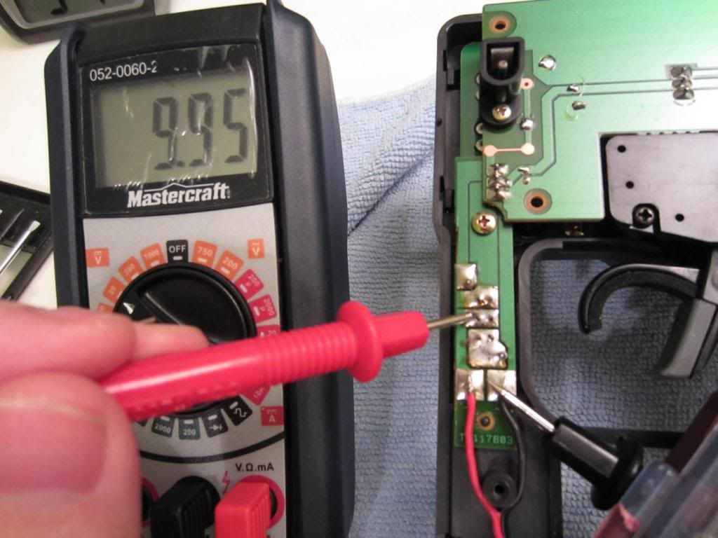

I think the on off switch works? I think because i tested it with multimeter with the on/off switch turn on and the batteries in the Radio this is what i got. Let me know what you think?DennisM wrote:Next to check is the sliding on/off switch. Disassemble the transmitter and give the on/off switch a good blast of Lectra clean or another sprayable alcohol, while operating it. WITHOUT batteries attached.
When the alcohol has vaporized You can apply the batteries and give it a try.

Before You proceed, take 8 new non-rechargeable batteries, this will give a good 12 volt supply which the transmitter was designed for. - what about the bridge between the two pcb´s. The charging socket might have a circuit that cuts the battery supply for the circuit board, could this be faulty? Dismantle all the PCB´s and check for corrosion and obvious faulty components.

KOs that I've disassembled in the past usually have a separate internal jack for a wired rechargeable pack
to which the rear charge jack goes.
It won't have connection to the spring contacts for the 8xAA cradle;
not sure if there's diodes to drop the Vs from 8xAAs vs the wired input.
