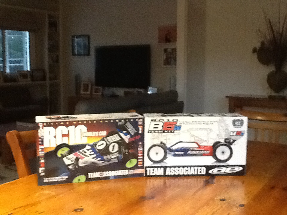

Got them both today, can't wait will start with the B5M, then the worlds, looking forward to the good the bad and the challenging , no oil leak in the worlds kit, which is nice I guess. Will post pictures of the finished products. Cheers
