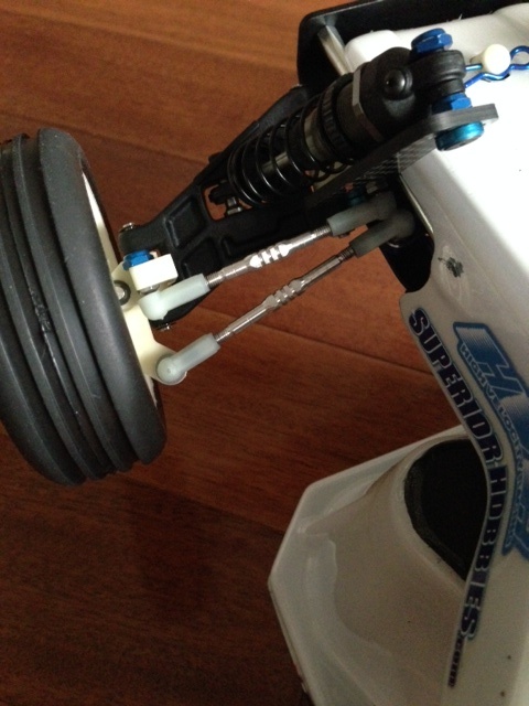

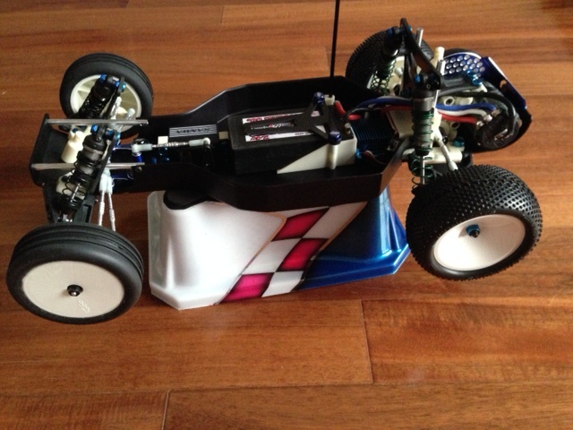

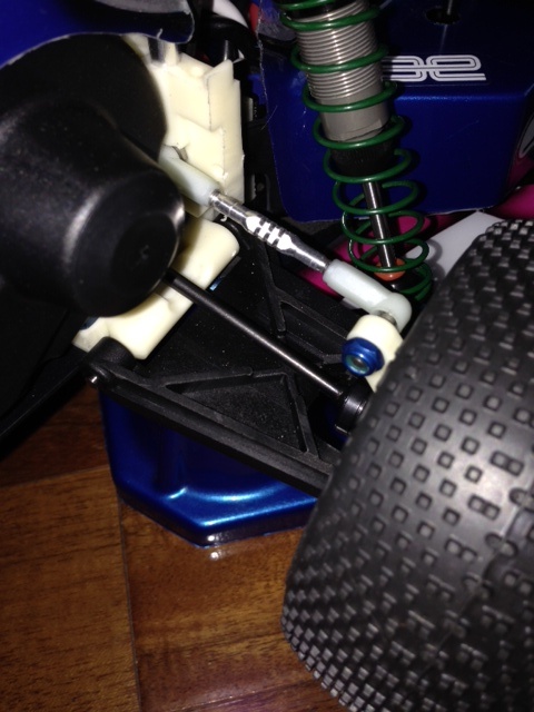

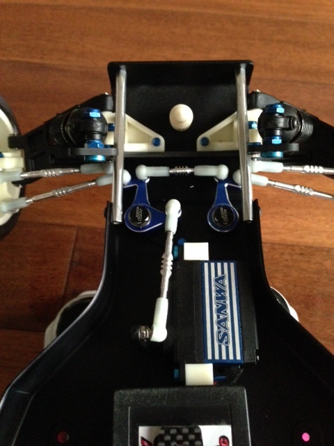

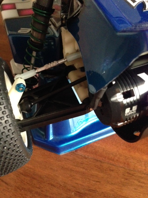

Here's a few shots of the test parts. These are aluminum but the production versions will be titanium.
Also, for those who aren't on the RC10 facebook page, here's a shot of my new worlds car. We have one test day on this electronics layout. So far it's worked great. The inherent push problem is gone.

What battery strap is that?

It's the JConcepts hold down for the TLR 22/22T/22SCT. Part number 2189. There is a RC10 specific brace coming. It looks a little different than this one but if you don't want to wait this one will work too.

Aluminum turnbuckles instead of Ti...kinda like that idea honestly. Its not about strength all the time :)

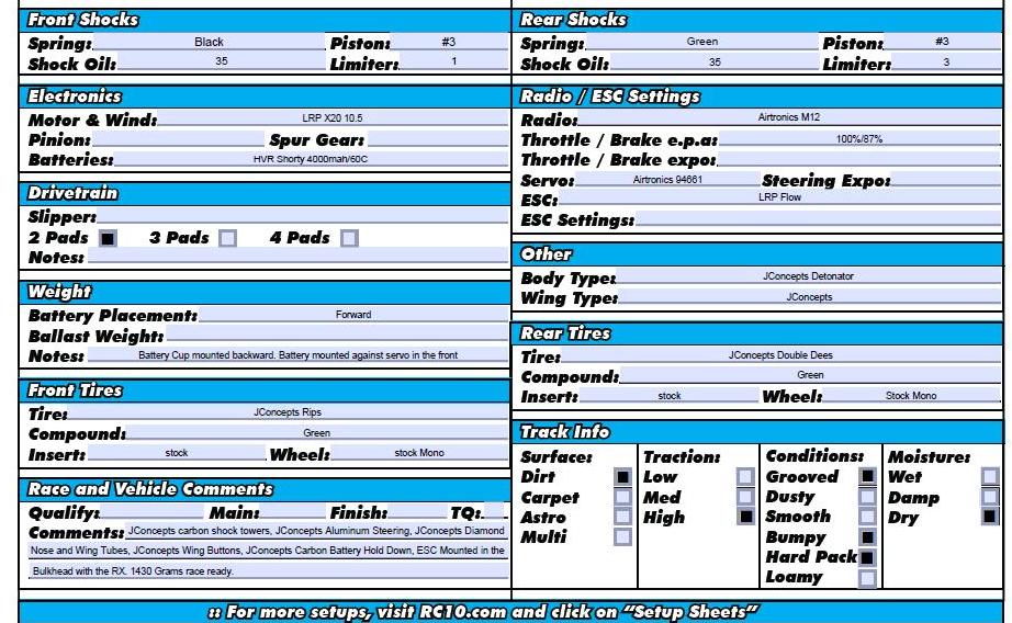

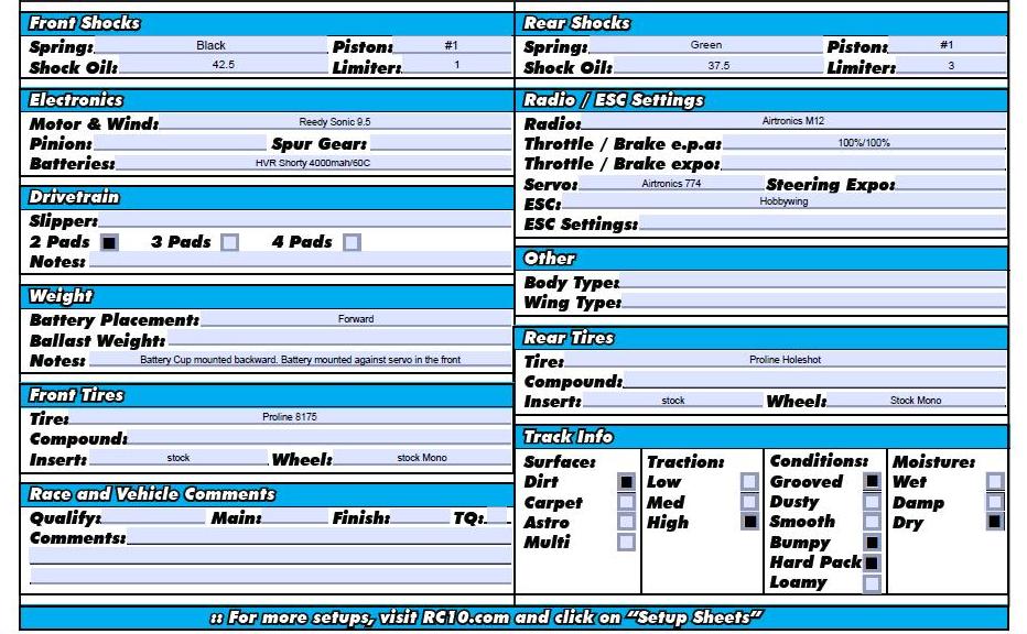

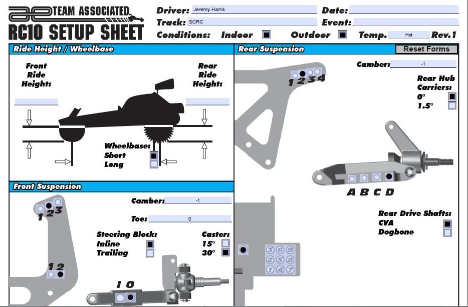

This is a little crude but it works. Here's the setups for my car and Jeremy's car. The shock package on Jeremy's car is the same as Jason Ruona's.

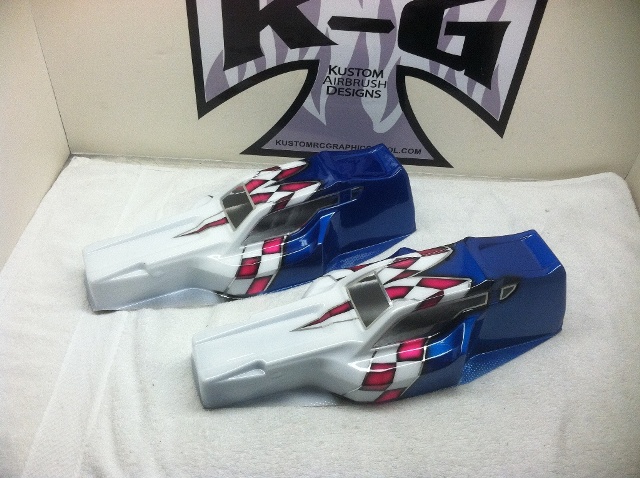

A look at what's coming :)

They look nice. What's the name of the body?
