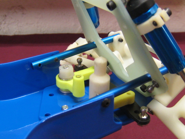

It's an andy's pro graphite tower, best suited for use on a graphite chassis. It doesn't really work with nose brace tubes.
Re: WOIN various questions
Ahh shoot. What would be a good option for a classic looking tower that can fit on the rc10t bulkhead with the tubes? I want the front to look like a normal rc10 CE/Team/Worlds.
- Posts: 16816
- Has thanked: 36 times
- Been thanked: 1318 times
buy an rpm worlds tower and shorten it. that's about the easiest thing to do. or have one custom made.
