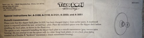

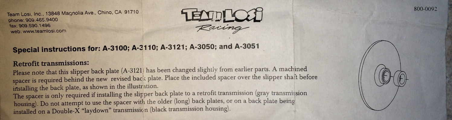

Here is the instruction sheet for the revised back plate.
