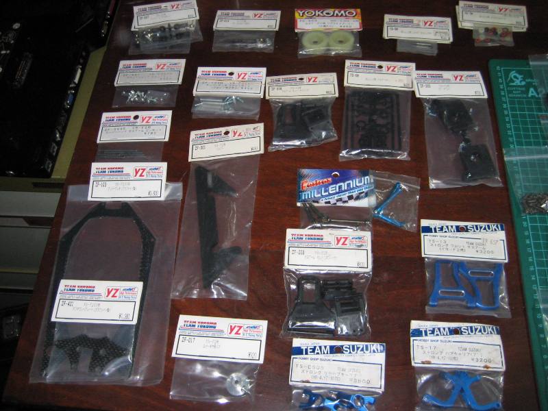

Hi guys this is a kit i got on ebay few weeks ago was started by the guy i got it from & not finshed, the car you see in photo is one a picked up a while ago with a few Fasttrax Millennium parts, so i'm looking to build up the new one with the Millennium bits (from that car) & the Suzuki parts plus the titamium screw set & aluminum parts i have & waiting on.

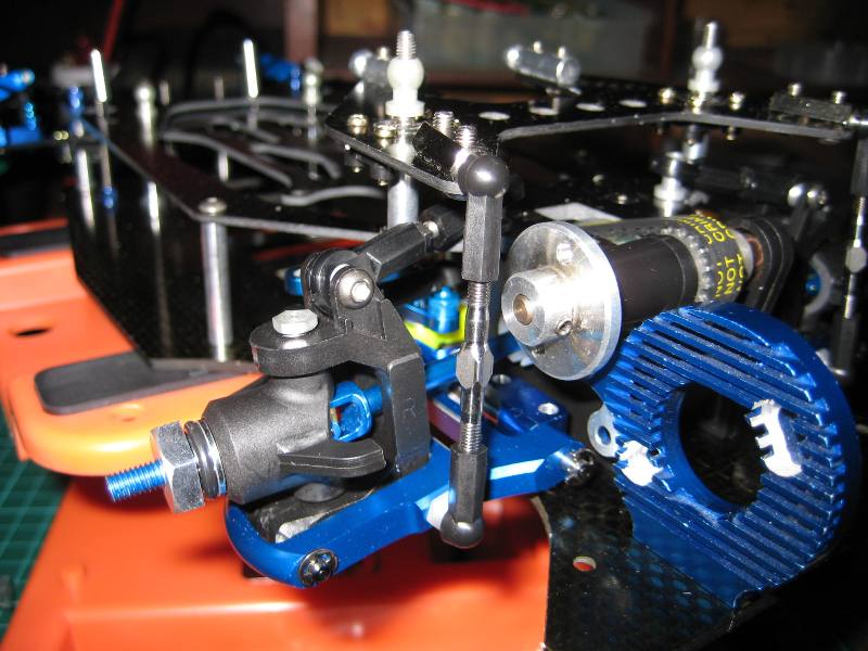

You'll notice that you can't use the Team Suzuki c-hubs and Fasttrax Millenium alloy arms together, unless you modify the arms. The c-hubs will work with the original arms if you shave a bit of material off the arms.

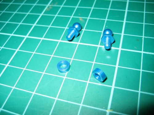

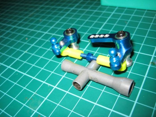

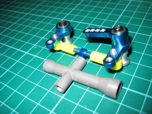

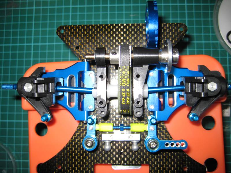

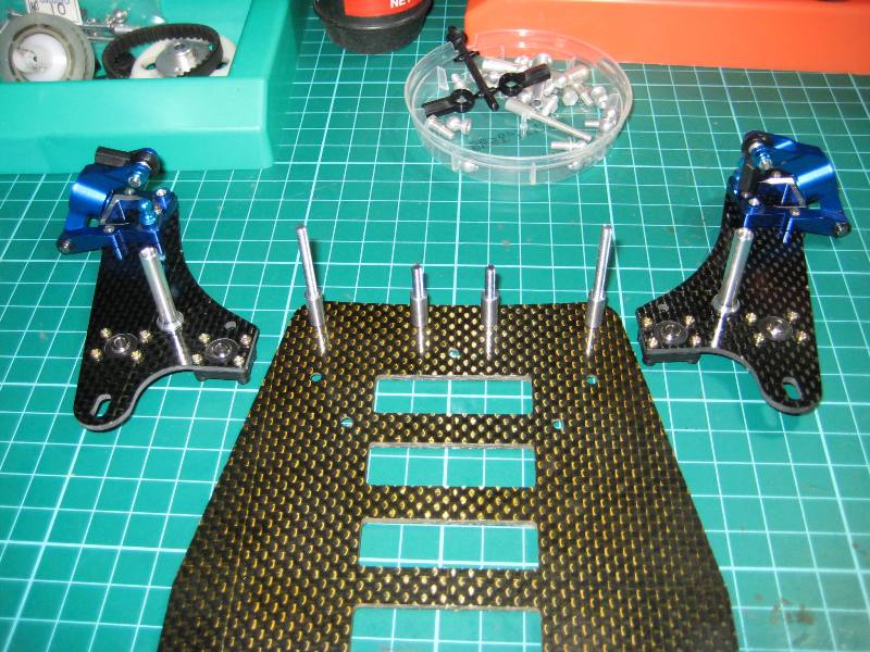

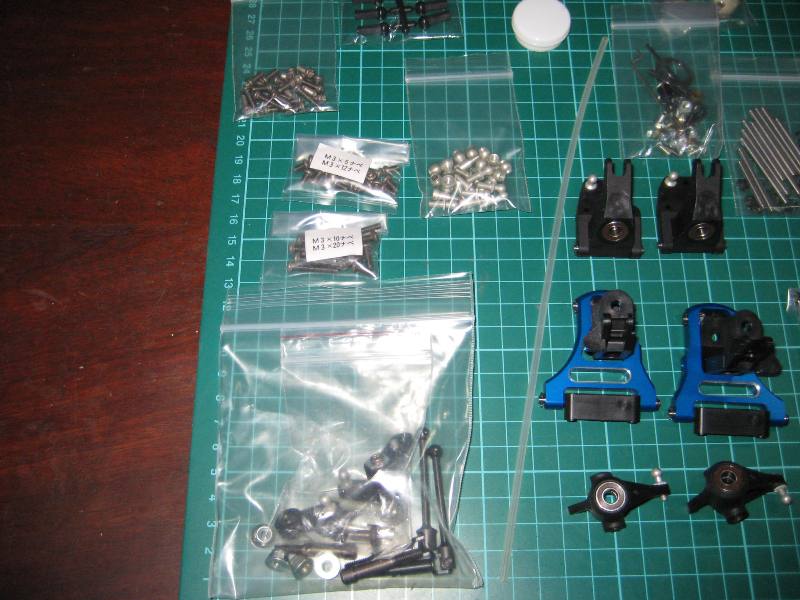

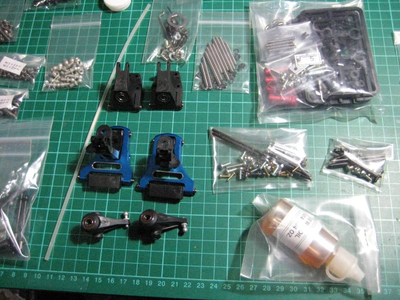

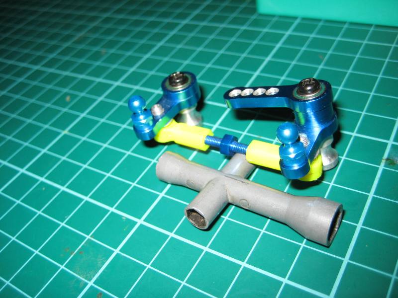

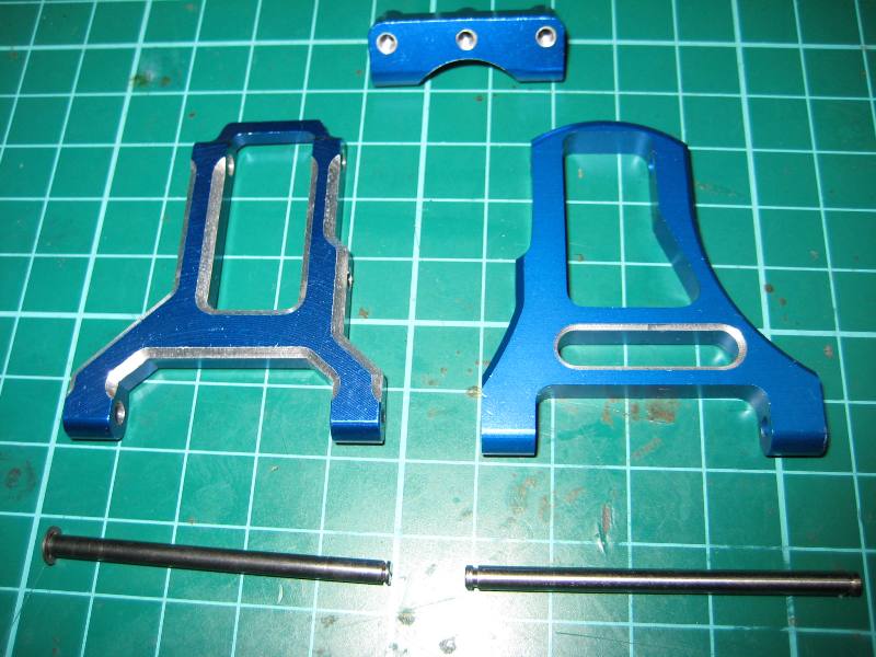

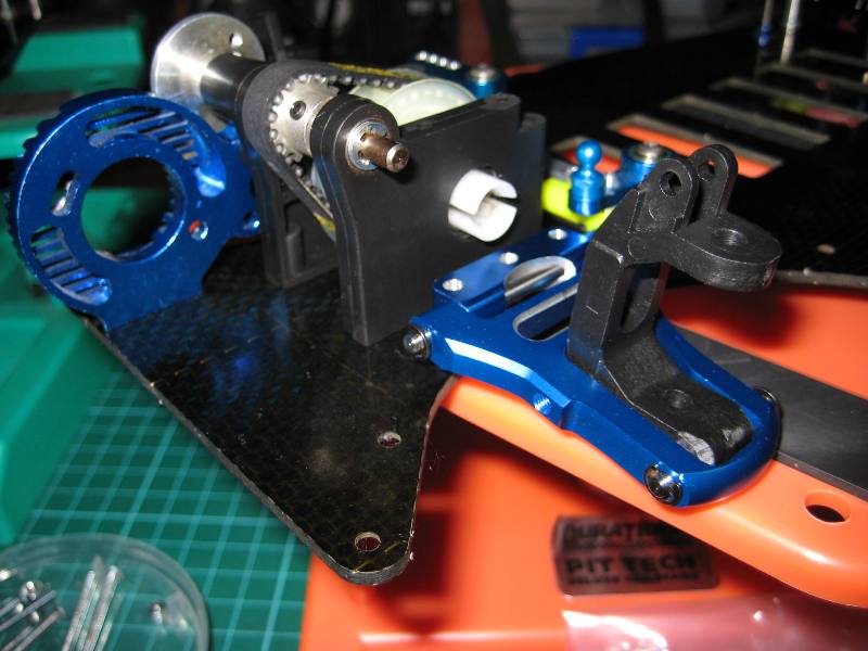

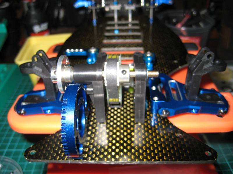

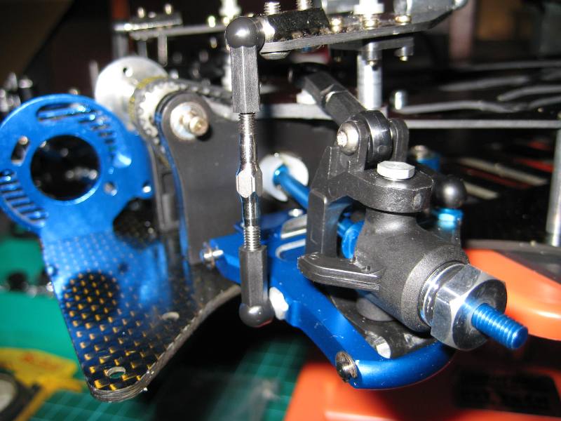

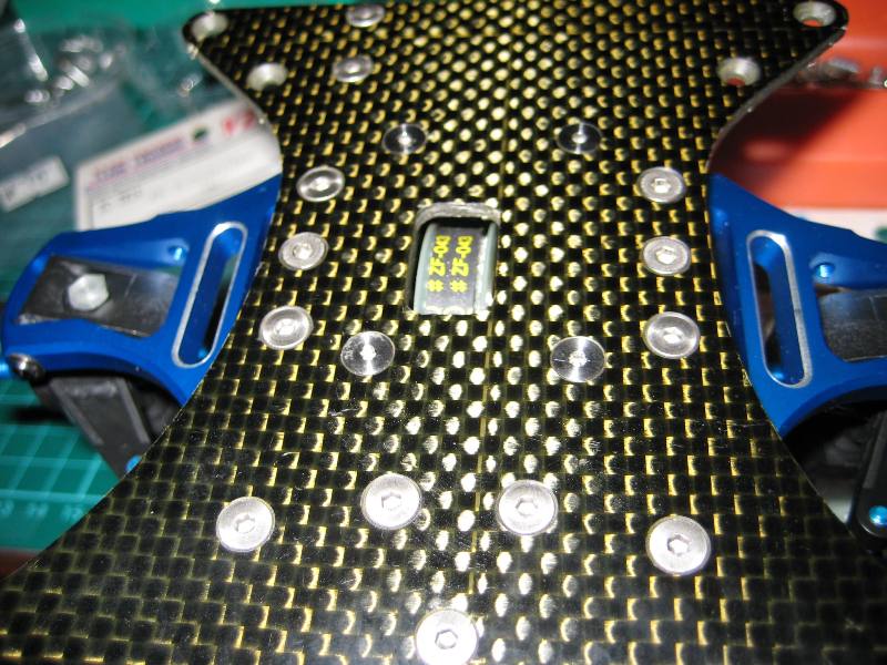

Well here are some photo's of what i've done it's not much but found some time to start.

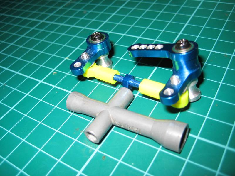

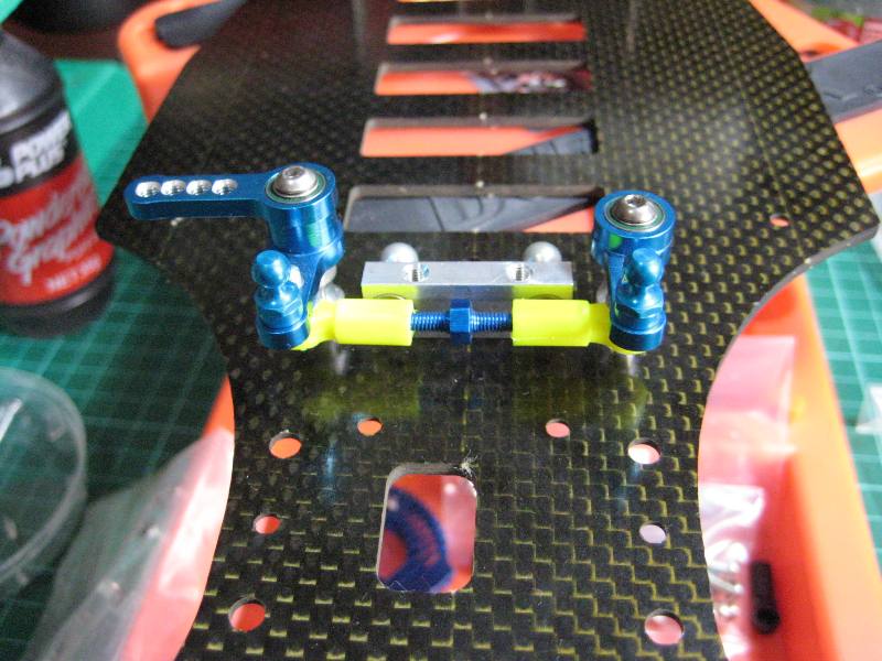

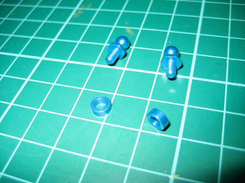

Took the donor car apart & played around with the steering linkage, found some noce blue alloy ball ends & spacers i think look cool.

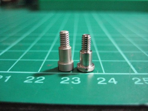

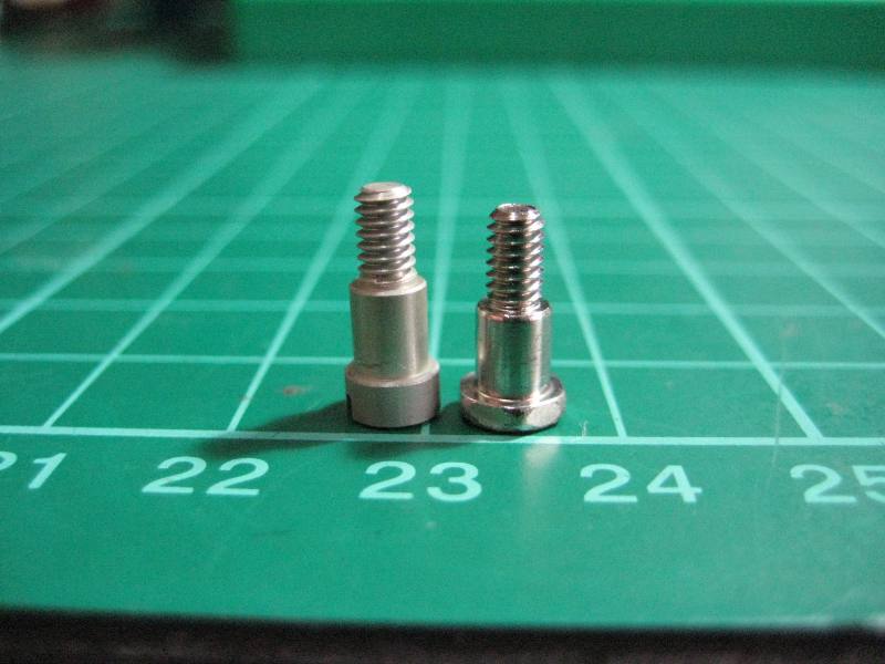

Some alloy parts i got with the car came with these kingpins(on left of photo) but as you can see from the photo the collar is to tall on the alloy one compared to the standed yokomo ones on the right, not sure what they would be for.

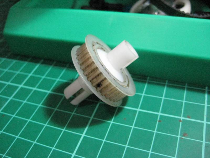

Can anyone tell me about these diff halfs? I'm thinking they might be Fasttrax Millennium parts?
Anyway will try to find more time soon to build my car. :D

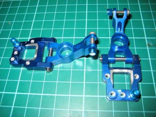

paul1600
Posts: 29
Joined: Fri Oct 09, 2009 10:20 pm
Location: Perth, Western Australia
Been thanked: 6 times
Re: Almost new build, YR-F2

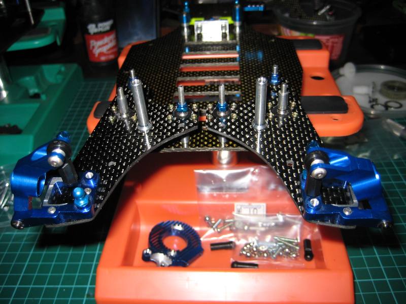

Post by paul1600 »

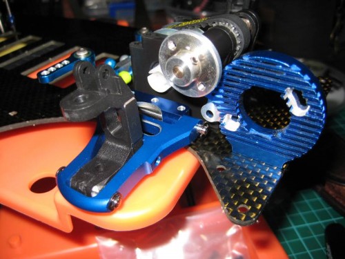

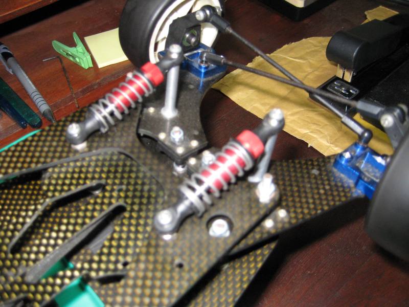

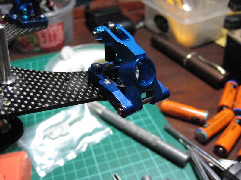

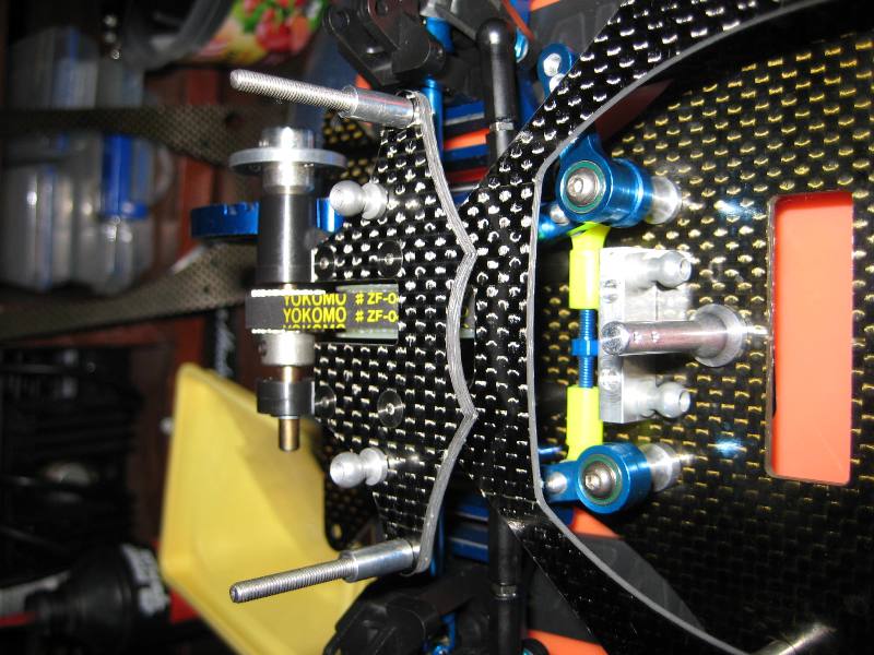

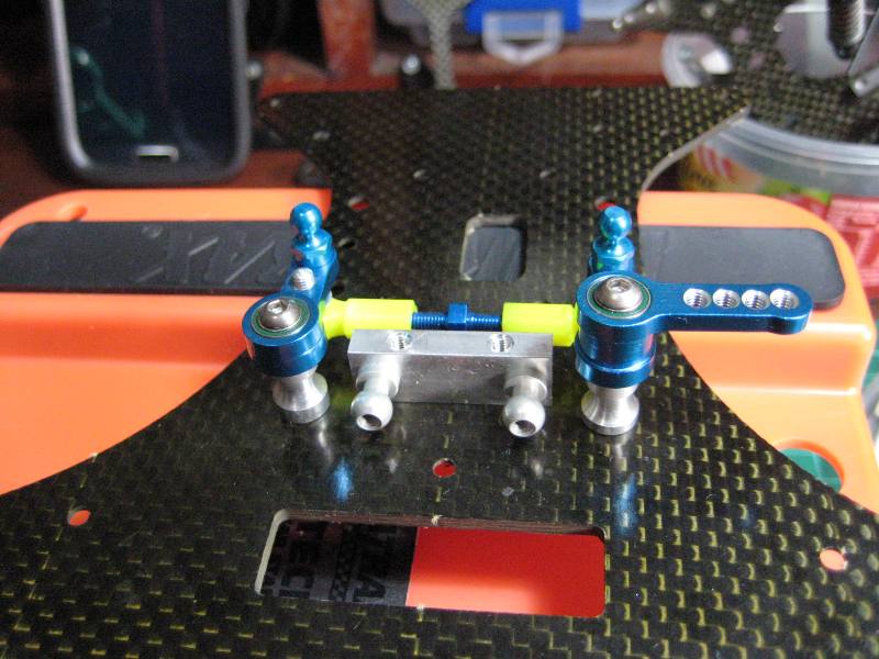

Just somemore of what i've done.

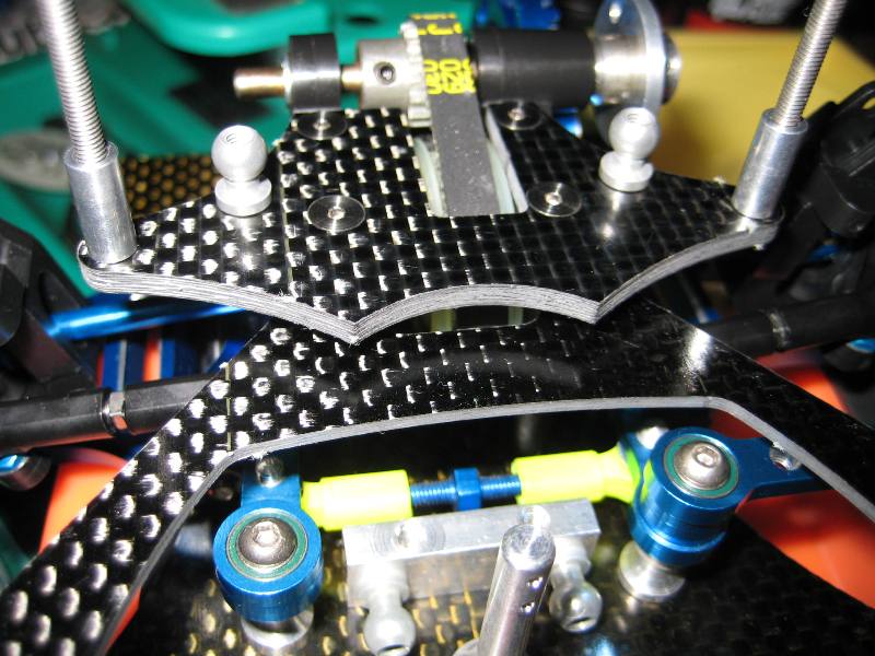

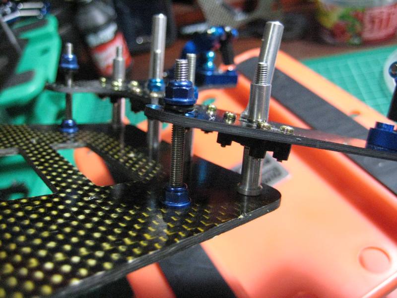

All titamium screw set & aluminum parts (apart from the pivot balls in the 4 pivot sockets & screws that hold them together), was really lucky to find the long screws in titamium in my box of parts.

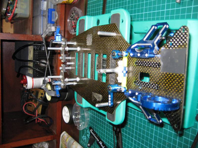

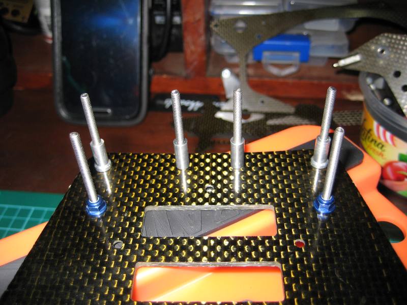

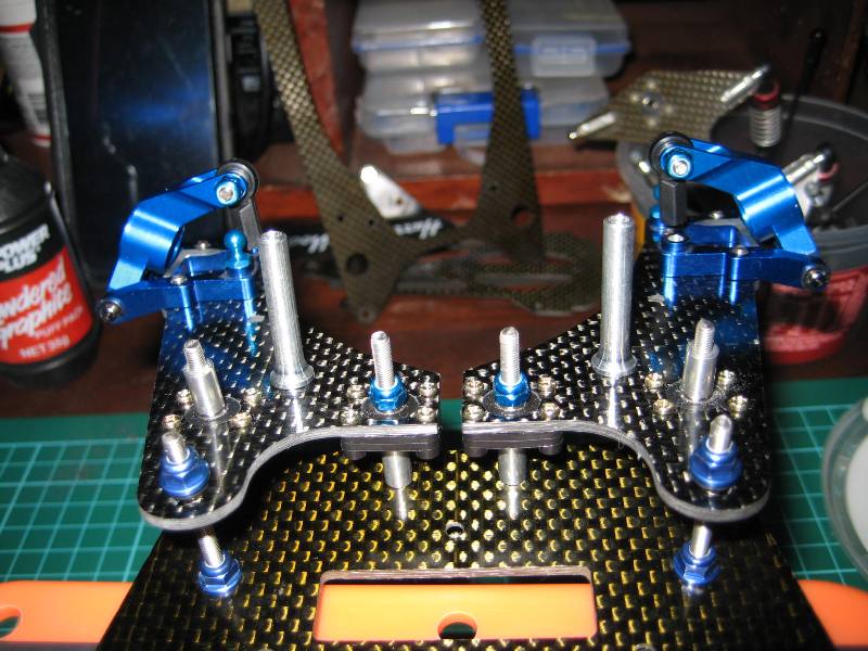

Post by paul1600 »

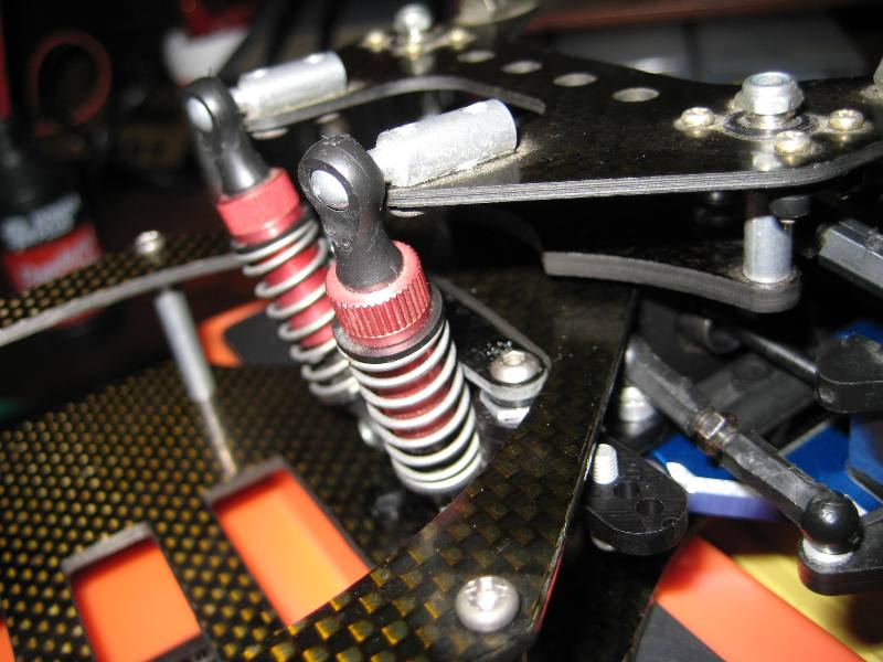

Really enjoying myself building this car. :D
Im on the look out for 90mm titanium turnbuckles, if anyone has any ideas were i might find some could you please PM.

EvolutionRevolution wrote:You'll notice that you can't use the Team Suzuki c-hubs and Fasttrax Millenium alloy arms together, unless you modify the arms. The c-hubs will work with the original arms if you shave a bit of material off the arms.
Yeah you are right EvolutionRevolution they don't work even the Team Suzuki are don't work. :( Saying that the c-hubs i have are the 7 degree of caster ones TS-17. Are these the same as you have or the other ones i've seen?

I think those c-hubs exist in 10 degree versions, too, but those likely have the same problem. I used the plastic arms on mine.
The diff halves are likely by Fastrax, by the way. Also looks like the turnbuckle for the steering set-up you got is the right length - mine was too short.
There's also alloy bulkheads by Fasttrax Millenium, which make it possible to attach the front motor mount to the bulkheads with two screws. This fixes a weak point on the YR-F2 (makes it less likely that the motor moves in a front impact). I think there's likely also an optional front body mount that attaches to these bulkheads...

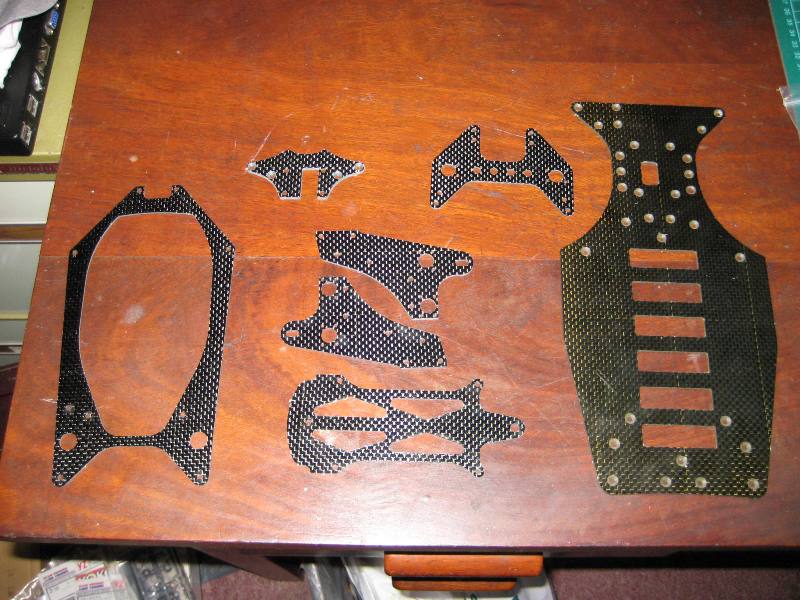

Could you measure the thickness of the carbon parts? I get the impression there's some variation there (I have two different topdecks, one thin, one thick).

Yeah measured the carbon parts & you're right about the upper deck.
Chassis 2.5mm
Upper deck 1.5mm & 2.0mm
Link plate 1.5mm
Rear sup arms 2.0mm
Diff mount plate 3.0mm
I measured the 3 cars i have & found 2 upper decks at 1.5mm & one at 2.0mm. Why do you think that is? Maybe there supplier ran out of 1.5mm carbon one day.

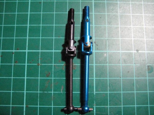

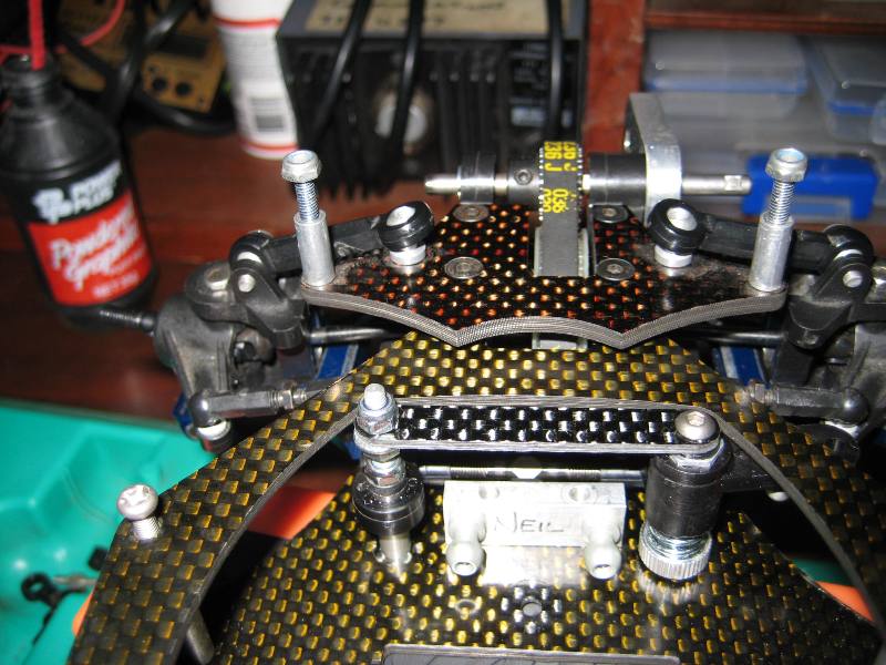

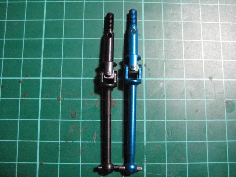

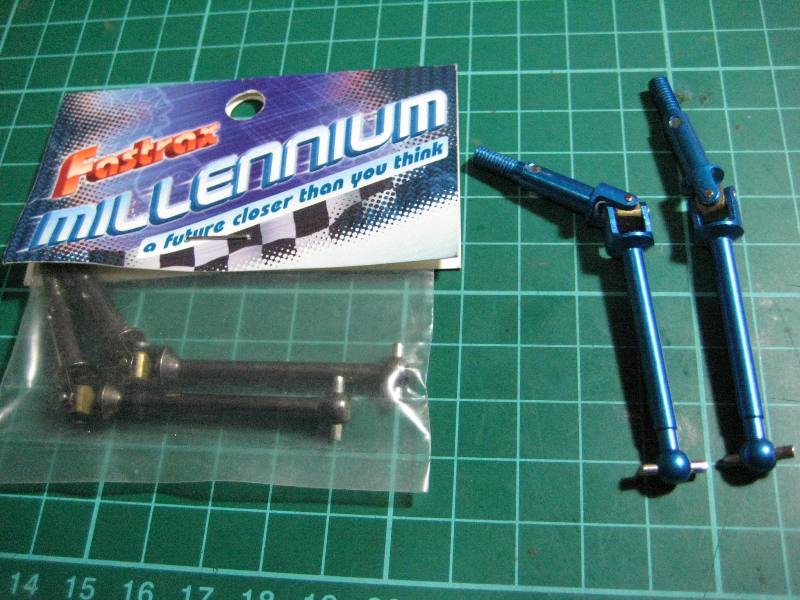

You can see the drive shafts i have, they don't really work with the white diff there to long so they just fit inside the diff halves, for a shelf queen (like this one will be) they look cool but you would not get the suspension travel on a runner.
Shame about the c-hubs not fitting. :(

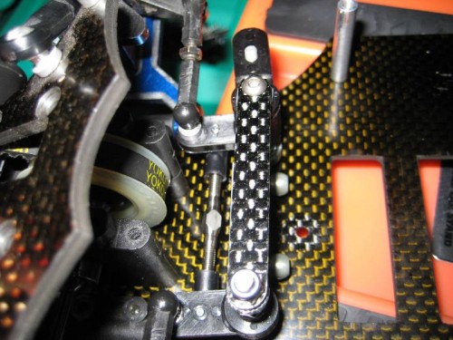

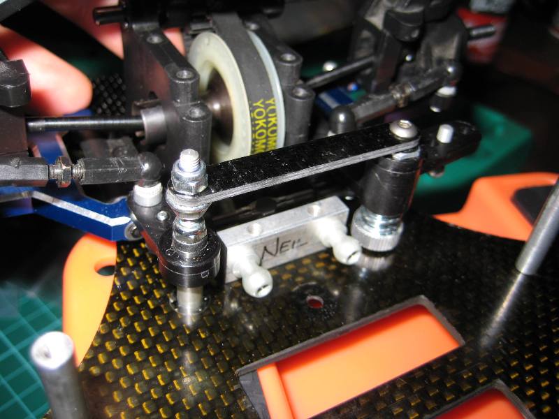

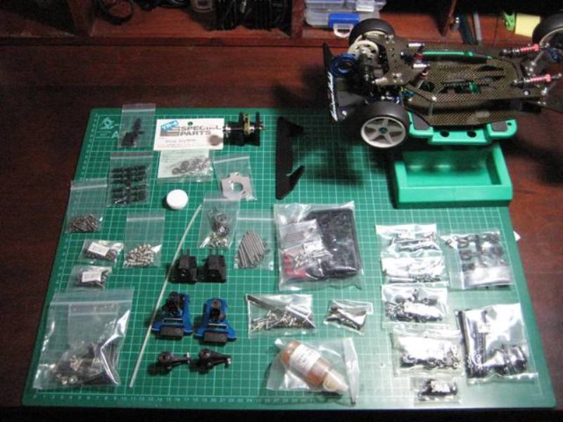

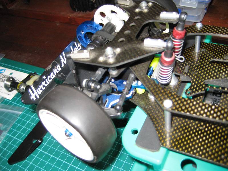

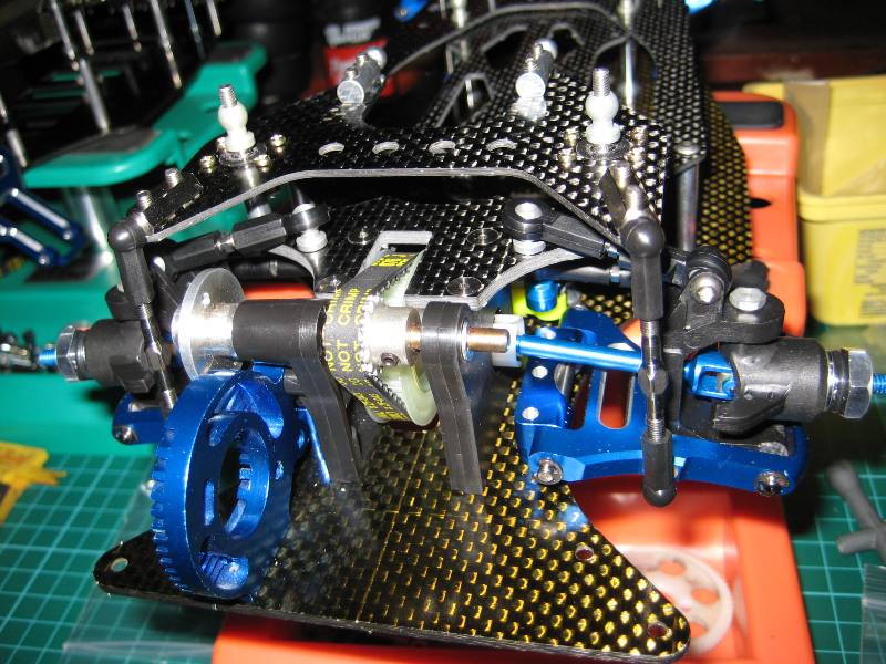

Here is were i'm up to, about to start building thr shocks, still on the hunt for 90mm titanium turnbuckles then to find some wheels.

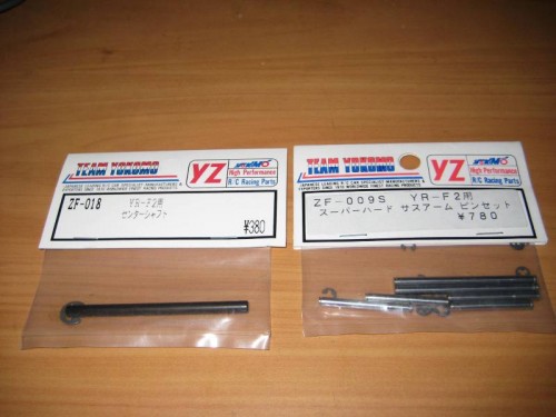

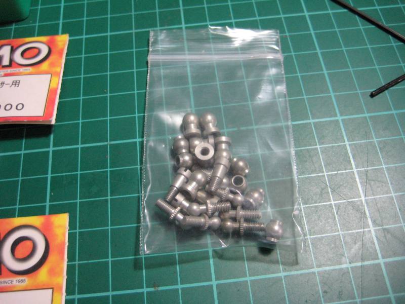

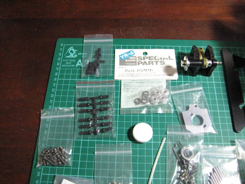

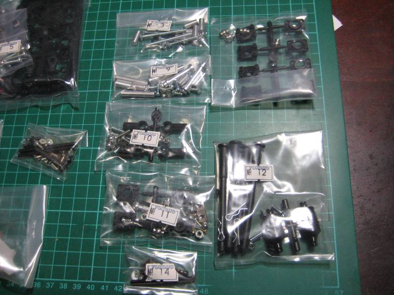

Just found these in the box i got my car in, part numbers for some of the Fastrax millennium bits.

paul1600 wrote:Yeah measured the carbon parts & you're right about the upper deck.
Chassis 2.5mm
Link plate 1.5mm
Rear sup arms 2.0mm
Yokomo updated the car at least once. There's also two different Yokomo motor mounts: the first one only screws onto the front bulkhead with a single screw, while the second one wraps around the layshaft to fix the aforementioned issue with front impacts. Furthermore, there's two different hinge pin sets (regular steel and blackened) and two different layshaft pulleys (a soft silver one and a hard black one - if you have the latter, use it).
Unfortunately I don't know which top deck goes with which version of the car.
It could be that they need to be used with the thin spacers that Yokomo also used on the YR-4 (these go between the outer bearing and the drive hex). One of my F2's has a set of titanium rear axles (no clue who made that, sorry...) that also use the spacers and bring out the rear to 190mm. Yokomo touring cars were always "ultra-narrow" (180-185 mm) compared to other touring cars.

I see you found the part number for the delrin diff halves. I seem to remember that Integy also made M60 composite c-drives for the YR-F2 a few years ago when I ordered some for my YR4-M2. Mine are yellow, but the YR-4 and I think the M2 Type J c-drives were white like the pulleys Integy sells.

EvolutionRevolution I did'nt know there were two different motor mounts, yeah i have the harded hinge pin set new & a set came with one of my cars (the thing is the harded set would not fit in the Fastrax front arms had to use the black ones on the other car), this is the only black shaft i have.
I know what you're talking about with the spacers, it's the drive shafts are long were they come out from the diff half to the inside bearing they push into the diff half & bottom out if you look at the photo from a couple of posts ago you will see the shaft length from standed.
Think you're turnbuckles are Yokomo ones, titanium rear axles would be nice to have. :)
