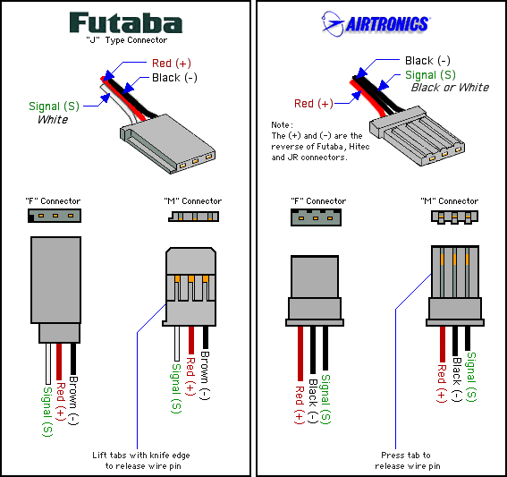

This servo came with some random parts I bought. I have looked a bit and can't find how to wire the extra wire. Does anyone have a wiring diagram for this servo?
Thanks,

It would go to a lead on a ko esc.

ya its to supply extra voltage to the servo .. ive got the speed control for it lol

is it just a positive input? 7.2v?

I believe the wiring is the same as Futaba. The middle wire (blue in this case) is the "+" power wire. Note, the old Airtronics has the power and ground reversed.
- Limestang

Thanks, that's exactly what I needed. I tried a search and should have tri d a broader one.

I was able to confirm operation of the servo by attaching to a receiver and putting a separate voltage to the blue wire, seems to work great.
So the wires from the servo in the harness are: blue (signal) red (pos) black (neg); and the lone blue wire is for a +7.2v input.
