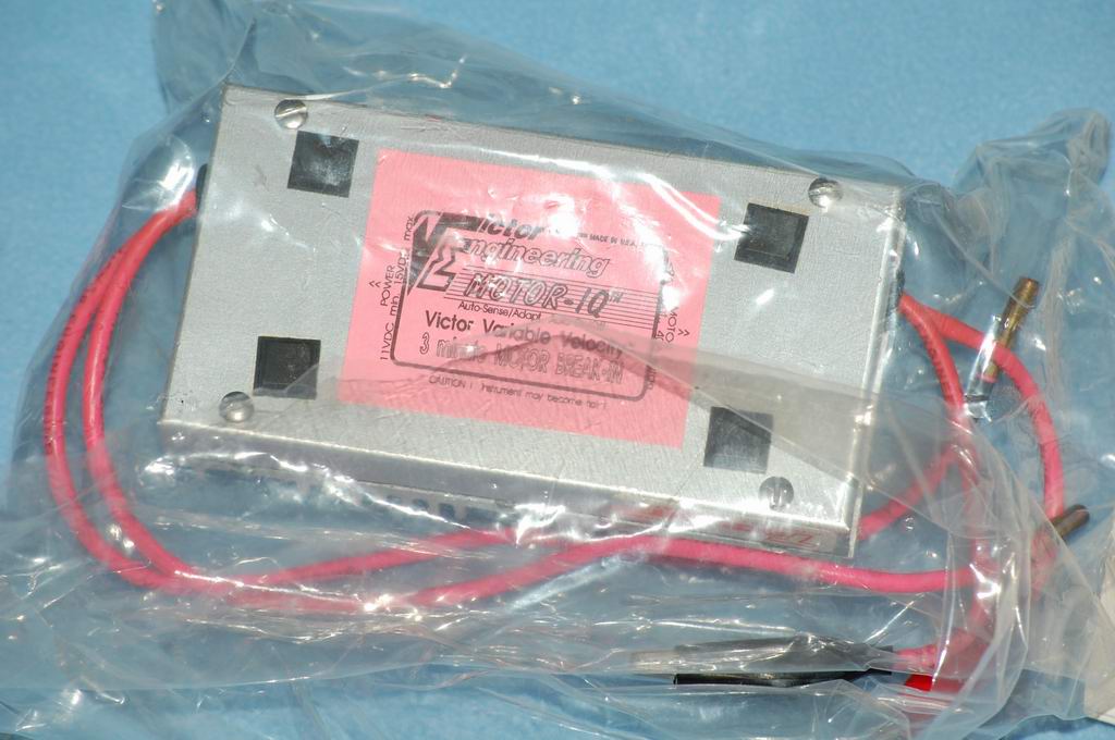

- Posts: 361
- Joined: Wed Nov 12, 2008 9:03 pm
- Location: China
- Regular Member
- Posts: 14
- Joined: Mon Mar 17, 2014 1:57 pm
- Location: Colorado Springs, CO
Re: Victor Super IQ Brushed Motor Break In
Lovely piece! I haven't seen one of these in decades. Does yours still work?crusaderlyf wrote:Is this right? I have for years but never take out.
- Posts: 361
- Location: China
I think it still work because it keep new in box for yearstheibault wrote:Lovely piece! I haven't seen one of these in decades. Does yours still work?crusaderlyf wrote:Is this right? I have for years but never take out.
