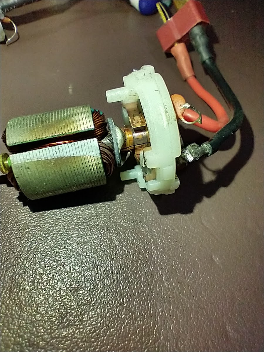

Most closed can motors feature brushes that are extremely hard and not at all conformed to the surface of the com and out of the box is often running on very skinny portions of the brush. Most of the motors have the face of the brush cut in the shape of a "u" but it's not the direction you'd think it'd be in like open endbells motors. Instead they're rotated 90 degrees result in the tiny tips being in contact with the comm, this is to aid in the break in of the brushes over normal use but on it's own it could take several race days to break in a motor.
You can see this is the this Mini JRX2 motor but it's the same for the bigger motors too. (these are just easier to open without destroying) Note the wear pattern on the comm, tiny little stripes are where this motor was making contact out of the box. This limits the current the motor can actually draw, meaning less magnetic power and in turn less torque to get up to speed. Also more heat at the tips of the brushes since there' almost no contact area.

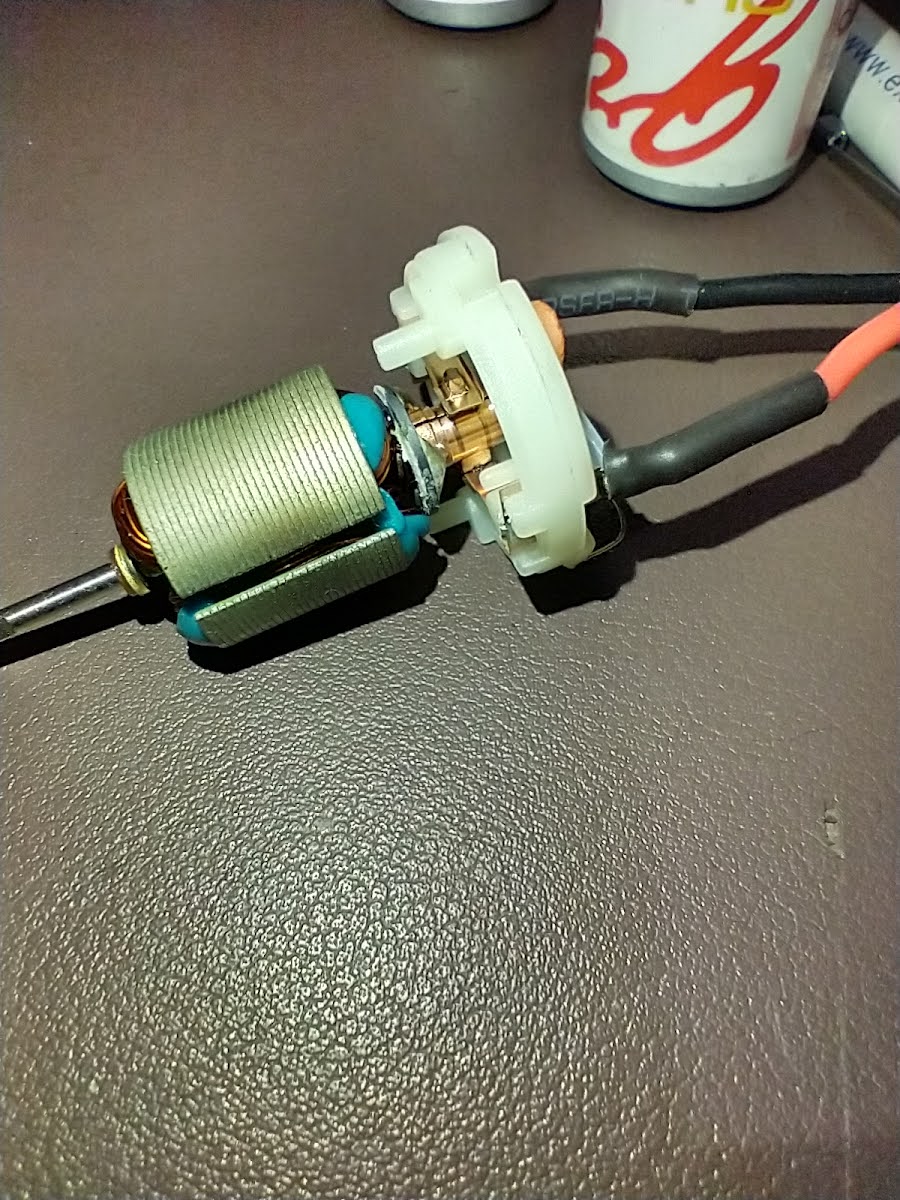

Now look at the wear pattern on the well broken in motor.
The brushes are making full contact with the comm now allowing it to draw way more current and in turn more torque.
Unbroken in brushes are basically the same as running power cables that are far too thin for the current draw.
