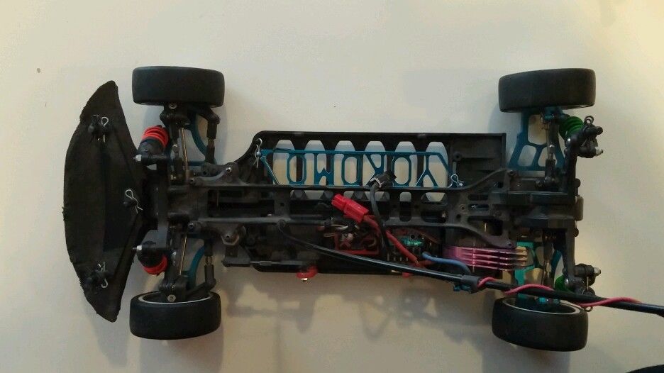

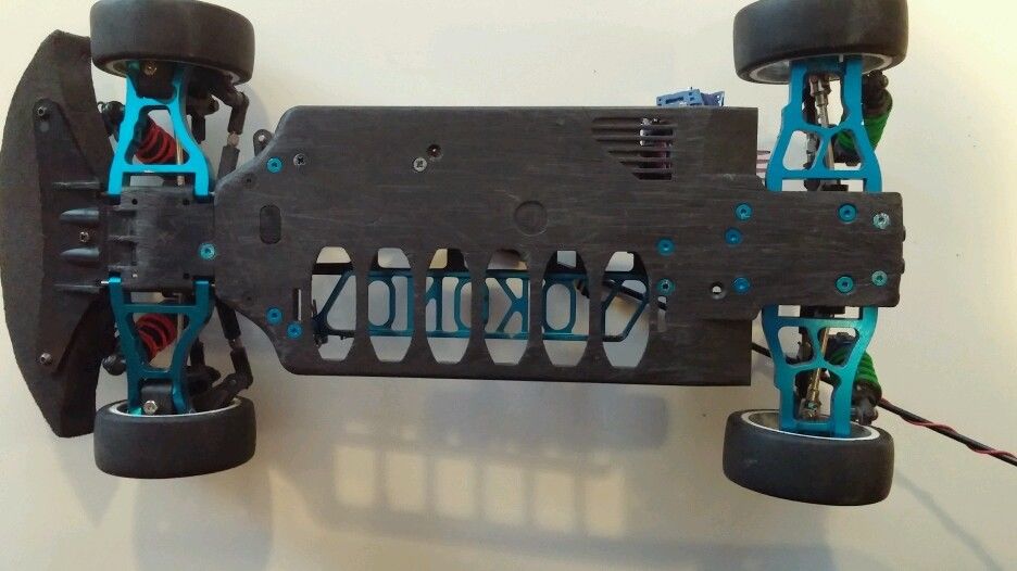

Re: Now I'm in trouble.. I bought a MR-4TC Special.
After the first trip to the track we found lots of bugs to sort out.
The ESC would start out hard and fast then slow and run about half speed.
It was also a model without reverse. That became very annoying chasing the car down to free it all night. (kids was driving)
The steering was binding and wouldn't hold trim.
I had the oneway front diff working but by the end of the night it was freewheeling on the right side again.
I took it home, tore it apart and found a few things..
The front a arms were installed upside down flipped left to right causing the suspension and steering blocks to bind up.
The oneway broke a bearing cage.. it was toast.. It's now glued up as a spool.
As for the motor I swapped in a Novak GTB and 17.5 brushless.
It's running good now.

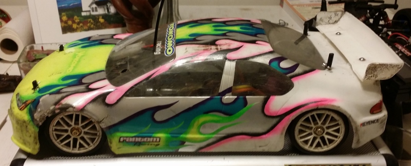

It came with a body.. nicely painted but beat up a bit.. It's serviceable till I get a VTA body. I'll probably get the AAR Cuda for it.
This is the body. beat, dirty but it's got some style.
I put the old wheels on for some street testing.
