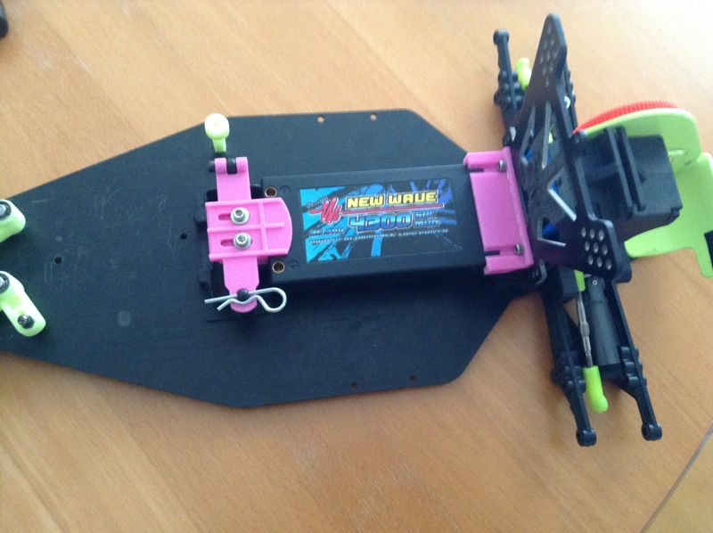

Preview on what I was needing all the tower info for.
