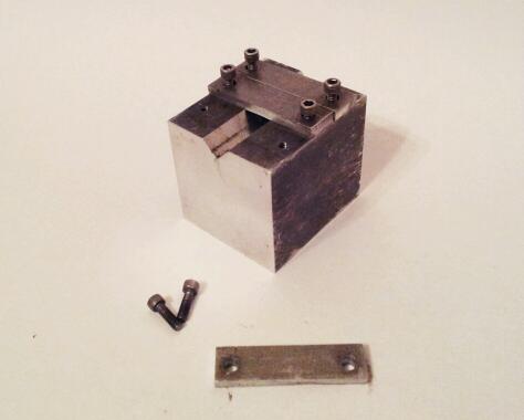

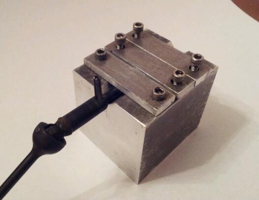

I made a V block with strap to hold round things and drive out roll pins, best thing I've done in a long time.

RC10th wrote:I made a V block with strap to hold round things and drive out roll pins, best thing I've done in a long time.
would you mind putting up a pic for inspiration, please? The three on this car are done, but I have plenty more in the pipeline :) thanks!

I'll try to get a picture soon, pretty simple but effective.

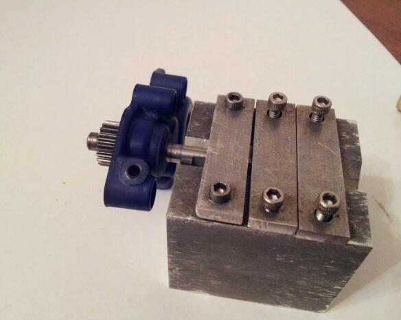

Found it.....
It fits anything round of any size to easily remove roll pins :D I usually reuse the old pin if it's not too torn up, if it is I'll replace it. I got tired of the pliar thing and tired of the top shaft always rotating while you try to punch it out. It holds everything firm so you can use two hands and also saves scratching the shaft.

Post by Lonestar »
Precision-engineered :mrgreen:
Just pulling your leg. I'm jealous. I just HATE these roll pins with a PASSION!!!
Nice work :) thanks!

Great build up so far. 8) I like that jig for getting the pins in and out too. :wink:
