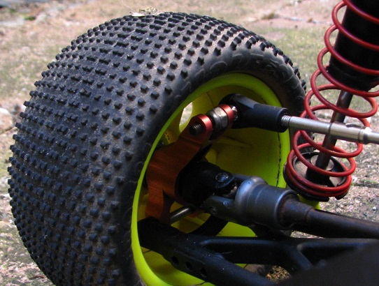

I'm building a project that's going off the beaten path and am a little stuck: the stock XX U-J's don't reach far enough to stay in the drive cups
What I need to find is a rear axle carrier that will accept the standard XX bearings and axle but will bring the wheel inwards by about 5mm.
If possible it would also raise the wheel a bit more above the arm.
(I had some old JRX-2 carriers for the H-arm conversion at hand to try. But they raised the wheel only about 1-2 mm and their offset was identical with the XX carriers. EDIT: they could have raised the wheel more if I hadn't cut the lower mount many many years ago)
From the manual it looks like an rc10 b3 carrier might work, though it does nothing with the wheel if not lower it further into the arm...
The XXXS carrier brings the wheel higher up, but I'm not sure regarding the bearing size and it has an even bigger offset than the stock XX carriers :(
Any ideas are most welcome

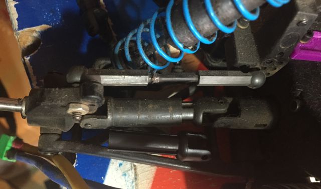

Another option to keep in mind if you have the parts around is maybe converting to sliders. This will help with your driveshaft issue staying in the drive cups.
But if you don't have sliders then that could prove to be not worth the effort in acquiring financially.
If you have the sliders then all you need is A3095.
http://sabulatech.com/storefront/product.php?id_product=115
Here is picture on a XX buggy that shows how much slider length you would have to work with.

Got my customworks parts today. But decided to not use them after all; as I'm pretty pleased with the new solution I found in the meanwhile.
Inspired by the idea of going 'slider' I went through my stash and came up with this: composed U-J with dogbone from the XX a new cross part ( origin unknown) and a metric axle (probably Traxxas). YR-4 (Kose?) rear axle carrier and some touring car hex modified for a 5mm axle.
Pictures say more than words:
