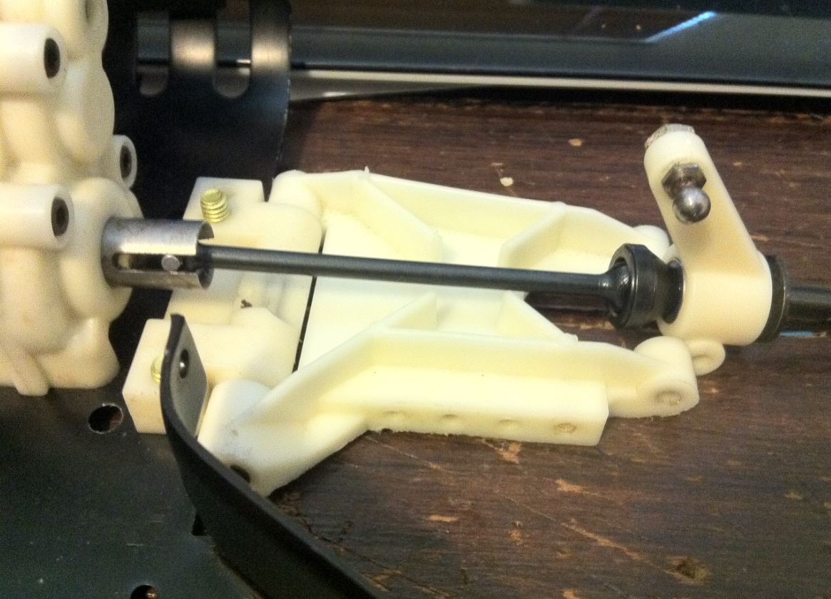

Re: *Parts needed to run modern 2.2 rims/tires on your rc10*
Hi Guys,
This is my first post. I'm quite new to RC10's and anything AE, so please forgive my ignorance.
I have a Team car that I am trying to convert to modern wheels. For the life of me, I cannot figure out what I am doing wrong. The CVA bone appears to be 10mm too long for the arm, which you can see in the attached image.
The parts in the picture include :
B Stamp Chassis
Kit 6360 arm mounts
Kit arms
9756 B44 Rear CVA kit
7364 RC10WC Rear hubs
7377 Axle spacers
3/16x3/8 plain bearings
The length of the bone is 62mm which appears to be correct. The only difference I can spot is the 9755 axle images online show a bowl shaped cup where the ones I have are conical.
I'm sure I am doing something silly, so if someone could give me a nudge in the right direction, I'd greatly appreciate it.
Cheers,
Scott.
B Stamp Chassis
Kit 6360 arm mounts
Kit arms
7377 Axle spacers
Cheers,
Scott.
You need longer arms to use the b44 cva's. RPM worlds or Dynotech Klein arms.
You need this CVA for standard arms : http://www.teamassociated.com/parts/details/6371/
Thanks the replies
Boy am I confused now.
I purchased the B44 kit as the Worlds manual lists 9760+9755 which are both B44 parts. Is the manual incorrect or am still missing something glaringly obvious?
AE 9760 is the bone from the center diff to the rear diff, not from diff to wheels, it is shorter than the B44 rear diff to wheels bones (that you purchased).
