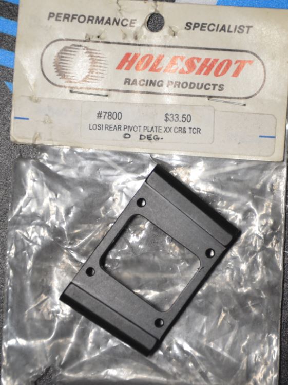

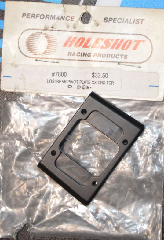

I am very happy to have found this Holeshot Racing Products aluminum rear pivot plate.
I believe they fit, but am not absolutely sure yet. The transmission is a very tight fit, but the arms mount up perfectly. I am not a big fan of the anodized blue parts, but I wanted to use an aluminum pivot, so this is a great fit.

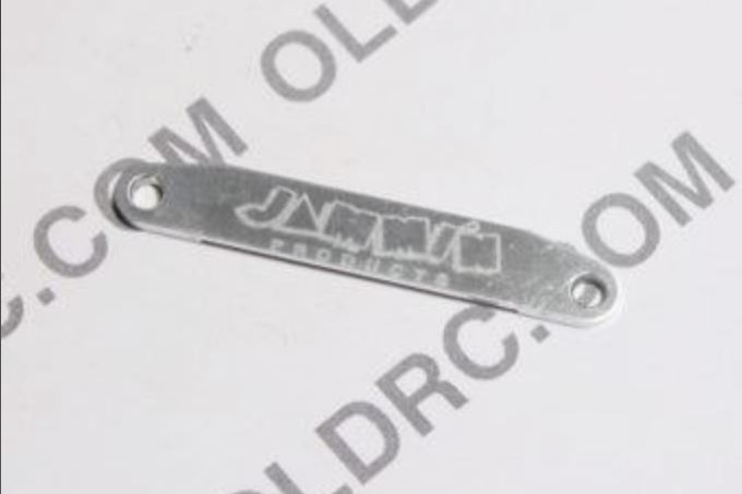

I also may (very much a maybe) have found someone with a Jammin front brace. Beside Hog Drives, this would be the shining jewel of this build. I won't know for a few days, but I have all fingers and toes crossed for this one!

Re: Losi XXT CR Graphite Plus - Re-Rebuild
Good find - I agree they are pretty special and do not come about very often!lavigna wrote:I also may (very much a maybe) have found someone with a Jammin front brace. Beside Hog Drives, this would be the shining jewel of this build. I won't know for a few days, but I have all fingers and toes crossed for this one!
That black pivot plate is extremely cool. I did know they made that outside of Trinity parts.
The Jammin front brace is nice, I have one on my XX which really is the shining jem on the car.
Can't wait to see how the build finishes.

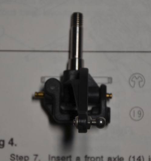

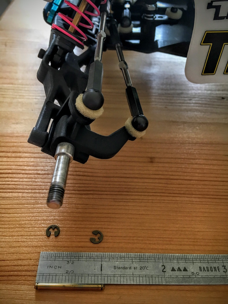

Jammin - I have come across another hinge pin problem. I bought 2 new sets of coated Losi LOSA6082 hinge pins (3/32 x 1.05") however the ones I got actually measure 1.15 in length. This makes them too long for the front axle/spindle connection, and front outer arm connection.
Did I just happen across an wrong lot of parts, or are the new LOSA6082 all 1.15" in length? If you have any extra of these parts, would you measure them and see what length yours are? Both of the sets I bought are newer, with the new Losi logo.
Thanks for any help.

LOSA6082 are definitely the ones you want - Just checked my build photos (although not posted) and that was what I used. LOSA6081 (the next shortest) will be too short for the truck, but fit the buggy.lavigna wrote:Jammin - I have come across another hinge pin problem. I bought 2 new sets of coated Losi LOSA6082 hinge pins (3/32 x 1.05") however the ones I got actually measure 1.15 in length. This makes them too long for the front axle/spindle connection, and front outer arm connection.
Have you actually tried to fit them? 1.05" compared to 1.15" is not that much (0.1" or 2.5mm to us Brits!) - Losi might be measuring groove to groove, not overall length. I can measure mine up later when I get home - but I think you've got the correct ones.

Jammin - They can still work, but are definitely too long and don't look right. The picture below shows the pin installed, with the instruction manual reference below.
For the front steering, I ordered a set of King pins, which should solve this problem, and is true to the CR Graphite + truck I am building anyway.
As for the rear, I ordered another set of LOSA6082. This set has the vintage tags, and is hopefully the correct length. The 1.05" measurement is the end to end measurement. Again, the 2 sets I had both measured 1.15" end to end. It doesn't sound like much, but it actually make a big difference.

That is odd - I'll have to check mine tonight, I don't remember them being that long. If you are using the king pin ball studs - what about the hinge pin length for the wishbone/hub carrier - is that too long also?
In fact, you can just about see in this link/picture that the hinge pin lengths look fine on my build (for the wishbone/hub) - i'll get measuring tonight for you!
http://www.rc10talk.com/viewtopic.php?f=27&t=20539&start=45#p280295

1.15" is definitely wrong for LOSA6082 - The ones on my truck measure as described on the header card 1.05" (full length):

Jammin - I received my new set of LOSA6082 today, and they are the correct length. I just got a bad batch last time. Anyway, perhaps their odd length will come in handy with another build down the road.

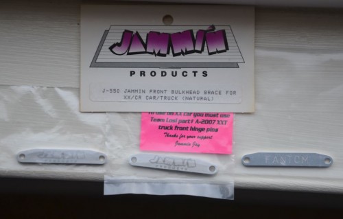

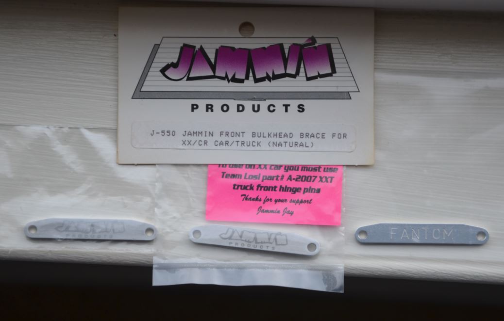

I am continuing to add the parts needed before I can rebuild.
A huge thank you to Jay Halsey! After months of searching for a JAMMIN front brace without any luck, I reached out to Jay to see if he happened to have the part. Jay has always been a RC hero of mine. He could not have been more kind and generous to me. He searched his shop for the part, found one, and mailed it to me. As luck would have it, right after speaking with Jay, I found another brace for sale. I couldn't pass it up, so I went from none to 2 quickly.
Jammin continue to make amazing RC products, and I cannot thank him enough for all he did for me. It is too cool to have reached out and had such a great experience with an RC God I have loved since I was 12 years old.
I also acquired another XXT Graphite. It is 99% brand new, and I got it for a very great price. I didn't need it, but I couldn't turn it down either, lol. I plan to make a few small changes to it, and add a few aftermarket pieces, but I does not need much. Everything but the outdrives are brand new, and I have some Barracudas coming to replace them. I have gone crazy getting all these parts, but I'm in too deep to stop now, lol.
Excited to start these builds, just waiting on the remaining parts.
Looks like the group is helping you out a bit
Looks like you scored one of the 8017's I recently sold
Glad to see everything coming along nicely!!!
Yes, the group is really helping me drain my account, lol! Chad has been great. Got a bunch of parts still coming.shoman24v wrote:Looks like the group is helping you out a bit![]()
Can't seem to crack the MK1 plate or XL chassis yet though.
