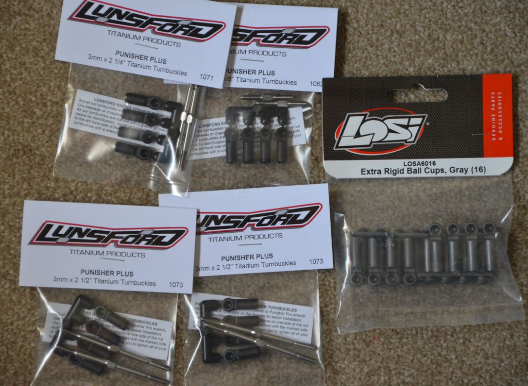

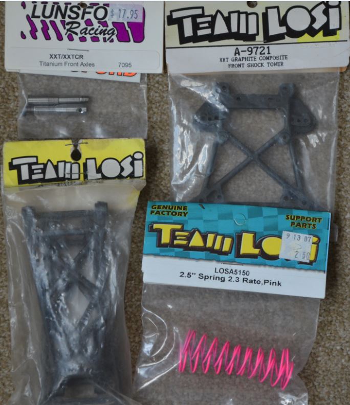

I plan on converting it into a XXT CR Graphite Plus, with some additional aftermarket parts sprinkled here and there. I think the XX series are great looking, and I have been drooling over the photos of members examples on here.

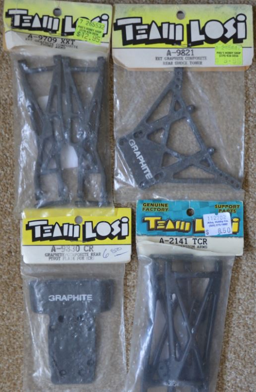

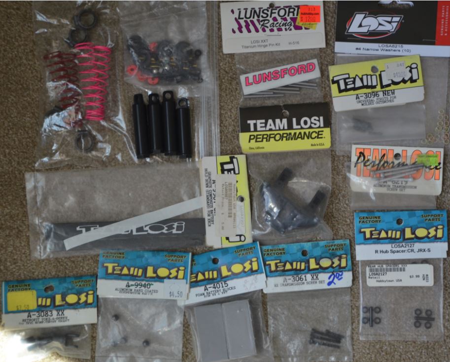

I have been purchasing parts to convert it to a CR Graphite Plus. I am still waiting on some to arrive, and still hunting for others. The truck currently has a new graphite chassis, however I later realized that I will need an XL graphite chassis to make it a true CR.

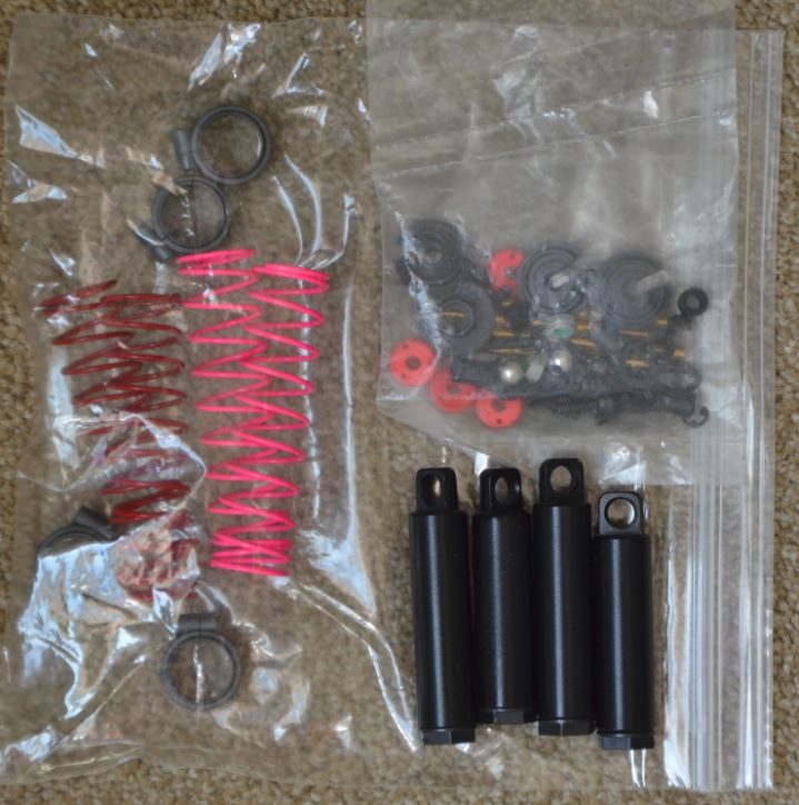

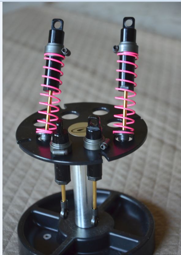

The shocks on the truck look to be in great shape, however I could not resist purchasing a set of 4 brand new, unassembled shocks from eBay.

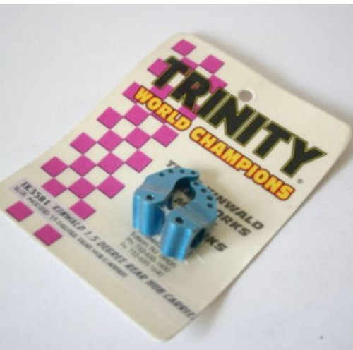

Nice lot of parts there - remember also you need CR rear hubs as the toe-in was moved inboard and removed from the hubs themselves.

Thanks. Would these Trinity hubs work?

Yup! They certainly would, in fact I have a set on my G+. It does mean however that you will have 4.5 degrees of toe-in per side (standard is 3), but for a shelfie it will be fine

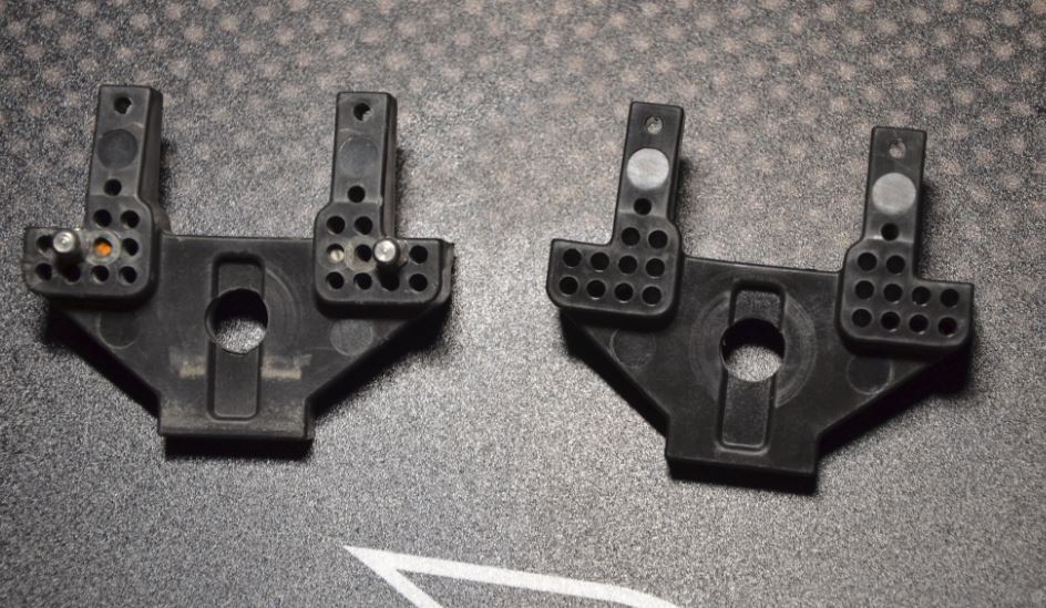

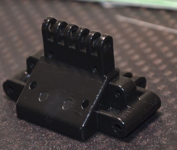

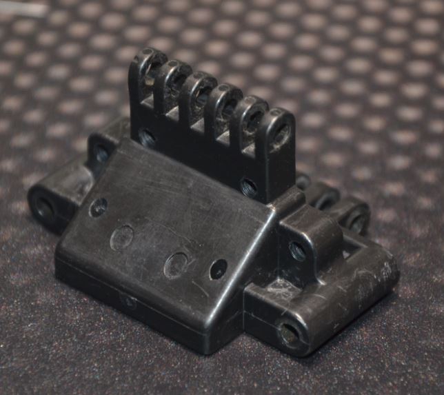

You are also going to need a pivot block. If you go with the XL chassis you will have to drill another set of holes in the bed of that body.
If you sell the shocks that come with the truck, remember they have the TiNi shock shafts which might yield a bit more on resale.

For the pivot block (2 degrees of anti squat) is A-2113.
I have shared the PDF diagram here: https://drive.google.com/file/d/0B3oWkEiFWV2adVZPTzhRaHlVR00/view?usp=sharing

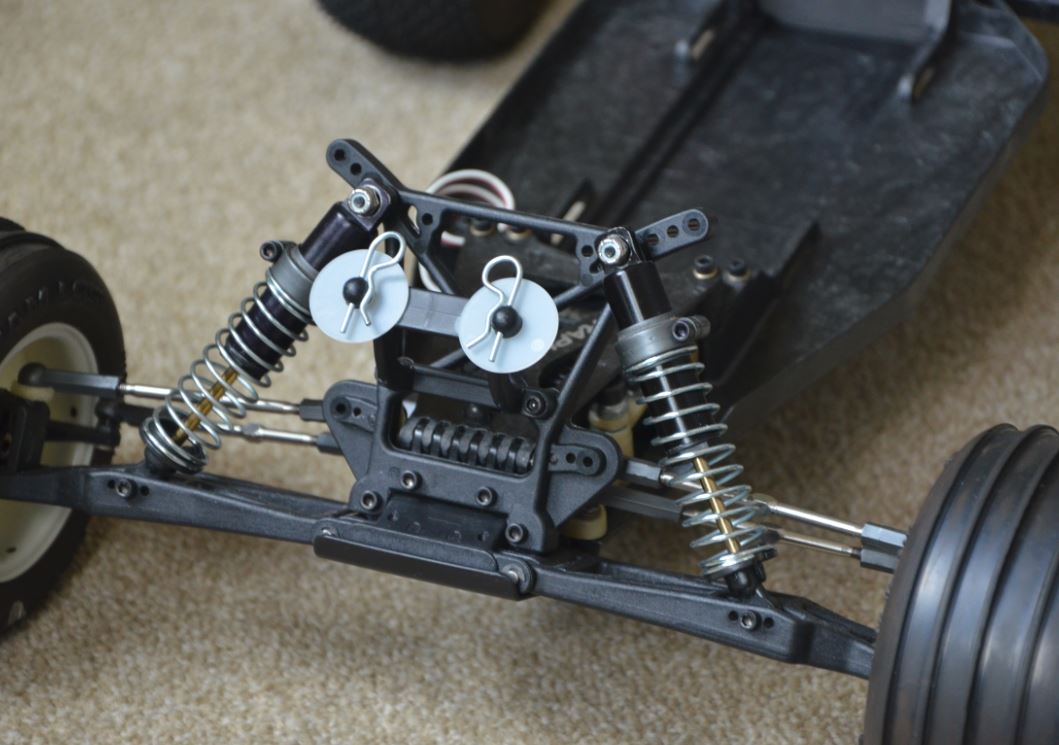

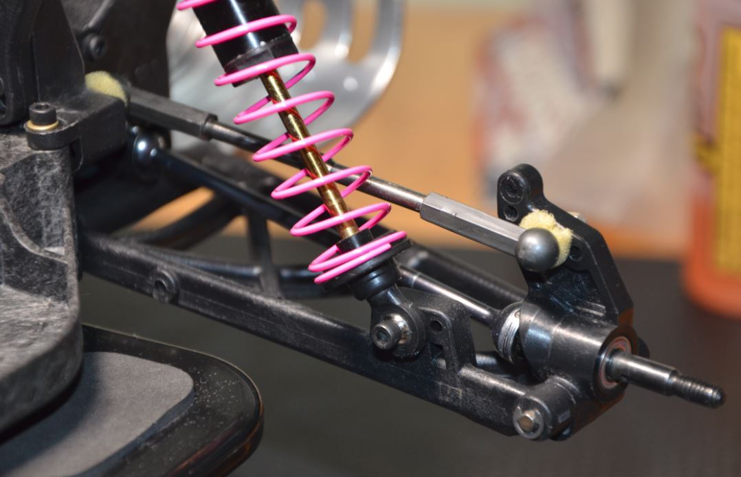

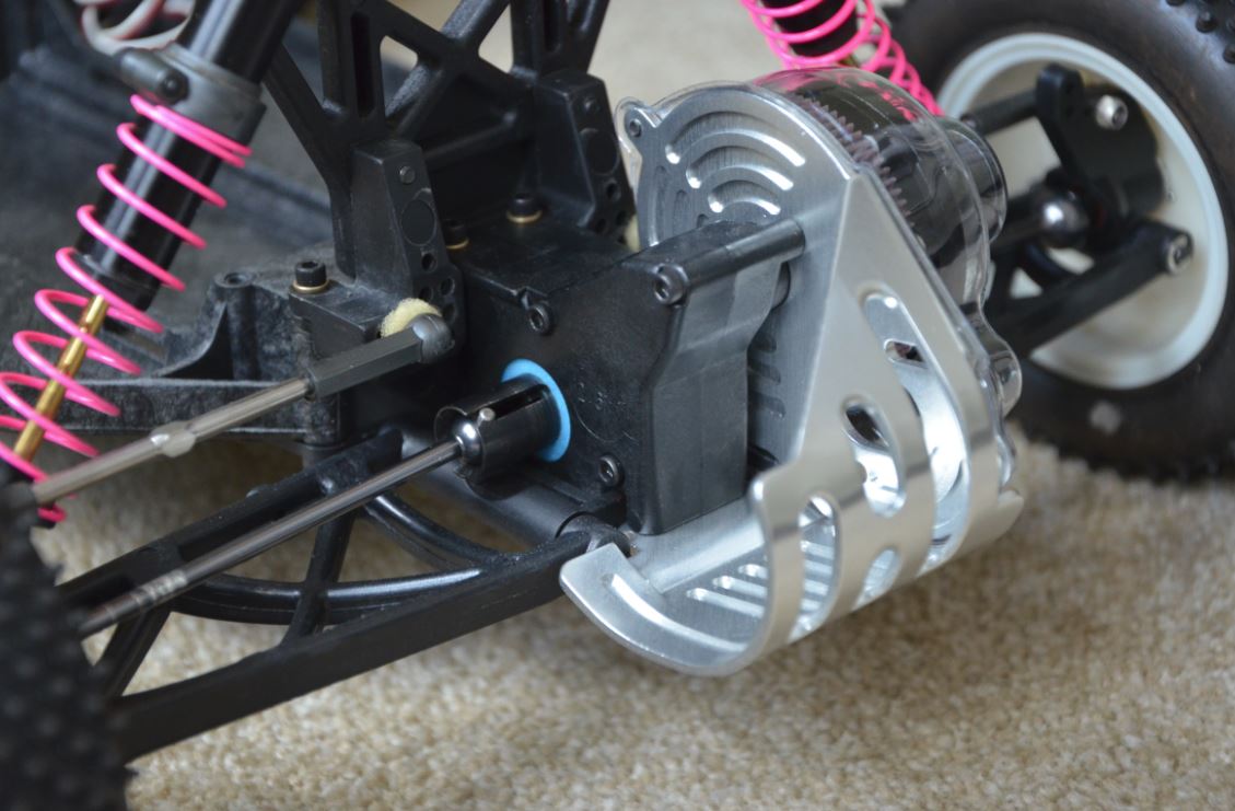

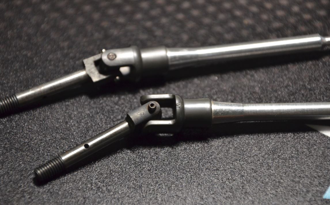

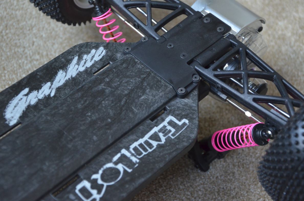

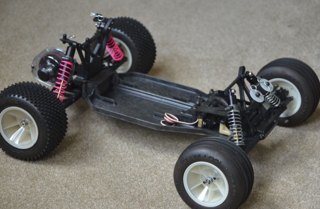

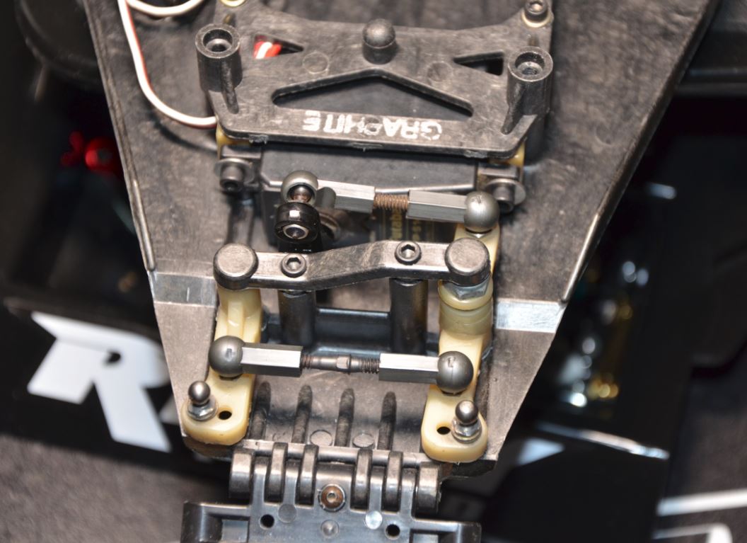

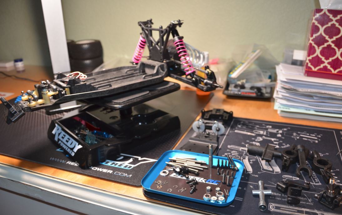

I received the truck, and everything looks great. I know it seems crazy to tear down a truck in such nice condition, but I want to take this build to the next level, the "Jamin Level" of mint, lol. Once done, most everything on the truck will be brand new, with the exception of the front bulkhead, transmission case, some steering linkage. It will also be changed to a CR Graphite ++, as another member coined their build.
Below pictures are pre-teardown. The truck has Lunsford titanium rods, but they are visibly used, and teh ball cup got a little ground down with a dremel. I have new items ordered. I will also be replacing the ball studs with new, shiny bits. The steering linkage is an area that should look much different once completed.
The front bulkhead was a little scuffed up, so I did my best to shine it up.
I hope to find a new XL Graphite chassis.
Re: Losi XXT CR Graphite Plus - Re-Rebuild
Just don't change the wheels.

Damn that looks mighty fine already! Looking forward to seeing the progress here, should be easy with such a great truck to start with!
I do love the white wheels, I tried them on mine but it didn't work with my paint scheme, even though there is white on it.

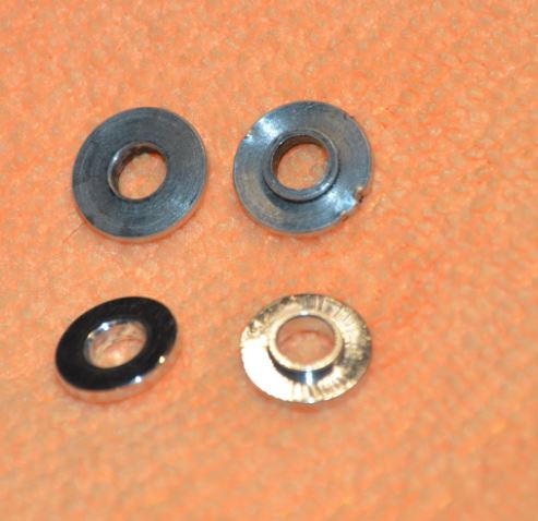

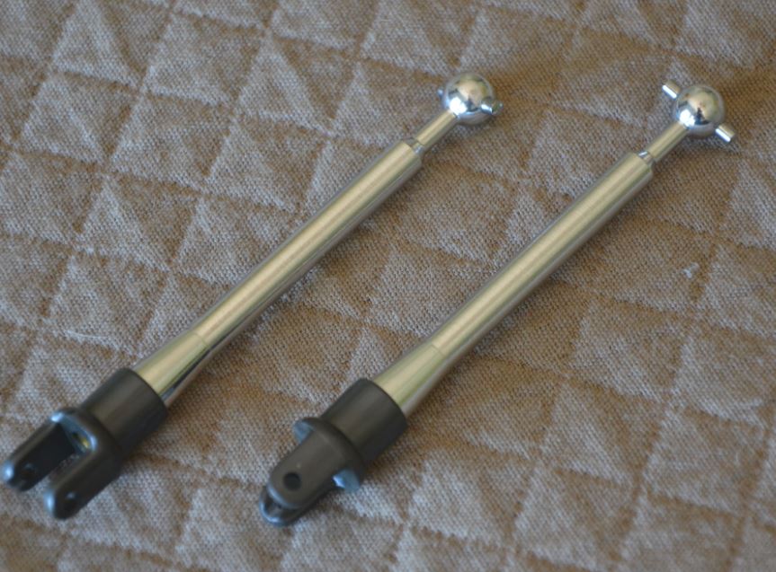

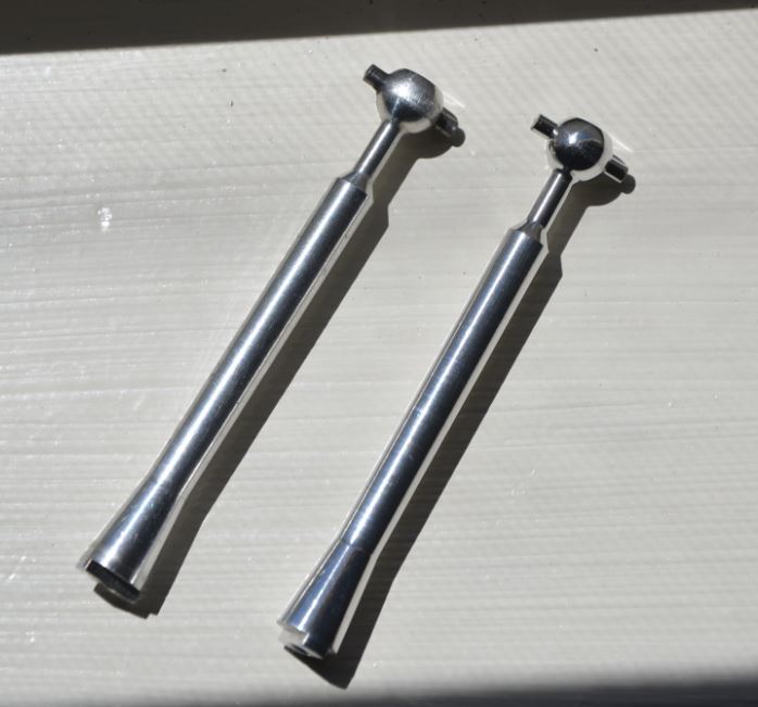

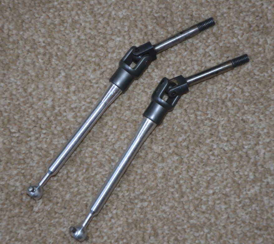

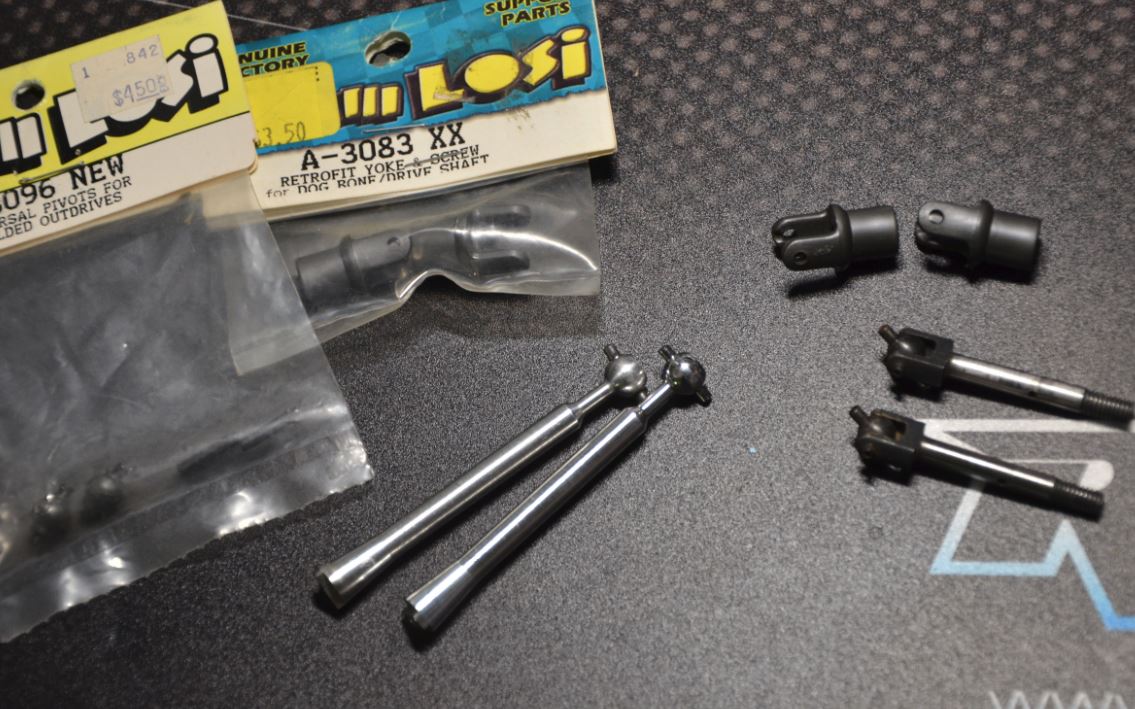

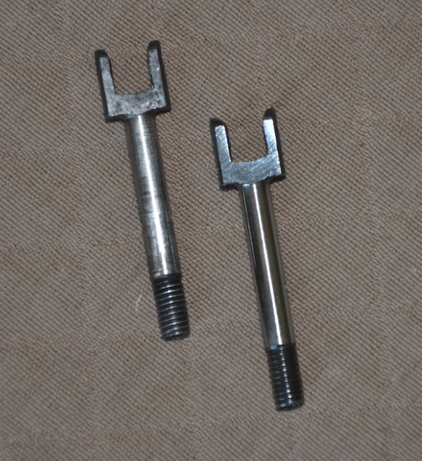

Progress continues. Today I received the main reason for this XXT build - The beautiful A Main Hog Bones drives. I have been obsesses with these ever since seeing them on Shoman24v's XXT.
After much pestering and pleading, we agreed on a deal. These must be extremely rare, as I could not even find a picture of them online, let alone anyone selling them. I hope my build highlights them and does them justice.
The Hog Bones were in great condition, but I decided to give them a little polish. I broke down the driveline, and will be rebuilding it with new parts.
One of the pictures below shows a polished drive next to an unpolished drive. The picture does not do it justice. I person, they shine like crazy now, and I could not be more happy with them. Something about their shape just looks so right to me. They really were the main reason I wanted to build this XXT.
Other photos show cleaned/polished pieces next to originals.

Looks great, shame they lost that original finish! But, they look damn sexy
