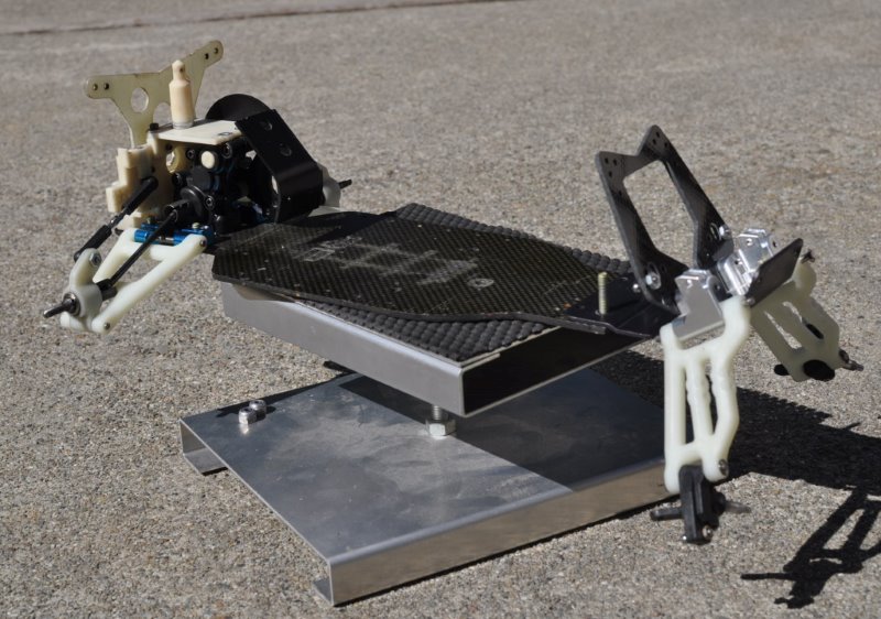

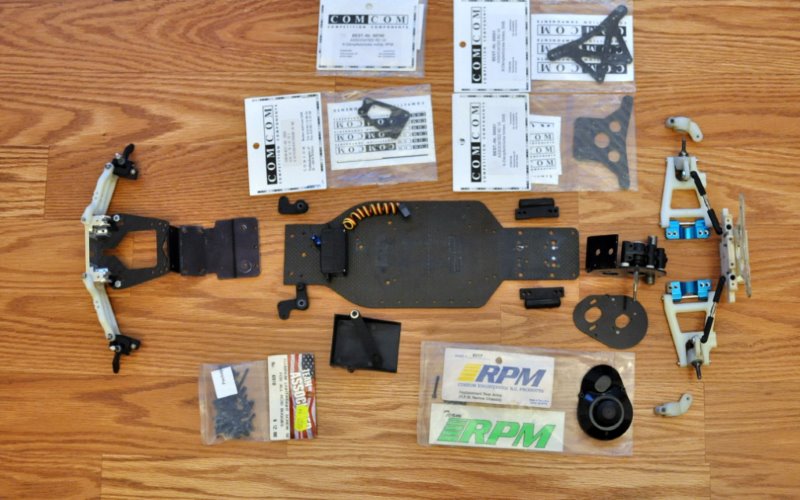

I guess it is time to add some pictures.
This build does not have the narrowed chassis, just the wide arms intended for the narrow chassis, making the car wider. I have another buggy with the narrow chassis, but that one is not converted to mid motor.
My collection is like this:
RC10T
RC10 narrow chassis conversion
RC10 graphite mid motor, wide rpm arms -> the one I am building in this thread
Traxxas Rad2
Traxxas Rad2 mid motor conversion
RC10T
Traxxas Rad2

Re: Building a graphite mid motor WOIN questions Pictures ad
another item you might want to consider is the nose brace tube brackets from the rc10gt, to add support to the aluminum nose.
http://www3.towerhobbies.com/cgi-bin/wti0001p?&I=LXTX50
- yellowdatsun
- Posts: 844
- Location: Phx, AZ
Very similar to my project, except that I used the GT truck transmission, which is effectively a lay down tranny. I also used the wide arms and truck nose plate. I cut my own G10 fiberglass chassis. The car will put down lap times similar to that of my B5M.
With the GT tranny you have some height issues to overcome between the rear bulkhead and the top of the tranny. Nothing difficult though.
I also used GT chassis supports for the nose "tubes", although I cut G10, umm, tubes, for it.
- Posts: 621
- Has thanked: 51 times
- Been thanked: 109 times
The nose brace rods will connect to my signature standing low profile servo mounts. That will be the only way to package a standard size LiPo or 6-cell battery.
I originally "developed" that design to fit 7-cell NIMHs without the hump in my RC10.
The laydown assembly like NIX has designed for the steering servo juuuust barely won't fit with a standard size Lipo.
I have 1 2s2p from MaxAmps, 2 cheap hardcase Lipos and one shorty pack.
I am trying not to make any car shorty only. Even though it would make sense for the shock setup I guess.
