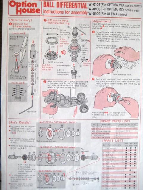

Just picked up a 2nd Turbo Mid and in tearing it down I found it has the Option House Ball Diffs in it. Does anyone have an instruction sheet for these diffs? At the very least, anyone know what size diff balls they used?

Will this help?

That definitely helps! Can't see clearly enough though if there are any sizes on there for the diff and thrust balls. Can anyone make it out?
Thanks for the help!!!!

3mm diff ball you need. 3mm diff ball is also used for Ultima and Lazer (From ZX to ZX-S).
Kyosho's early ball diff system exists 2 kinds for Optima mid and Ultima series, one is no separated diff ring and the other is WBD-3 diff ring is inserted into it.

Thanks a ton!!!! Now I just need a rear ball diff gear and I'll be goldencpebach wrote:3mm diff ball you need. 3mm diff ball is also used for Ultima and Lazer (From ZX to ZX-S).

WBD3 is ball diff pully(Optima mid) and diff gear(Ultima) set
Ceramic diff ball would be ultimate choice.
I also restored Turbo optima mid special and Turbo optima mid SE with ball diff parts.
