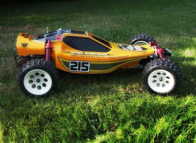

The Javelin: Optima with a flashy orange roll cage body. New shock mounts allows optional Gold shocks.
Optima Mid: belt drive model, midship motor (previously rear overhung) to improve weight balance, duralumin chassis. Le Mans 240ST motor.
Turbo Optima Mid: Optima Mid with full options (stabilizers, ball bearings, 2mm duralumin bronze anodised flatpan chassis, ESC ready)

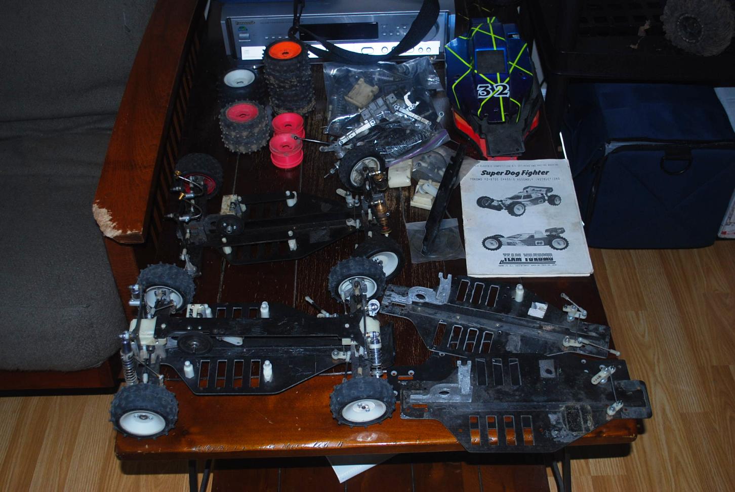

I think I have my hands full now. These are Slotcarods, but I'm going to be restoring them and putting together as many complete yoks as I can. For doing so I get to keep one, but I will or would pay for it.
