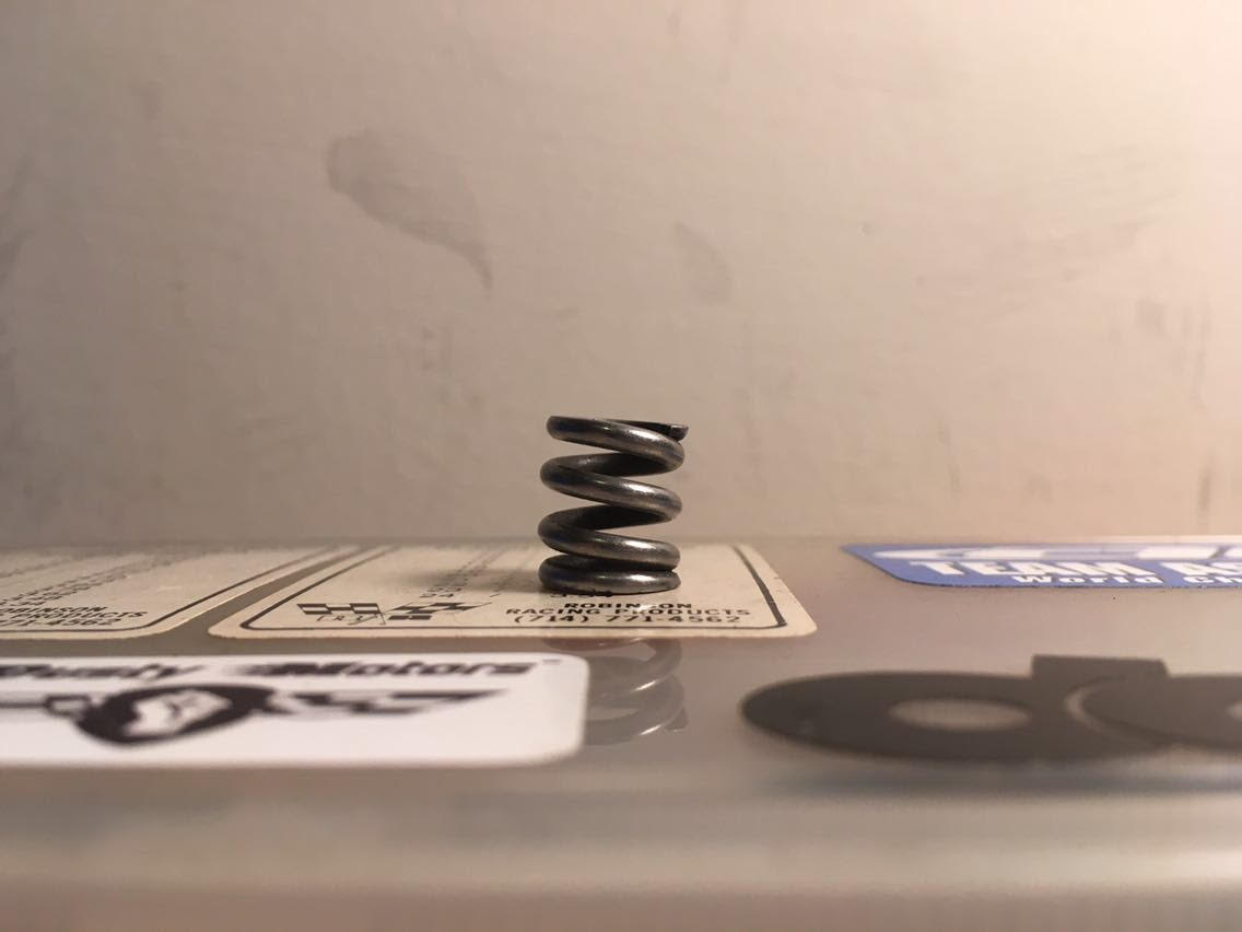

Was rebuilding the trans in my B2 yesterday and remembered reading this thread. I too had a slight wobble in my spur gear (updated top with the B4). I never had an issue running it with the wobble, but it was bothering me. After checking everything a million times, I noticed the spring was not square. This was causing uneven pressure on the slipper assembly and the wobble. I replaced the spring with a new one, that is square, and the wobble went away. You can see in the picture how the spring leans to the right, ever so slightly.
