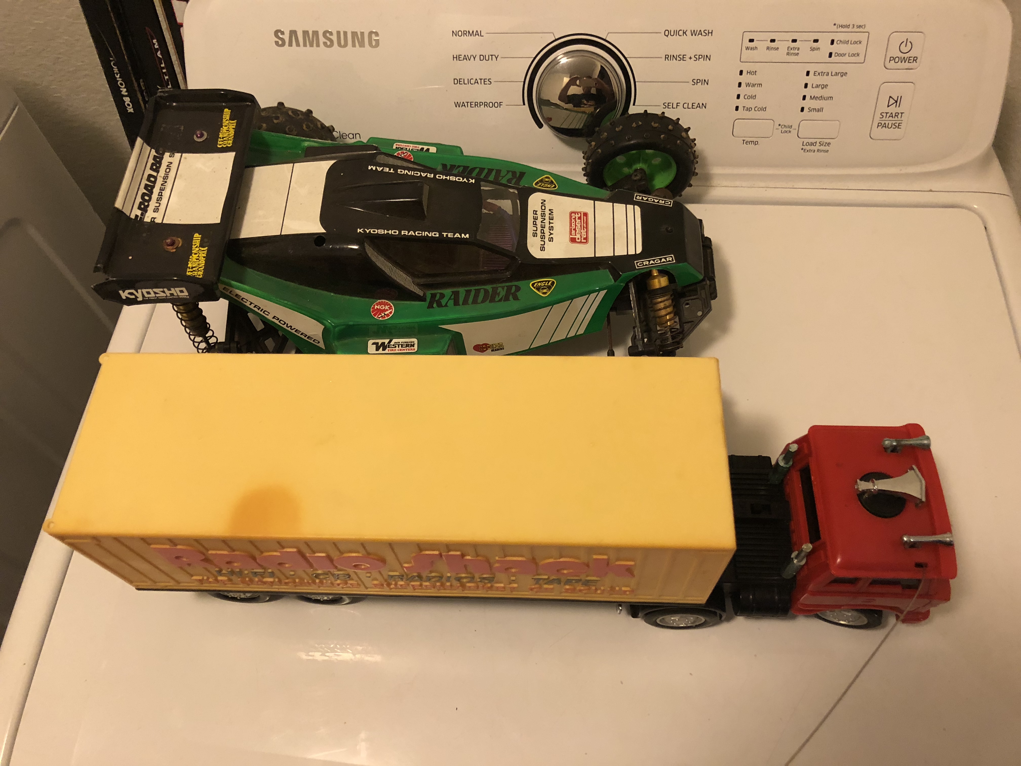

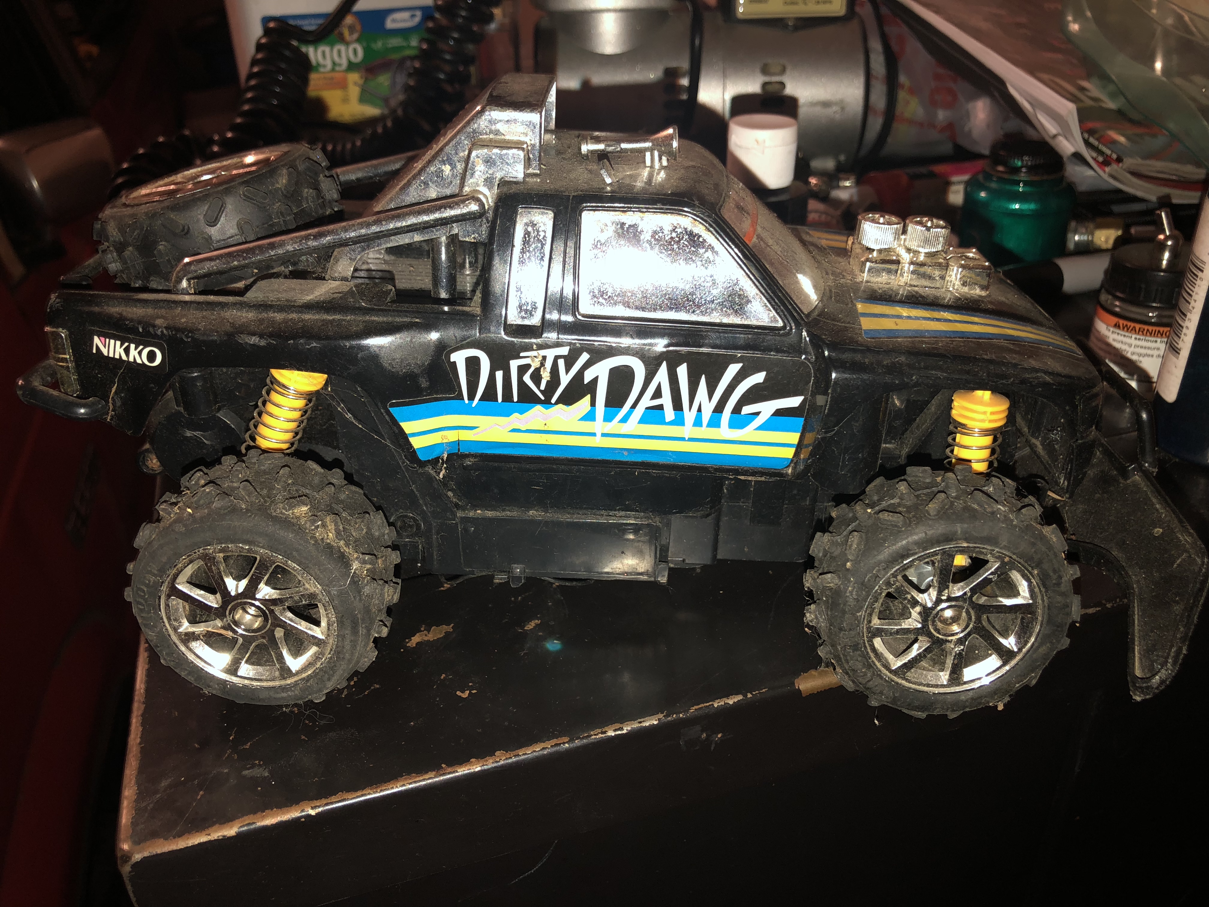

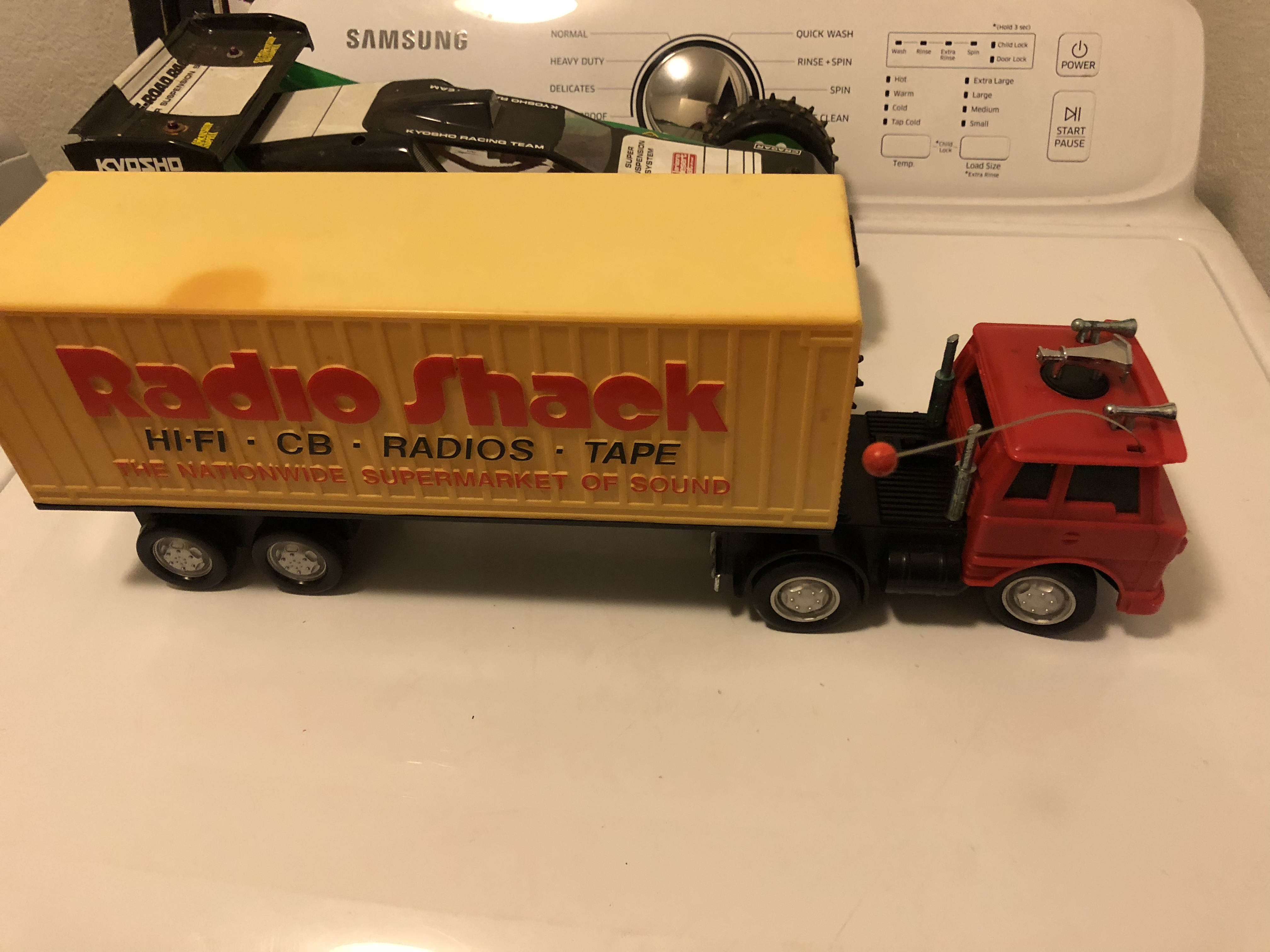

I know some of you guys have converted old Nikko or radio shack Rc cars to hobby grade electronics. What did you use to do so?
I have these that I would love to make run again.
Any tips would be greatly appreciated.
