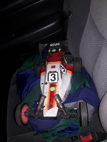

Never thought that top deck was nothing else than fiberglass, carbon fiber or something similar, but You are right, it is plastic too.
Are the nuts pressed into front (aluminium?) shock tower for upper front suspension link internal mounting ball stud? They somehow seems to be in same level with shocktower surface. Also the unused (more internal and external) holes seems to be way too large for 4-40 ball stud.

I asked Gil for a few details about these pictures. Here's his response.
"We tested Kydex plates. We raced with carbon. We had 20,25,30 degree plates. Most of the team raced 30.
Yes we use threaded inserts on the tower. Nuts would have hit the shocks."- Gil

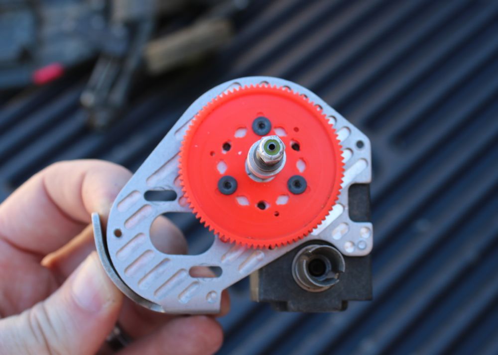

Ok, this has inspired me to get on it now. Do some small updates at a time instead of one big one. Here is a tease until I get some done.
- Jirka

Is that prototype LRM slipper? Do You have pics from that shady car at top left corner of that picture? I can't wait Your pictures

Yes and yes.
