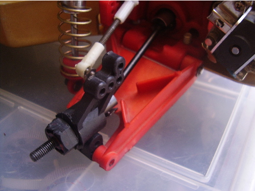

I was wondering what the best way to convert to a hex style hub would be. I came up with this. It's a hub off of an HPI super nitro. The only thing is that you have to bore out the hinge pin hole to accept the associated hinge pins. It even takes the stock RC10 dogbone perfectly, though I used the HPI one in the pic. Please feel free to suggest any better ways to do this conversion.

easiest way would be to get the hpi super star rear wheel adapter kit. it comes with the proper adapter to use on the rc10 1/4" axles.

That would be much easier. Thanks scr8p

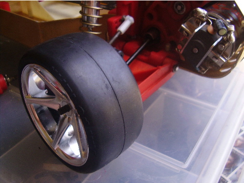

HPI adaptors and OFNA CRT .5 2.2 rear rims, makes the rear end the same width as todays cars (eyeball measureing against my RB5 this past racing weekend.)
Touring car wheels should work with no issues either. Check your backspacing and axle hole sizing though.

Here is what they look like installed with Panther Puma tires....
