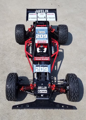

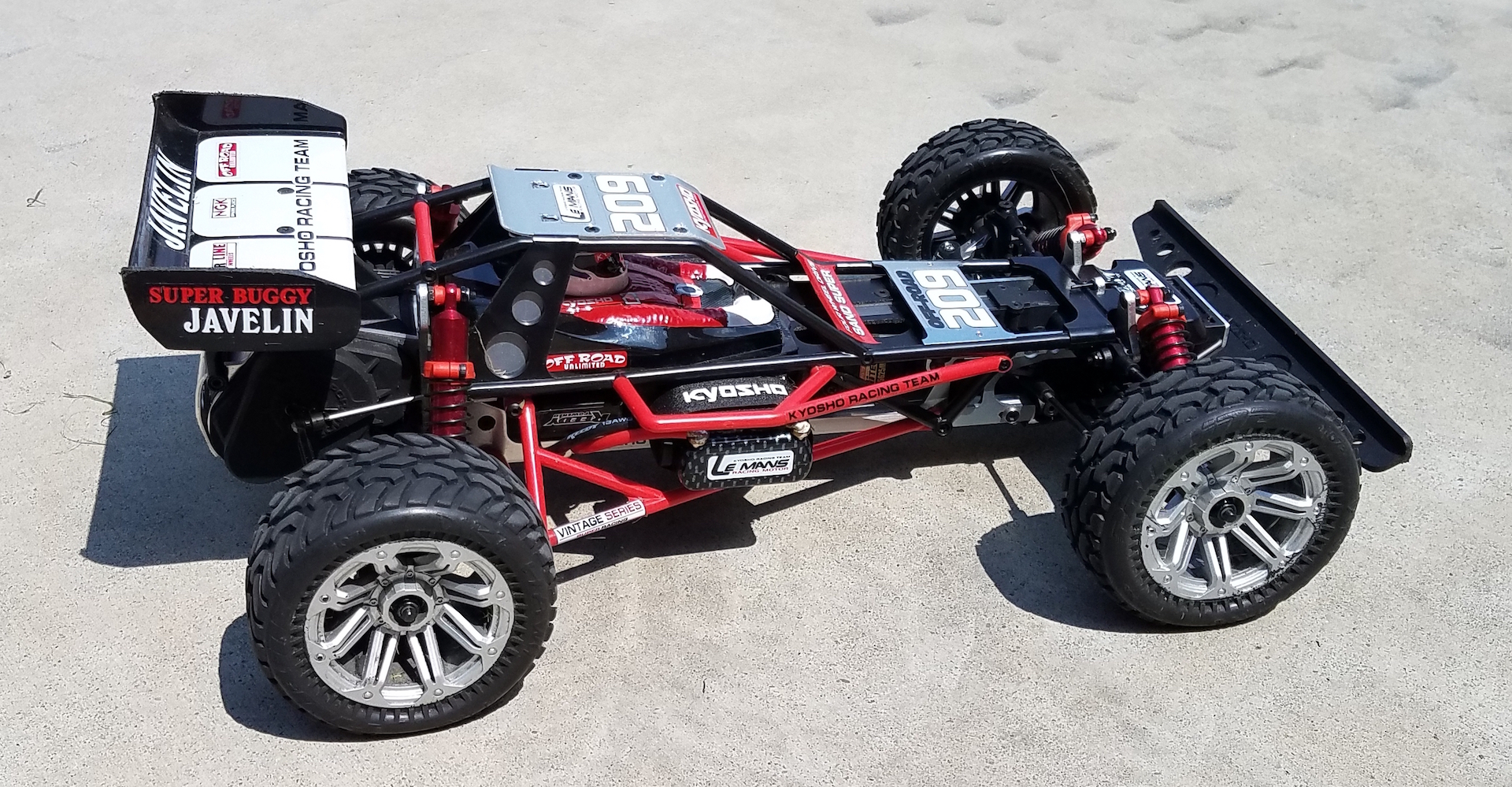

After the red Javelin body came in from Japan, I mixed it with the black body and this is what I came up with:
I like the red, black & silver together.
Adam
XLR8
Posts: 3307
Has thanked: 1659 times
Been thanked: 1170 times
Re: A tale of two Javelins...
Post by XLR8 »
I agree, it looks fantastic. Very unique.

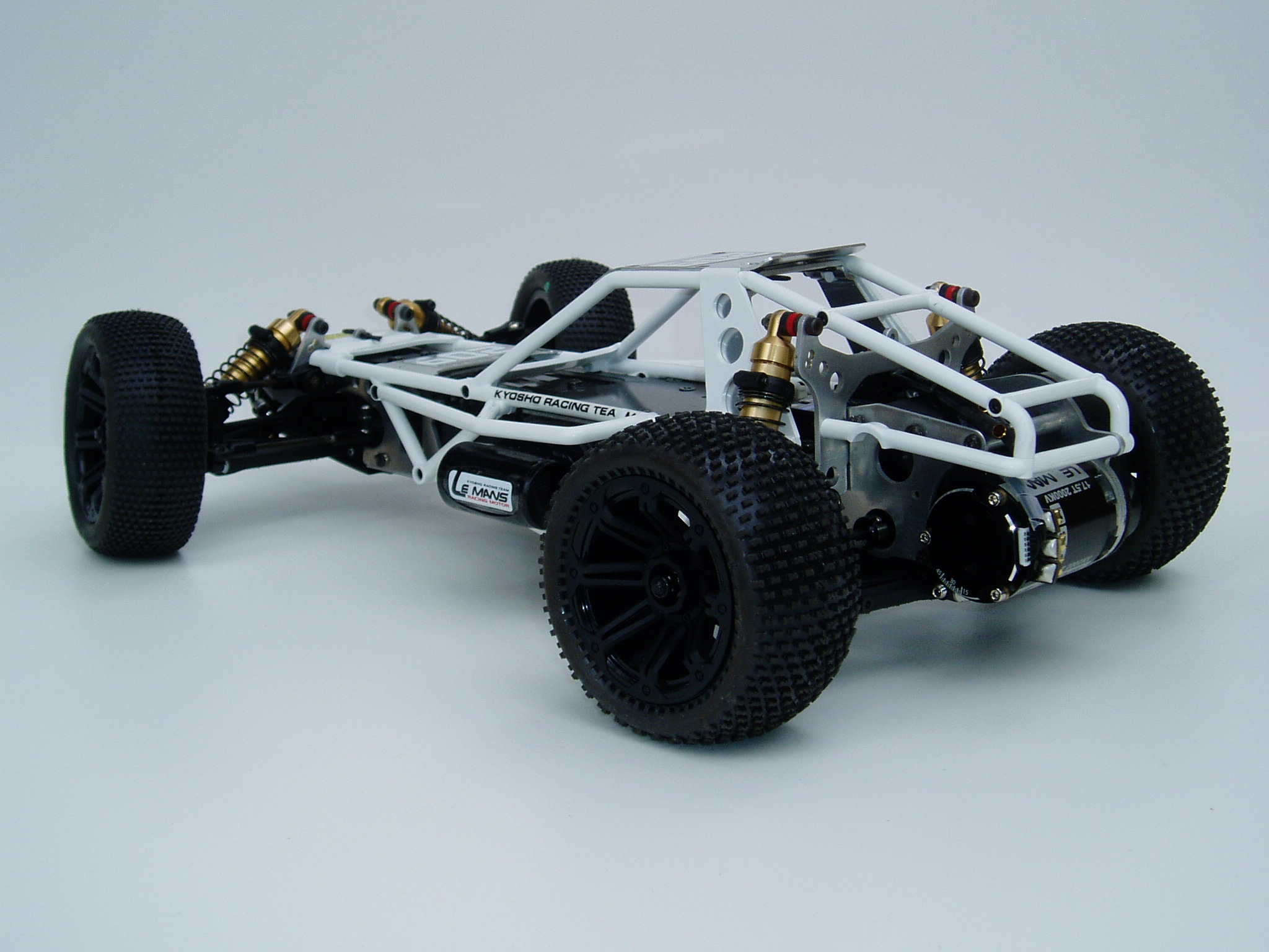

Here's a re-re cage I got from Kyosho mounted on a vintage Turbo Optima. I had to borrow the aluminum "roll bar" from my re-re Javelin shelfer as the kit doesn't include this item. There's no provision for wing mount so you'll need to order the re-re wing mount separately as well. My re-re cage also didn't come with a wing either. I don't recall any problems bolting it on the vintage car; all hardware needed to attach it was included. The decal set is included. You'll drop a c-note to get everything to complete the retrofit. Hope this helps. :D
