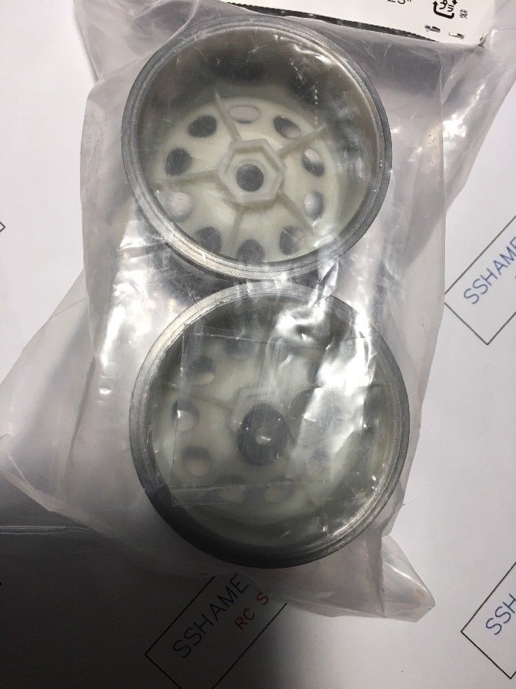

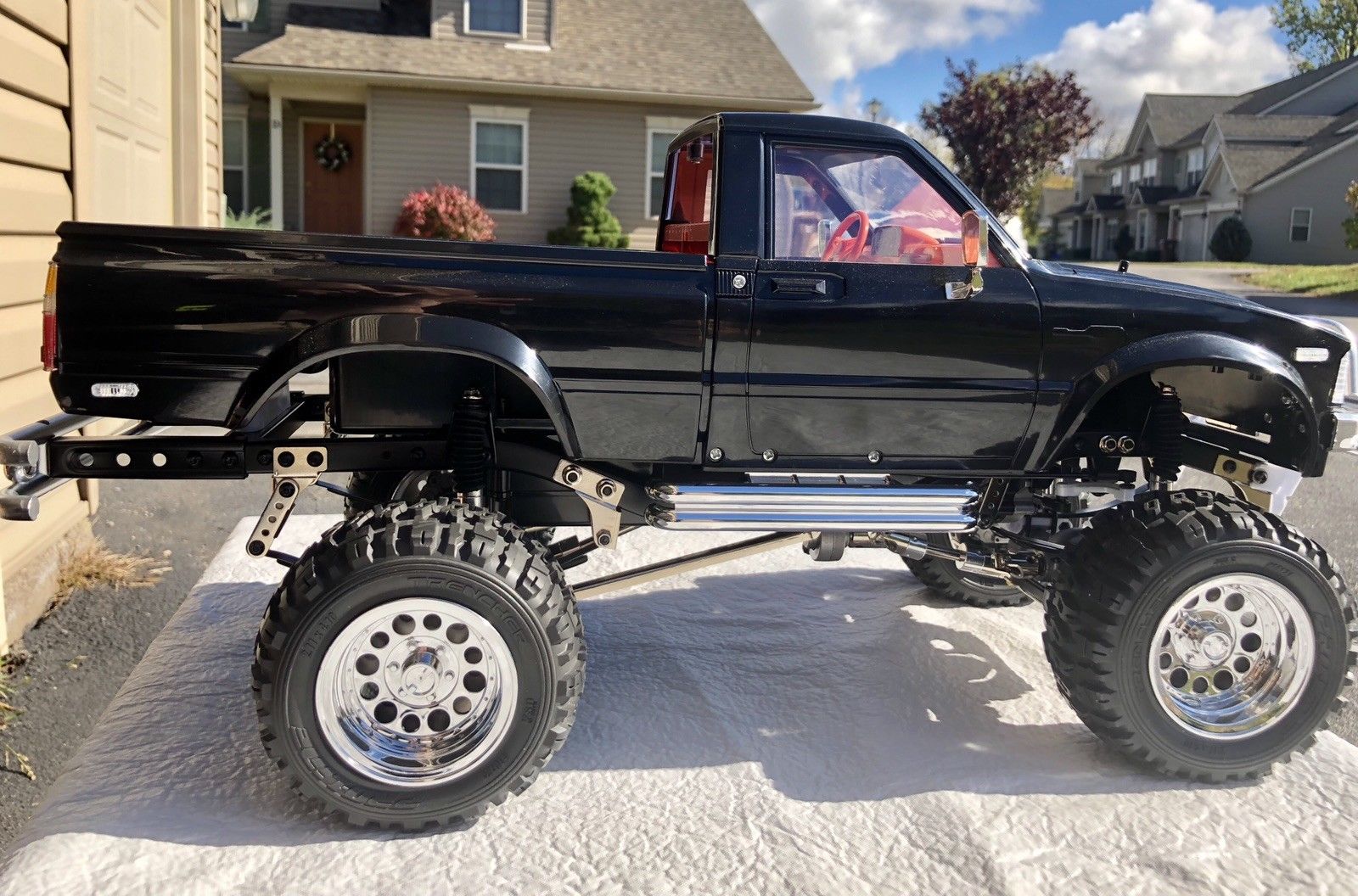

By chance does anyone know if it's possible to adapt Bruiser wheels (the re-re ones shown in the photo below) to the 12mm hex drives on a RC4WD Trail Finder 2? After seeing this truck posted on ebay, I really want to lift my TF2 and install this wheel/tire combo. Also, if you happen to have a Bruiser (or Mountaineer), could you please measure the track width (i.e. the distance between the center mold parting lines in the tires)? Front and rear please - I think they are different.

is this being sold as a rere bruiser? Because it loooks like an HG-P407 to me. I've seen the adapters to install 12mm hex wheels on a bruiser but not the other way around. If you look at the cost of those adapters, it might be better to find some 12mm hex mount wheels that are similar.

Bruisers do have a wider rear track than front. I dont have the exact dimensions handy though. I also have not seem adaptors to mount bruiser wheel adaptors, but you might be able to get a bruiser hub to fit onto a TF2 axle with some luck and/or modification

It was definitely described as an HG-P407 not a Bruiser(it's sold btw).
Yeah, the Bruiser wheels are cheap (~$12 for all four) but the adapters needed to make them fit 12mm hex could be expensive - if such a thing even exists.
I like the Bruiser wheels (I'm an old dinosaur who still likes chrome plated parts on my vehicles :D ). There are plenty of 2.2" 12mm hex metal wheels that look nice as well. I'm just not interested in spending $100 or more for them.
If I'll need to make adapters, I'm considering using the stock Tamiya hub ($9/set on ebay) and replacing the large bearing with a machined aluminum plug drilled to fit the axle and with a cross-pin slot. I could either epoxy the plug into the hub or I think there is enough space behind the wheel flange to pin or grub screw the plug in place.

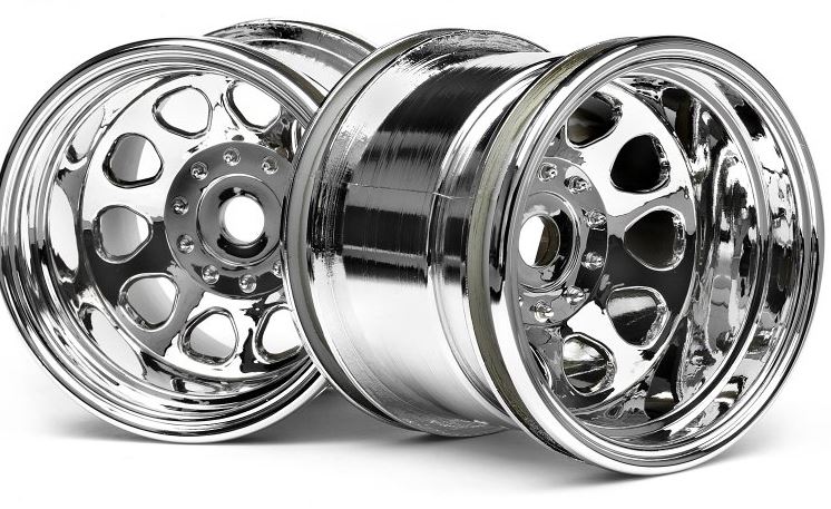

I've also found these from HPI. They're a little more expensive than the Revolvers ($17 vs. $9 per pair) but the quality of chrome plating appears to be a little better.
Same dimensions as Revolvers (2.2 x 2"). I've asked HPI to provide offset (or backspacing) so I can compare. I like the retro styling and subtle scale details.
https://www.hpiracing.com/en/part/3062

I agree, revolvers are cool, but those hpi's are even nicer. :mrgreen:

Basher67 wrote: Tue Oct 30, 2018 11:41 am I agree, revolvers are cool, but those hpi's are even nicer. :mrgreen:
I agree!
Back side is really ugly but maybe some paint or faux brake rotors to hide the bare plastic. They certainly look nice on the front side and that's what matters most.
I'm really leaning toward ordering a set. :D
