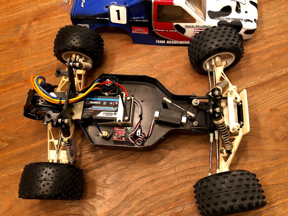

Need some advice.. started to fit the body and had to remove the front bumper to fit the jconcepts body up to the imprinted holes. The rear align great but the front don’t match up at all. The holes are In a good spot but the body does not sit low enough to pin it in place even with pressure
Question is does the body in most cases just slip on and off or do you need to “make” it fit? I’ve disasembled the front end thinking the nose may be bent but it’s difficult to tell. The front tower doesn’t have a stress marks from a collision. So at a loss there. I’d pick up a new 10t nose but y’all know about scarcity and price on those things.
Any thoughts?

And i found this.. can't say i'm that surprised, but that's one helluva hit.
blk05wrx
Posts: 44
Joined: Mon Mar 06, 2017 4:06 pm
Location: Arlington Heights, IL
Re: Another RC10T restore.
Post by blk05wrx »
Well that explains why the body didn't line up. :lol:
