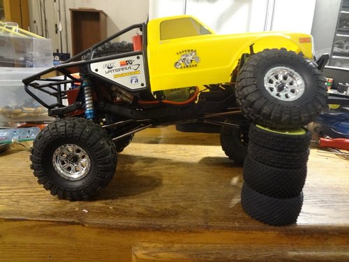

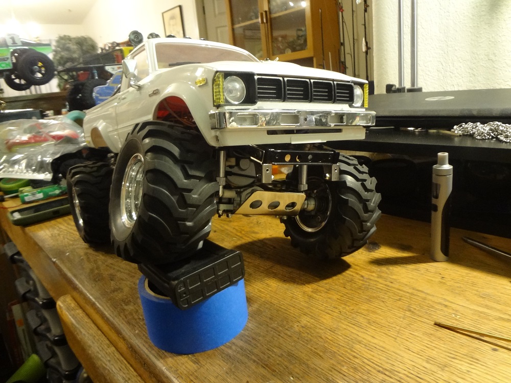

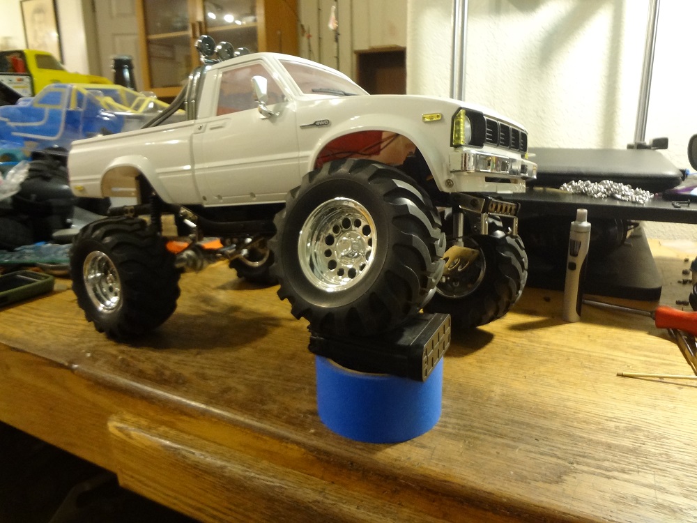

That front end width looks a lot better. I tore my truck down today to make some changes and to check the trans. Trans looked perfect inside...well oiled bearings and a light coating of red grease on the gears. I removed all but the main leafs in the rear springs and removed the middle leaf in the fronts. I went through the shocks thoroughly,and after seating the c-clips properly and v-grooving the pistons, I added some 20wt oil and reinstalled with the shock shaft spring in place all around. Still not a plush ride, but a ton better than what it was. I was thinking maybe it was the shock lengths that were holding back the articulation, but it's the leaf springs. Still, I was able to get it working a little.

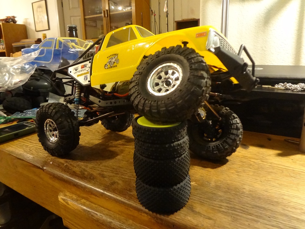

I agree. Also, when I had the truck apart, I noticed the it has an adjustable motor plate. I'm so used to my other Tamiyas (clod,frog, blackfoot, hornet,etc) have fixed motor plates, that it never occurred to me that I could change the pinion gear size. Hmmmm, articulation and lower gearing? Maybe it does have a little crawling dna after all.
I just watched a video of some TF2's on a trail and was surprised to see how little they articulated and how capable they still were. I guess they don't have to twist like my King shocked Ascender here to get the job done

From a little youtube investigation I found that articulation can be improved by tapering the ends of the leaf springs where they make a loop for the shackle bolts . I've not tried it yet but probably will ,its supposed to allow the end of the spring to twist left and right a bit in the shackle .
I've been meaning to have a look and see what pinions I have to try and lower the ratio , was also thinking of trying a 50 turn motor .
The articulation you have on that ascender is insane !

As far as tapering the ends of the springs, it does work, but there are other easier and cheaper methods to gain the same thing. First, take a close look at the spring mount and both ends of the shackle mount. The spacer/bushing in mine were just a hair short which allows the spring hanger or shackle to close a little when tightened down. By simply loosening these back up just a hair, the suspension is smoother and has more flex. As long as the nylock nuts are fresh and still gripping strong, thats all you have to do. Another mod I'm considering, is to replace the aluminum spring eye bushings with a rubber one.
