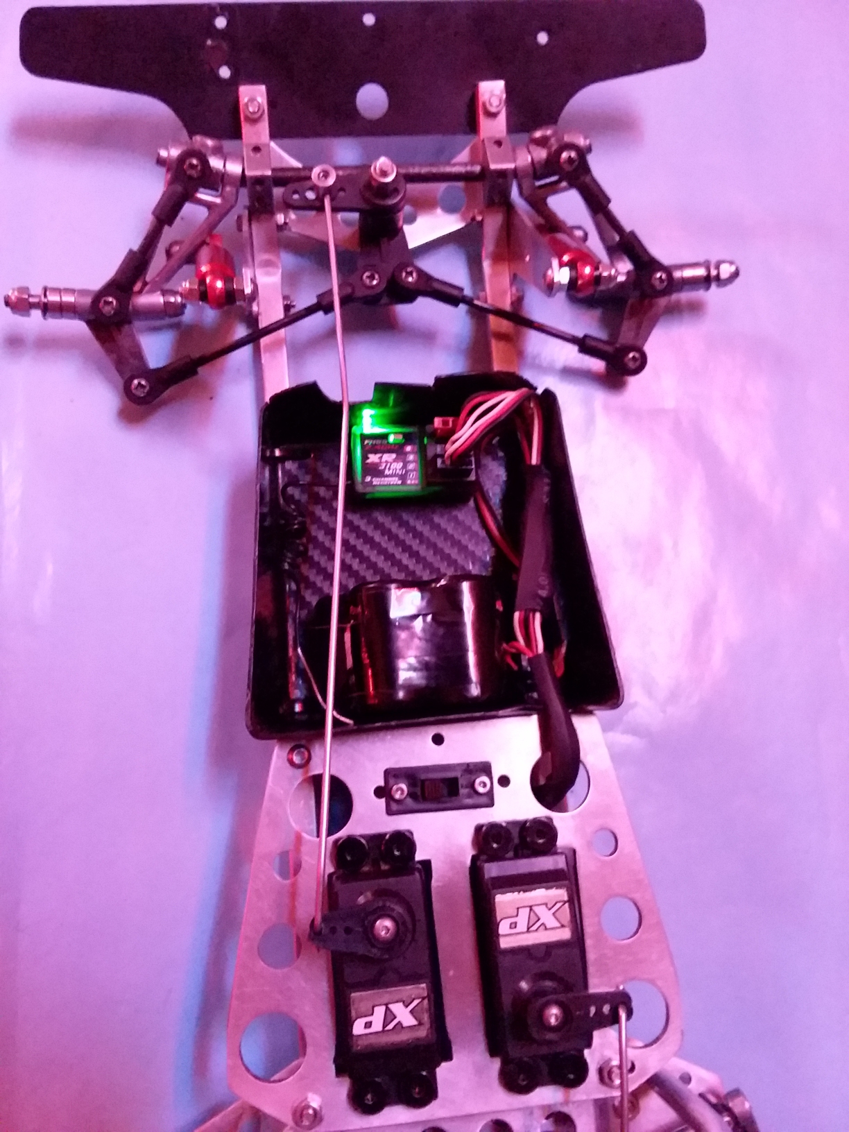

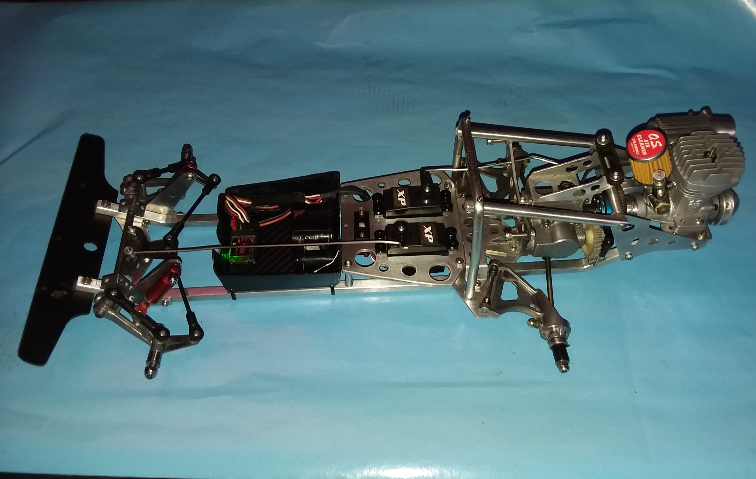

Looking better all the time. Lots of skilled fabrication skills you have displayed.

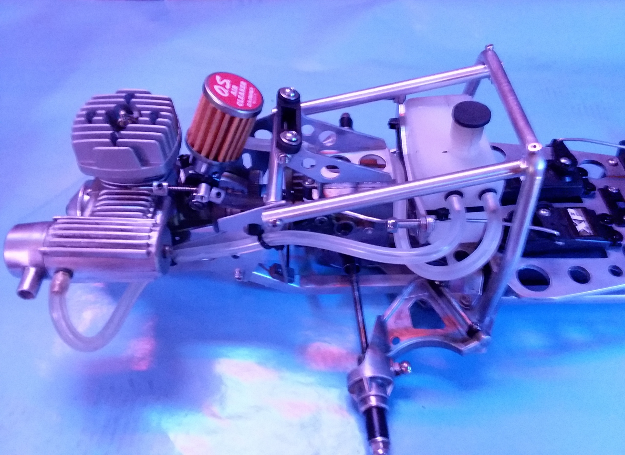

I don't know anything about these cars. Why did they put the engine so far off the rear end? What is the yellow wire that runs to the front bumper? Thanks.

Re: Kyosho Assault Box Art Restoration
Not real sure on the engine. I think it because they modified a Cox Scorpion for a nitro engine. The yellow wire is for the glow starter, i dont have it for the basket case car. It was gone when i got it. U put a "C" battery on the front bumber in between the springs, It fired up the glow plug via that yellow wire, kinda a cool.

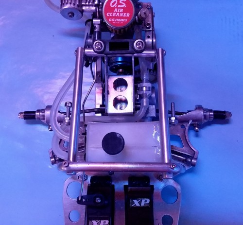

Went with a custom fuel tank. This basket case didnt come with a tank. My Nitro Brute tank had to be cut open and repaired...and i am running a rc10gt tank in that truck now, so i decided to fit the modded Nitro Brute tank in here, hopefully it doesnt leak cause it fits great

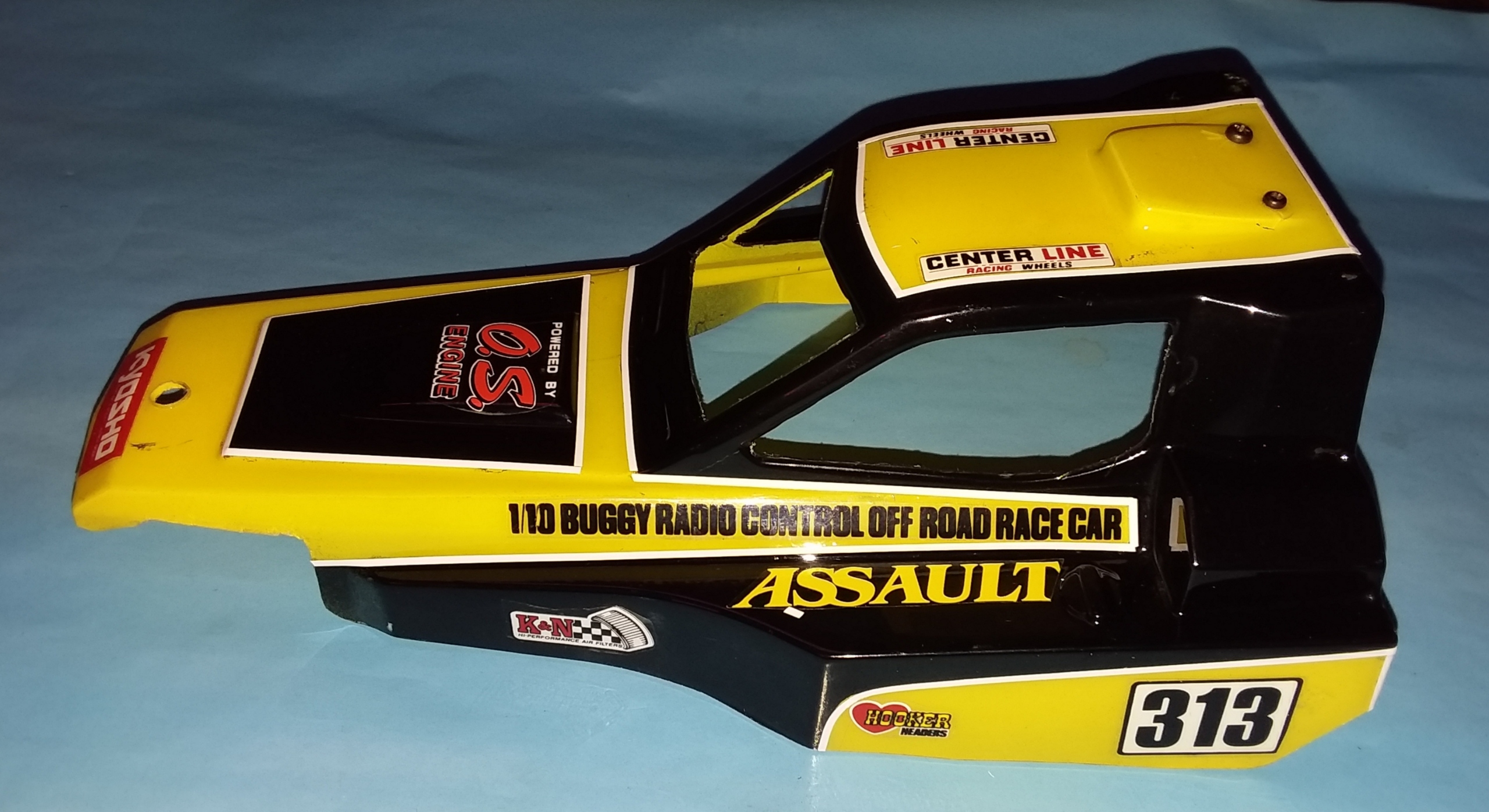

The body on the "mint" car wasnt mint. Bad tape lines, some cracks, and poorly cut out. I pin striped the white, fixed the cracks, dremeled all the edges. Turned out real decent. I have a new body i will paint w/new decals, i will probably put on the mint car if it turns out good, so this 30ish year old body will go on the basket case

The basket case one with the bent chassis.... wow... what else can I say... how hard have people hit boards with this car to bent it this much is beyond me
The reason why the assault has the engine at the very back like this is historical. Bitd, the first IC offroaders were using cone starter engine from RC planes. The only way to start them was to position them that way. A lot of the early offroaders, especially japanese designs had that "feature", Hirobo were doing it that way too. Also, tire technology was very basic, and the cars needed all the weight they could get on the rear tires. As a result, the cars would pretty much only go straight and then swap ends as soon as you'd lift the throttle, but, hey, this was good fun anyway
Where Kyosho had it kinda wrong is that, in the mid-80's, this was already a long-abandoned technology... then again there weren't that many 1:10 IC buggies, so they probably couldn't redesign a car from the ground up for low volumes, hence the scorpion architecture, which was rear-engined anyway. And who cared how (poorly) it ran, it was just to goof around as there was no 1:10 IC racing anyway
Can you please explain how you "repaired" the cracks in the not-so-mint body?
Thanks for the comments and info. As for the cracks, I took Hudy battery strapping tape and put it over the crack on the out side of the body. Then on the inside i used C6000 clear (like shoe goo but better) and spread it over the cracks. Once its dry u peel off the tape and can barely see the crack. The wing was much worse than the body. It fixed it good too, especially around the mounting holes which had gotten large over the years. Now i just had to re drill the mounting holes, pretty easy repairs....the radio box was severly cracked, fixed it like that too, then put cut to fit carbon fiber covering in the bottom of it.

Thank you - can you please help a non-american member and explain what C6000 Clear is, and if possible post a link to this? I need a cubic meter (proving I'm not local to this forumcoxbros1 wrote: ↑Fri Mar 08, 2019 8:23 am Thanks for the comments and info. As for the cracks, I took Hudy battery strapping tape and put it over the crack on the out side of the body. Then on the inside i used C6000 clear (like shoe goo but better) and spread it over the cracks. Once its dry u peel off the tape and can barely see the crack. The wing was much worse than the body. It fixed it good too, especially around the mounting holes which had gotten large over the years. Now i just had to re drill the mounting holes, pretty easy repairs....the radio box was severly cracked, fixed it like that too, then put cut to fit carbon fiber covering in the bottom of it.
