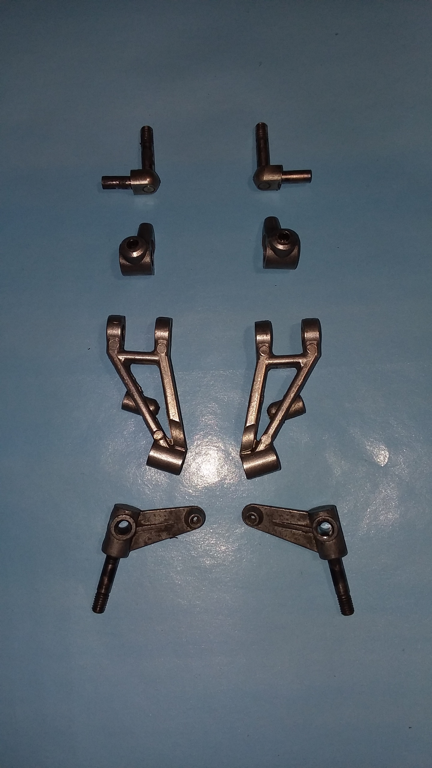

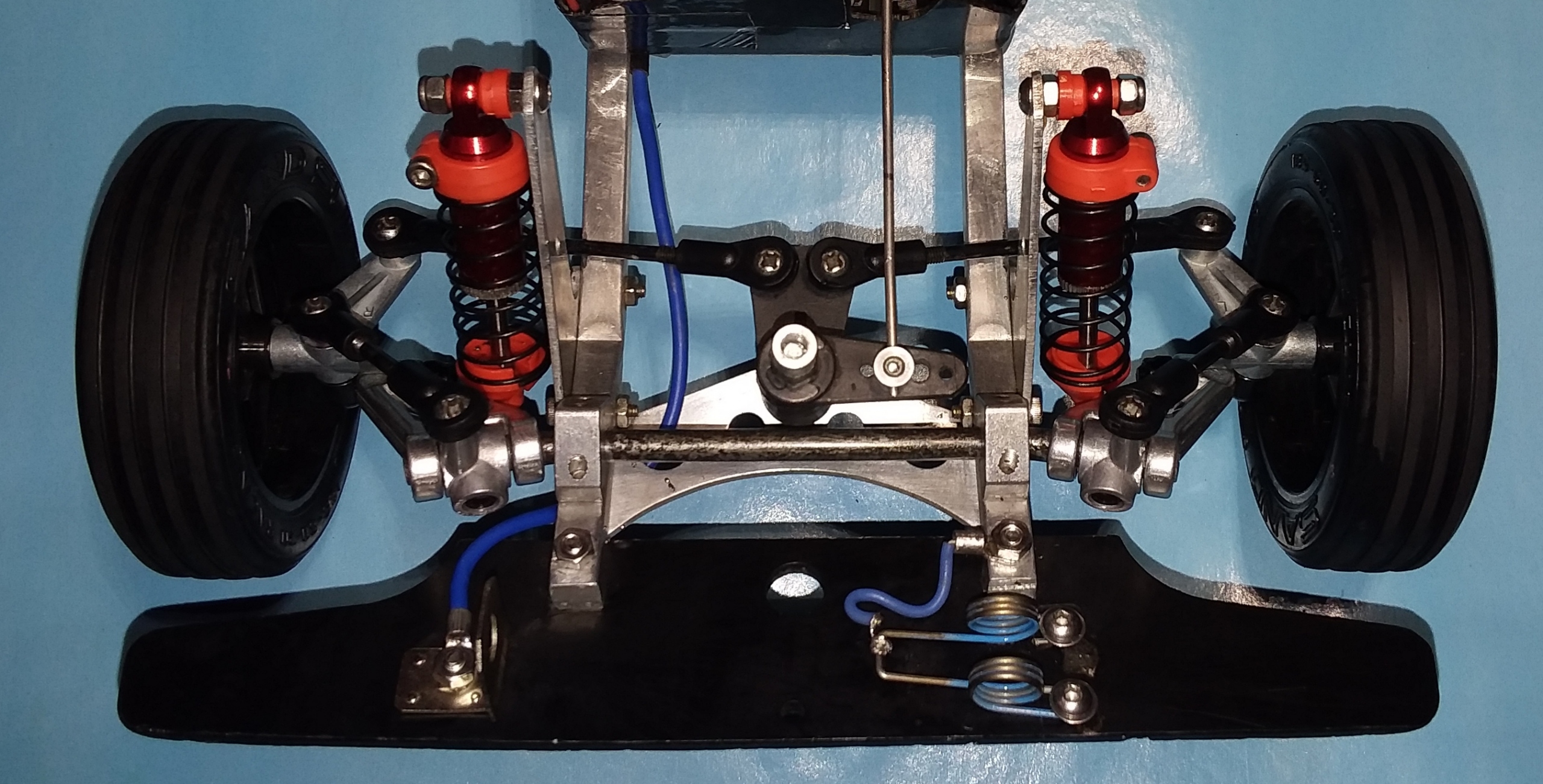

Changed out these wore our front end components, worn parts had the camber all screwed up, plus they were ugly
Thanks to rerelease cars these old parts can be bought

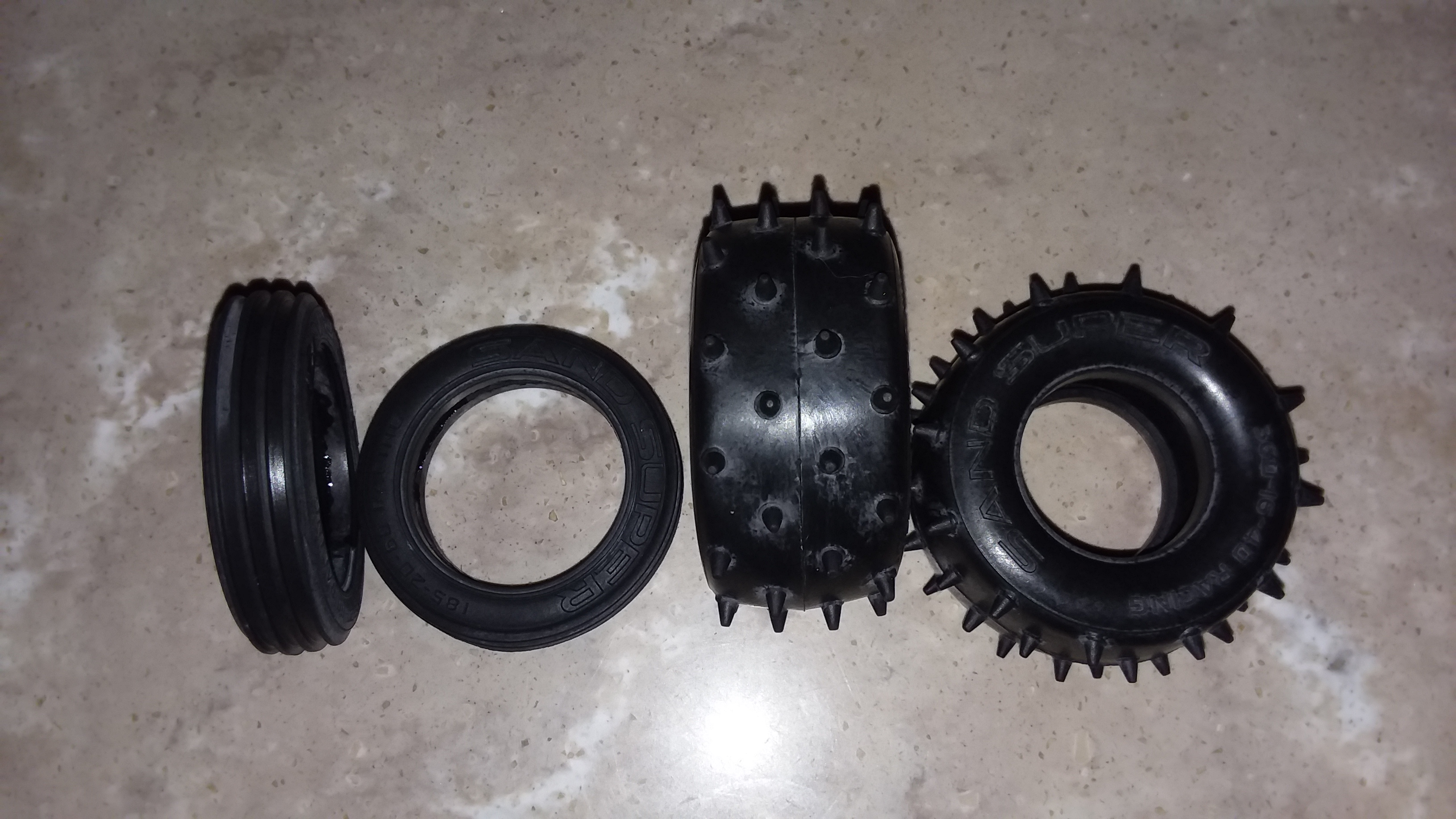

Tires from Marwan came in today, look exactly like originals on the other car. These are goin on the basket case with rere yellow beetle wheels for display. Prolly wont run on them

I wonder how the re-release knobby tyres would work?

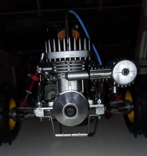

Pretty quiet around here.....ran the basket case the last two Sundays for about 45min each time, perfwct reiability but wheelies would scuff my starter cone, making me miserable, so i fabbed up this basic wheelie bar out if .055 wire and two aluminum sleeves for rollers. It still allows the front to come up but not rub the cone. I massaged all the scratches out of the cone.

That would spoil the fun. My starter cone is all carved up too, but from trying to get more than it was worth out of the rubber insert in the starter.

just tested it, worked perfect. Grabbed some power wheelies on concrete and gravel, no scratches!
